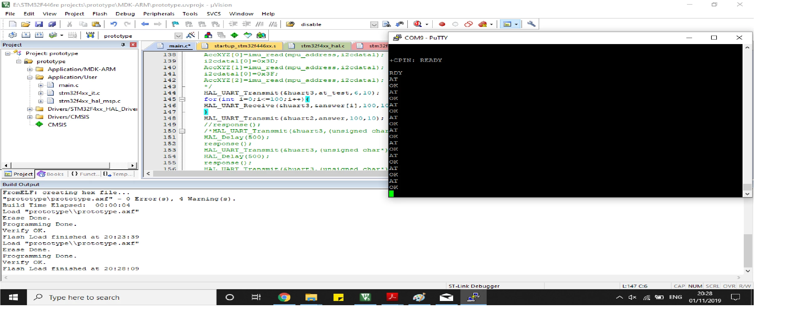

I am trying to interface a GSM sim7600 module with the STM32F446RE, but i am not getting the response on the UART.
  • November 1, 2019
  • 4 replies
  • 2951 views
I have checked the PIN they connected in the correct order and on the correct pins. I have checked the GSM module on hyperterminal and it is functioning as intended. I am using the HAL drivers and Kiel IDE.
I am trying to get the response from the command AT which returns
AT
OK
////////////This is for starting up the GSM module ///////////
HAL_GPIO_TogglePin(GPIOA,GPIO_PIN_6);
HAL_GPIO_TogglePin(GPIOA,GPIO_PIN_5);
HAL_Delay(500);
///////////command//////////////////////////
uint8_t at_test[]="AT\r\n";
uint8_t at_gpsinfo[]="AT+CGPSINFO\r\n";
uint8_t answer[100]="";
 while (1)
 HAL_UART_Transmit(&huart3,at_test,6,10);
HAL_Delay(500);
HAL_UART_Receive(&huart3,answer,100,100);
HAL_Delay(500);
HAL_UART_Transmit(&huart2,answer,100,100);
HAL_Delay(500);
 both the GSM and STM32F446RE are set to 115200

Perhap learn to use strlen() so you get the character length correct.
The system doesn't buffer while you ignore it for half a second.
Use a scope, check the signals.
Diagram the actual connectivity, you dismissing it doesn't convince me the voltage levels are compatible, nor if you have the rx/tx​ senses correct, the this compounded by "not working"

I do not know if this is correct but removing the delay and adding a for loop to the receive function seems to be working.

this is the correct image
