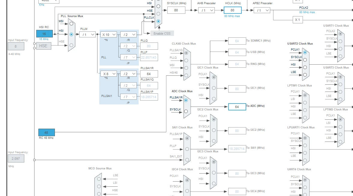

I am getting a internal sensor temperature that is 11°C lower than room temperature, why?
I am using a Nulceo-L452, down below the whole code, but first some high lights:
//To convert I read VDDA and used the macro:
temp_celcius = __HAL_ADC_CALC_TEMPERATURE(3285, adc_in17, ADC_RESOLUTION_12B);
// I set enough sampling time
sConfig.SamplingTime = ADC_SAMPLETIME_640CYCLES_5;
ADC Clock 64Mhz

/** Configure Regular Channel
sConfig.Channel = ADC_CHANNEL_TEMPSENSOR;
sConfig.Rank = ADC_REGULAR_RANK_1;
sConfig.SamplingTime = ADC_SAMPLETIME_2CYCLES_5;
sConfig.SingleDiff = ADC_SINGLE_ENDED;
sConfig.OffsetNumber = ADC_OFFSET_NONE;
sConfig.Offset = 0;
if (HAL_ADC_ConfigChannel(&hadc1, &sConfig) != HAL_OK)
Error_Handler();
/* USER CODE BEGIN ADC1_Init 2 */
Error_Handler();
/* USER CODE END ADC1_Init 2 */
