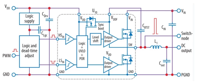

I am designing hardware using STM32H7 and I would like to implement HRTIM to provide PWM signal for DC-DC converter. Please provide me the reference schematic that uses HRTIM.

Hello @EAbra.3 and welcome to the STM32 Community :)
I recommend you this AN4539 Application note HRTIM cookbook.

Thanks for your reply. I have gone through AN4539.I am using HRTIM to provide PWM signals for DC-DC converter EPC2152. Which signals of HRTIM I should use for the same? Currently, I am using HRTIM_CHA1, HRTIM_CHA2. Should I use any other signals like HRTIM_FLTX or HRTIM_EEVx for my application. What is the purpose of these signals (HRTIM_FLTX or HRTIM_EEVx)?

Please find the design of DC-DC converter EPC2152. As per this diagram HRTIM_CHA1 should be connected to HSIN and HRTIM_CHA2 should be connected to LSIN. Please advise me on using other HRTIMER signals.0693W00000WIb4TQAT.png
