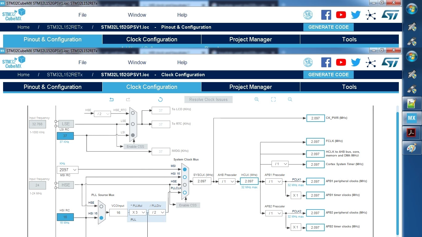

What do you want to do? Use HSI through PLL and generate the same SYSCLK 2.097 MHz default MSI frequency?
antonius
antoniusAuthor
April 7, 2019

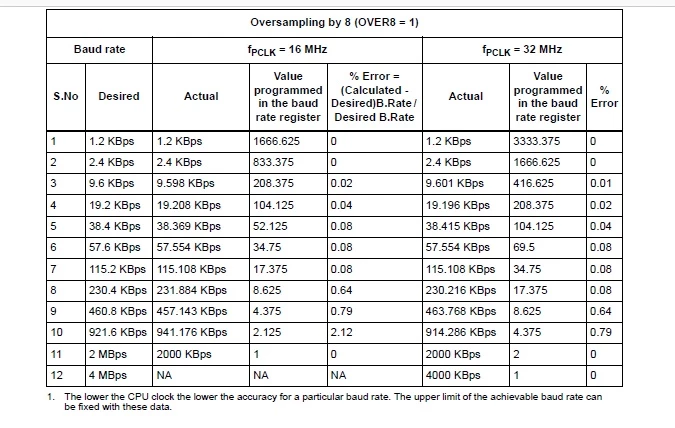

I want to use 16MHz HSI, but SPI2 and UART3 are misconfigured , working on 2.097MHz but not on HSI 16MHz, by the time I have 16MHz
any clues or same experiences ? thanks

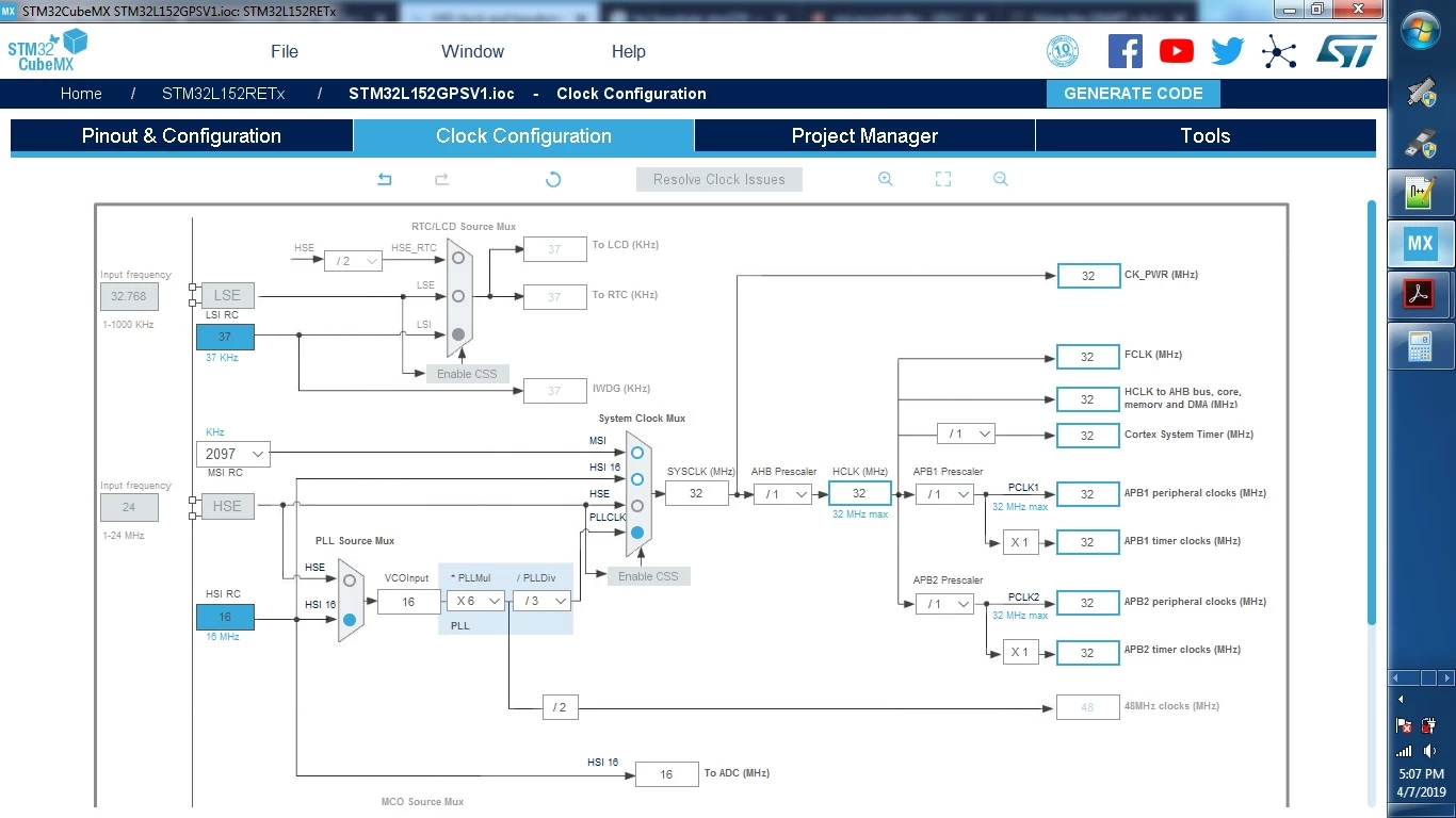

antonius
antoniusAuthor
April 7, 2019
I put on 32MHz, only USART3 can not work properly
I make :
   USART3->BRR = 32000000/115200;

void MX_USART3_UART_Init(void)
 huart3.Instance = USART3;
   huart3.Instance->BRR=34;
 huart3.Init.BaudRate = 115200;
 huart3.Init.WordLength = UART_WORDLENGTH_8B;
 huart3.Init.StopBits = UART_STOPBITS_1;
 huart3.Init.Parity = UART_PARITY_NONE;
 huart3.Init.Mode = UART_MODE_TX_RX;
 huart3.Init.HwFlowCtl = UART_HWCONTROL_NONE;
 huart3.Init.OverSampling = UART_OVERSAMPLING_8;
 if (HAL_UART_Init(&huart3) != HAL_OK)
   Error_Handler();
I read from :

I would decompose the clocks as seen of the AHB/APB. Print them out a USART that is working. Use the SWV channel if available.
HAL_UART_Init() is going to overwrite the value you put in BBR, and BBR might well be locked when the USART is enabled.
What bit rate do you see if you send 0x55 data patterns? You see anything at the pins?

On 2.097MHz :

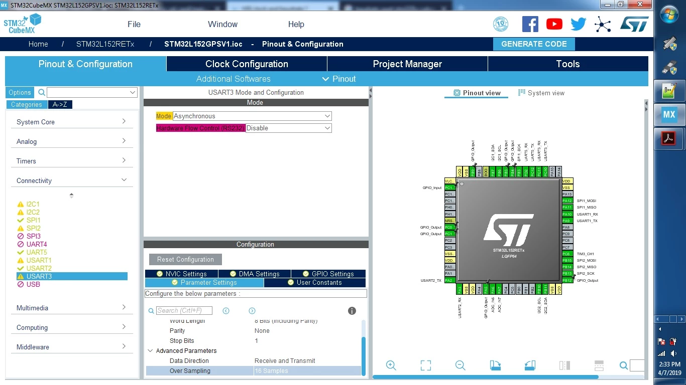

April 8, 2019
On STM32CubeMX, it said, UART3 has a conflict, does it matter ?
Tesla DeLorean
Guru
April 8, 2019
Sorry I don't use CubeMX, what does the Reference Manual suggest are the connectivity modes here, and what pin conflicts are there. As presented you're showing with work with clock source X and failing with clock source Y
So I'd focus on the clock trees and sources, and determine is the clock routing is broken, for example you've selected a source that isn't present, or is at a different frequency.
Outputting a stream of 'U' characters (0x55) gives you something to measure on a scope. ie does something come out of the pin? is it the right frequency?
Try doubling or halving the baud rate you program whilst leaving the terminal at 115200. See data then?
