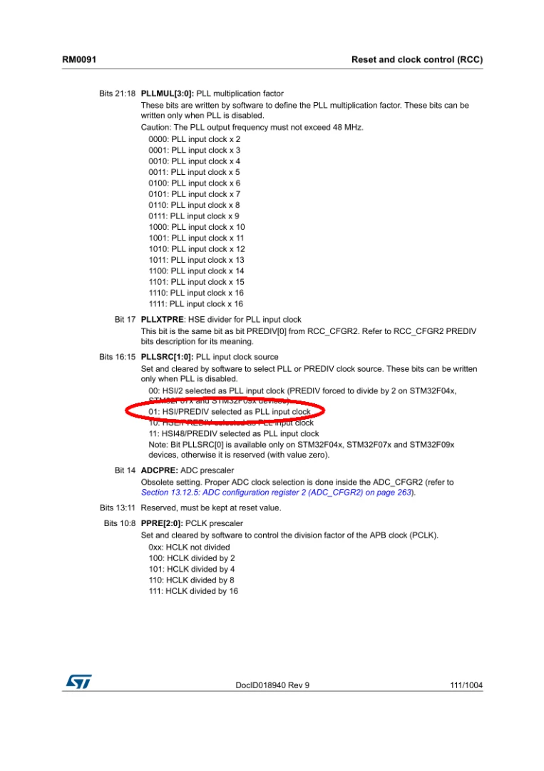

I have a problem with the PLLSRC of a STM32F030RC : to obtain 24MHz for the sysclk I have to use PLLMUL @ x6 with HSI (8MHz) but 6x8 = 48MHz ?
If I output the sysclk on a MCO pin (with no div) I have actually 24MHz.
After use of SystemCoreClockUpdate() from system_stm32f0xx.c the variable SystemCoreClock equals to 48000000 and my call to SysTick_Config(SystemCoreClock/1000) gives a wrong systick frequency ( 2 x too slow, the actuel sysclock is 24000000).
In the reference manual RM0360 at the figure 11 I see no div /2 between HSI and PLLSRC for my STM32F030xC.
But the behaviour
seems like in the figure 10, with a /2 ....
Where is the mistake ?

    waclawek.janBest answer
    June 28, 2018
    Posted on June 28, 2018 at 15:37
    Use this setting:

    Hi
    Miles.Peter
    Please check the content ofRCC_CFGR2: is PREDIV set to '0001' or '0000'?
    -Amel

    Hi Amel,
    Sorry for my late reply. But it is still a mystery for me, I checked the PREDIV of  the RCC_CFGR2 and it is '0000'.
    So I have tried with RCC_CFGR2 set to '0001' and even '0010', but it has no effect on the output frequency still at 24MHz with my
    PLLMUL @ x6.
    On the other hand I am able to read these values in debug mode with atollic and it seems this register is well programmed.
    The behaviour is really like a STM32F030x6 and not a STM32F030xC .
    Is it a bad interpretation of the reference ? My chip is marked as STM32F030RCT6.  Is it a x6 or a xC ???

    Hi
    Miles.Peter
    Sorry to come back to this discussion so late.
    I would like to inform you that we made the test from our side using the same configuration as yours to output SYSCLK on MCO. The output frequency is 48 MHz.
    To continue investigating the issue,could you please share the content of both registers RCC_CFGR and RCC_CFGR2?
