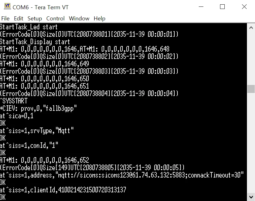

Hello STM32 Team.
I using uart1,3,6 setting for baud rate 115200,
Uart3 setting is it.
 huart3.Instance = USART3;
 huart3.Init.BaudRate = 115200;
 huart3.Init.WordLength = UART_WORDLENGTH_8B;
 huart3.Init.StopBits = UART_STOPBITS_1;
 huart3.Init.Parity = UART_PARITY_NONE;
 huart3.Init.Mode = UART_MODE_TX_RX;
 huart3.Init.HwFlowCtl = UART_HWCONTROL_NONE;
 huart3.Init.OverSampling = UART_OVERSAMPLING_16;
 if (HAL_UART_Init(&huart3) != HAL_OK)
 Error_Handler();
 HAL_UART_Receive_IT(&huart3,&rxd3,1);

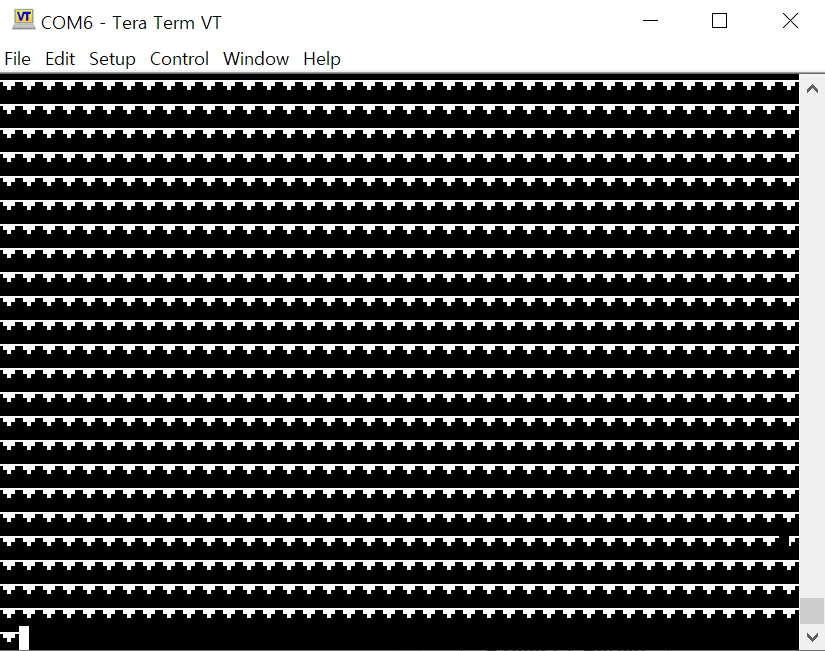

HSI using Uart is it ok,
But, HSE 8Mhz crystal, broken uart message.
Only difference function "void SystemClock_Config(void)"
How can i fix it?
[Setting HSI]
Terminal Message [ok]

[Setting HSE]
Terminal message [broken]

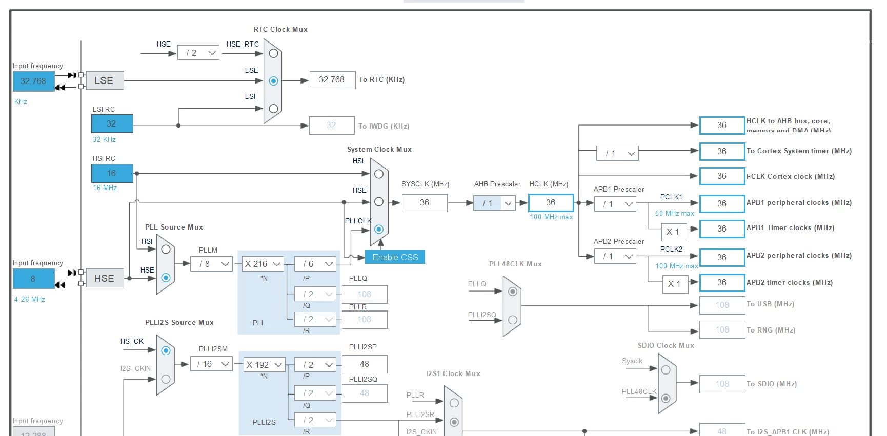

this is my SystemClock_Config source
// Configure the main internal regulator output voltage
__HAL_RCC_PWR_CLK_ENABLE();
__HAL_PWR_VOLTAGESCALING_CONFIG(PWR_REGULATOR_VOLTAGE_SCALE1);
// Initializes the RCC Oscillators according to the specified parameters
// in the RCC_OscInitTypeDef structure.
RCC_OscInitStruct.OscillatorType = RCC_OSCILLATORTYPE_HSE|RCC_OSCILLATORTYPE_LSE;
RCC_OscInitStruct.HSEState = RCC_HSE_ON;
RCC_OscInitStruct.LSEState = RCC_LSE_ON;
RCC_OscInitStruct.PLL.PLLSource = RCC_PLLSOURCE_HSE;
RCC_OscInitStruct.PLL.PLLM = 8;
RCC_OscInitStruct.PLL.PLLN = 216;
RCC_OscInitStruct.PLL.PLLP = RCC_PLLP_DIV6;
RCC_OscInitStruct.PLL.PLLQ = 2;
RCC_OscInitStruct.PLL.PLLR = 2;
Error_Handler();
// Initializes the CPU, AHB and APB buses clocks
RCC_ClkInitStruct.APB1CLKDivider = RCC_HCLK_DIV1;
RCC_ClkInitStruct.APB2CLKDivider = RCC_HCLK_DIV1;
if (HAL_RCC_ClockConfig(&RCC_ClkInitStruct, FLASH_LATENCY_0) != HAL_OK)
Error_Handler();

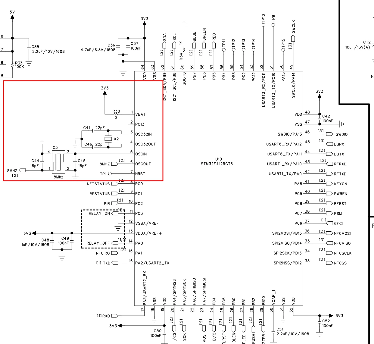

Part name is "STM32F412RGT6"
Include board schematic.
We are modifying and testing the circuit for the CTS RTS test of UART1.
UART6 is used as CTS RTS, and UART3 is used as USB output debugger.

mƎALLEm
December 14, 2023

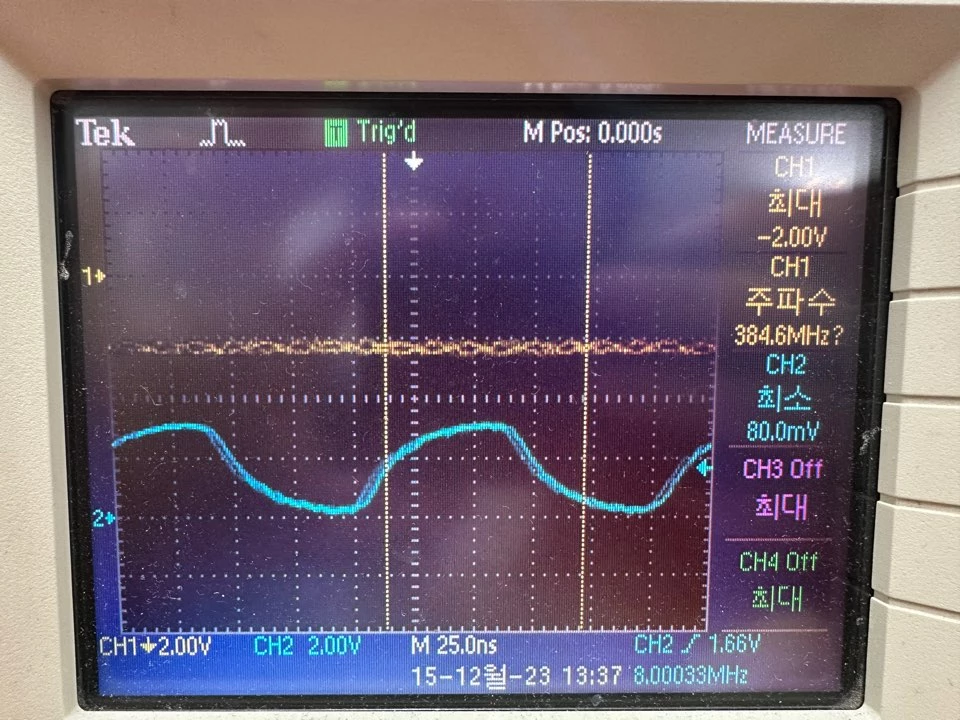

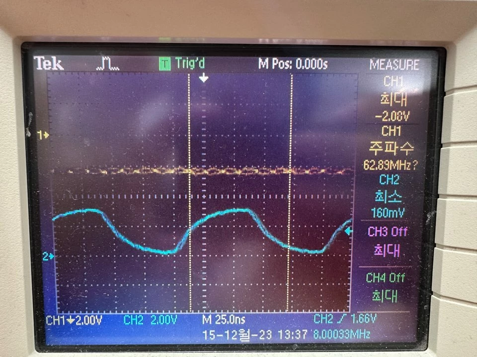

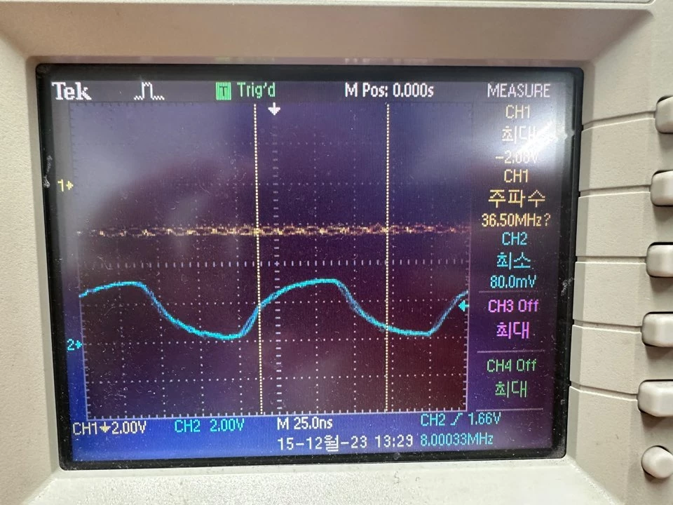

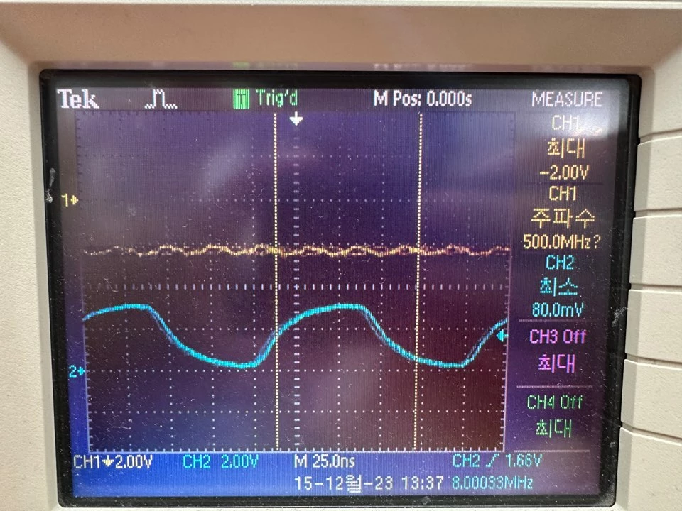

First try to output your system clock on MCO pin and check if you get your 36MHz. It could be something not good from your external crystal/resonator.
KOPROAuthor
December 15, 2023
Like you said
I measured the following using an oscilloscope.
When in HSE mode, the frequency is abnormal as shown below.
[When in HSE mode = Abnormal (Fail)]
PA8(HSE), PC9 (SystemClock)
CH1 = System clock = PC9(System Clock)
CH2 = Crystal Clock = PA8(HSE) is 8Mhz
[When in HSI mode = Normal (Pass)]
CH1 = System clock = PC9(System Clock) is 15.96Mhz
CH2 = Crystal Clock = PA8(HSI) is 15.96Mhz
Below are photos and measured videos.
ch1_20231215_132418134.jpgch1_20231215_132418134_01.jpgch1_20231215_132418134_02.jpgch1_20231215_131716421_01.jpg
