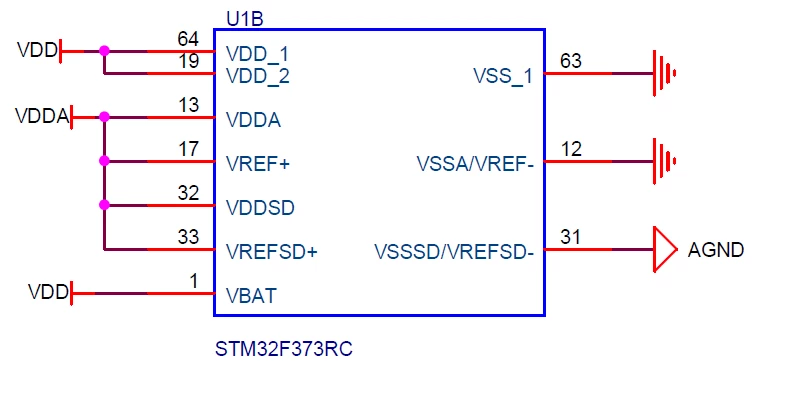

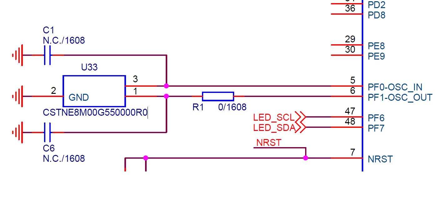

Hello.
My MCU does not work. I guess it is oscillator problem.
- PF1 pin of STM32F373RC is low even though 3.3V power is supplied to MCU, so 8Mhz oscillator does not work.
- The oscillator has internal capacitors and part number is "CSTNE8M00G550000R0"
- I designed this circuit board. I used MCUs of Atmel, TI and Microchip for several years but this is first time to use STM32 MCU.
- I checked 3.3V power is normal and NRST pin value is HIGH.
- There is no other oscillator for LSE
Did I make a mistake?
Please let me know some way how can I check this issue.
Attached image is oscillator part of my circuit.
