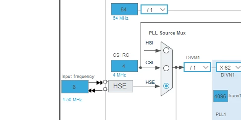

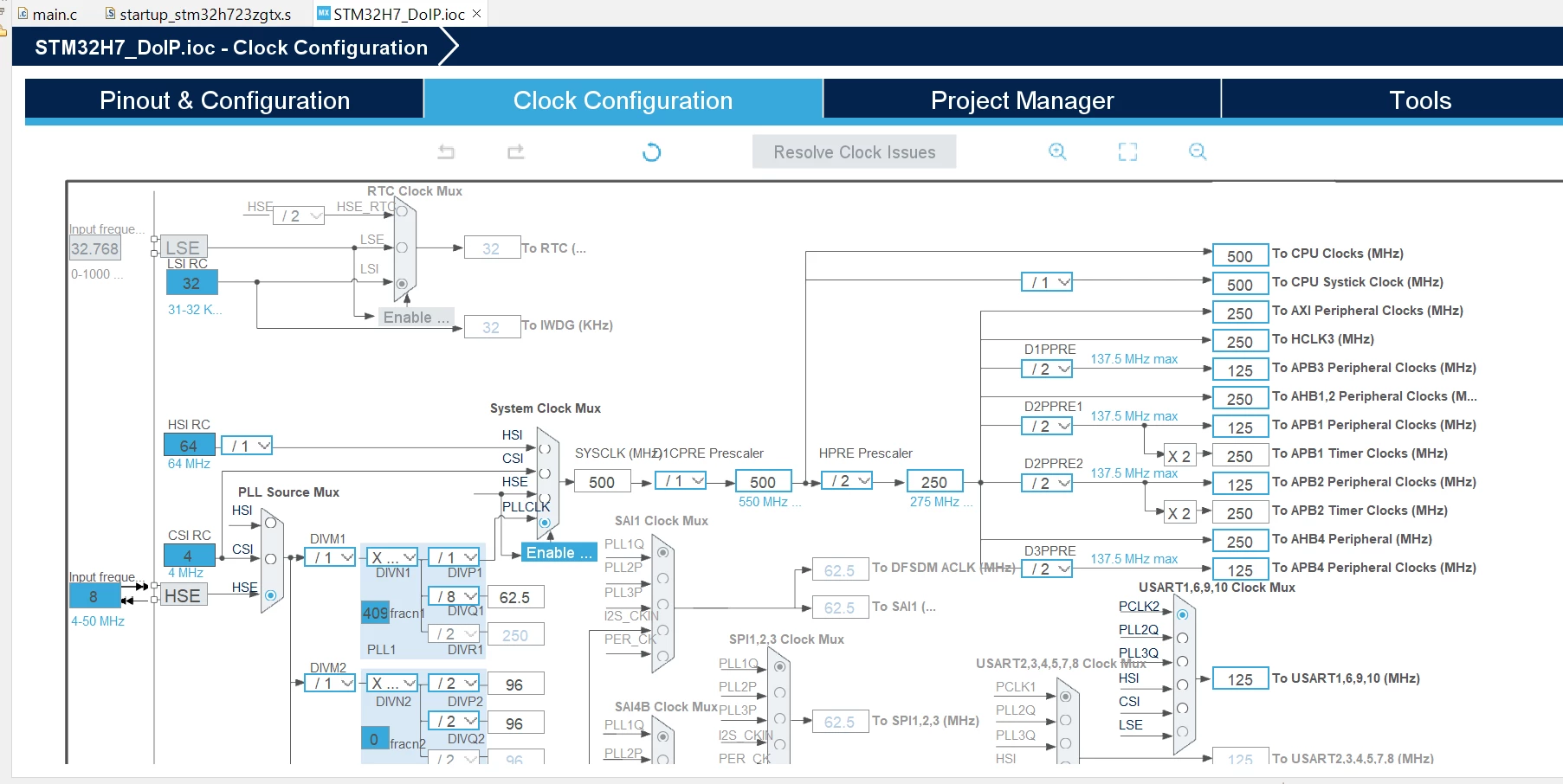

Tested CAN on STM32h723ZGT6 using internal clock i.e., HSI ,which is working fine. When I tried to test it using external clock i.e., HSE with same configuration I am unable to get data on BUS-Analyzer. When I try to transmit the data, the data is able to store in the RAM and even transmit handler is hit. But unable to get data on BUS.
I am using crystal oscillator with 12MHz frequency, baudrate 500k, clock frequency to CAN is 8MHz and all the remaining configurations are as seen in the image below.

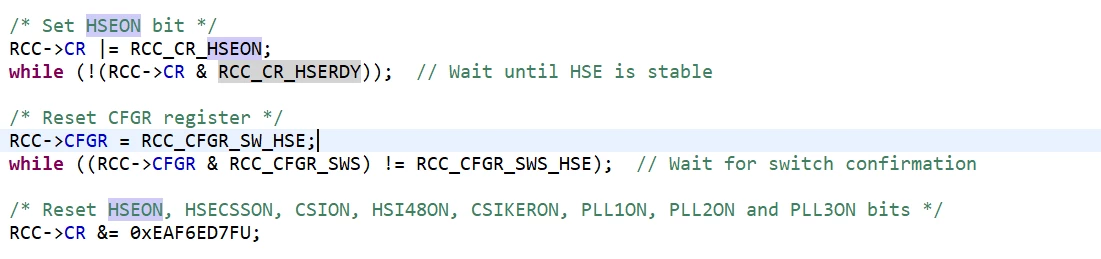

LED, SPI are working with external clock. There is only issue with CAN.
HSE is ON in the driver generated even then I am getting issue in transmission. I am able to transmit but unable to get on BUS.

1- Please use </> button to paste the code instead of sharing screen shots. See this link.
2- Sorry I didn't understand, are you using CubeMx to generate the configuration or are you coding the config yourself? if the second case, I suggest you to generate the code with CubeMx, test it, if it's OK, you can inspire from the register configuration from the HAL.

February 13, 2025
I connected both CANL and CANH and transmitted using internal clock. The issue is only with external clock. I used CAN Bus analyzer tool as ECU to observe transmitted data and also to send data from tool. The complete IOC file is attached below.

Thank you for sharing the ioc file,
But according to ioc file attached:
1- The HSE value is set to 8MHz contrarily to what you said
Need also to clarify what do you mean exactly by "Crystal oscillator"? a crystal or crystal oscillator? see this article.

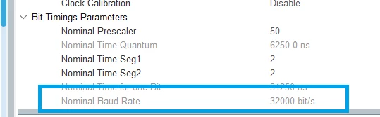

2-  The FDCAN configuration you set is at 32kb/s:
Which is not inline with what you said in the first post:
Could you please double check and confirm?
February 17, 2025
I used a crystal. The frequency of that crystal is 12MHz. Baud rate is set to 500k by changing nominal prescaler, timsegment 1 and 2.
