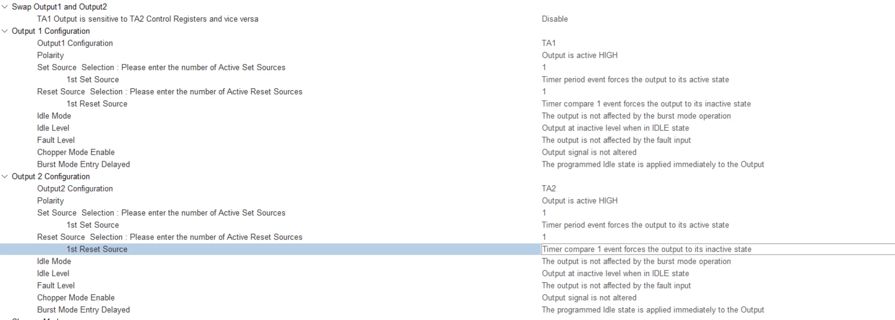

HRTIM changing values of Compare register doesnt do anything

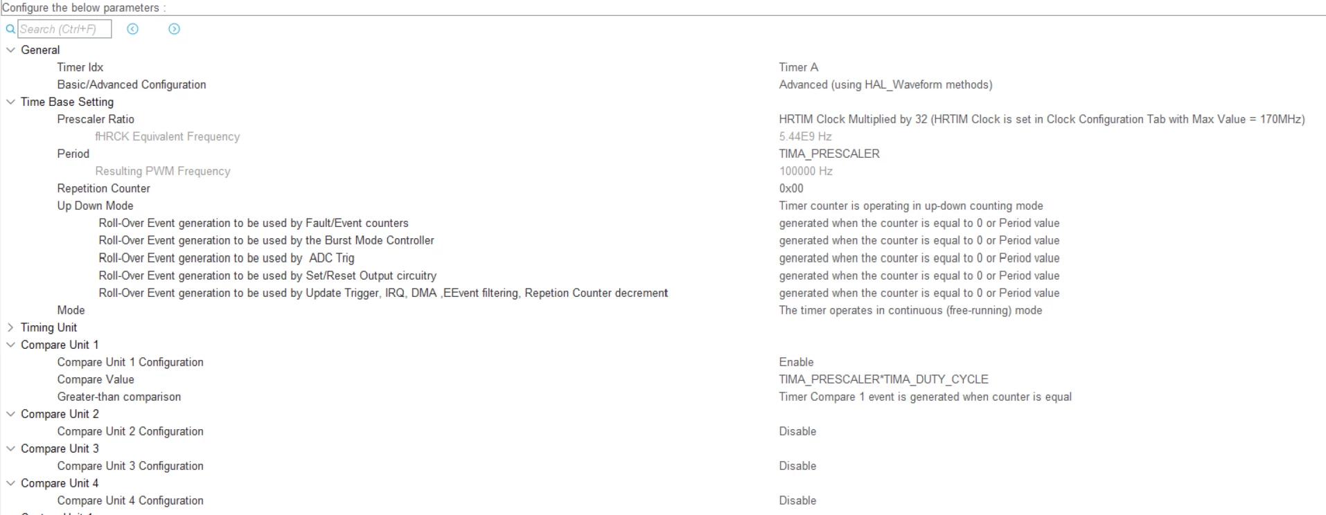

Using stm32G474RE nucleo board and following this guide, i know my way around old "advanced" Timers from stm, im just getting started with HRTIM

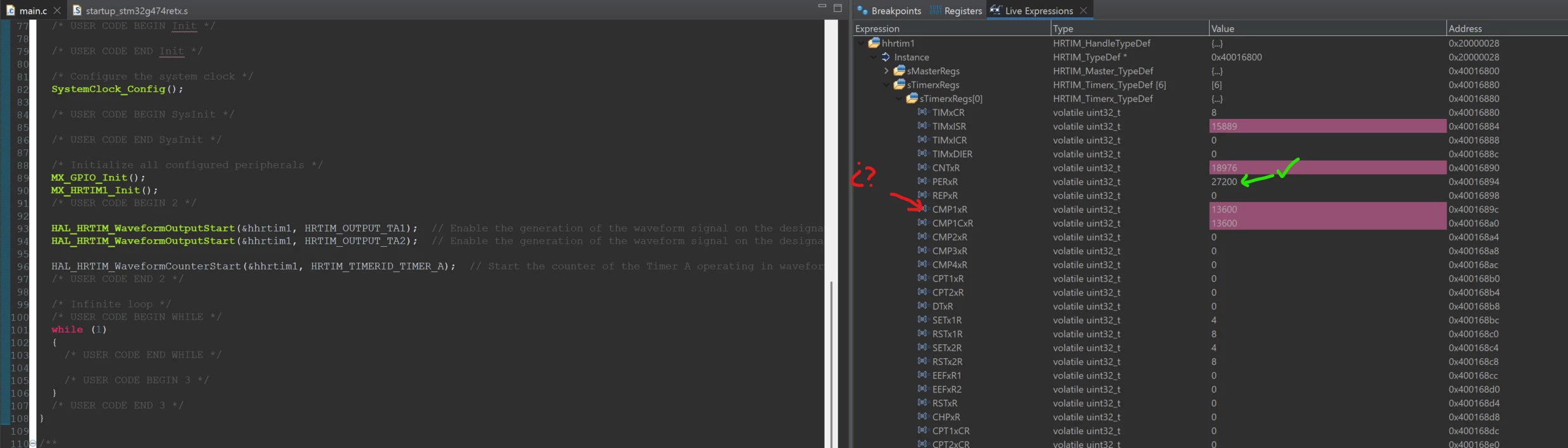

Changing PER register has effect in the PWM frecuency, but changing CMP1 doesnt do anything :(

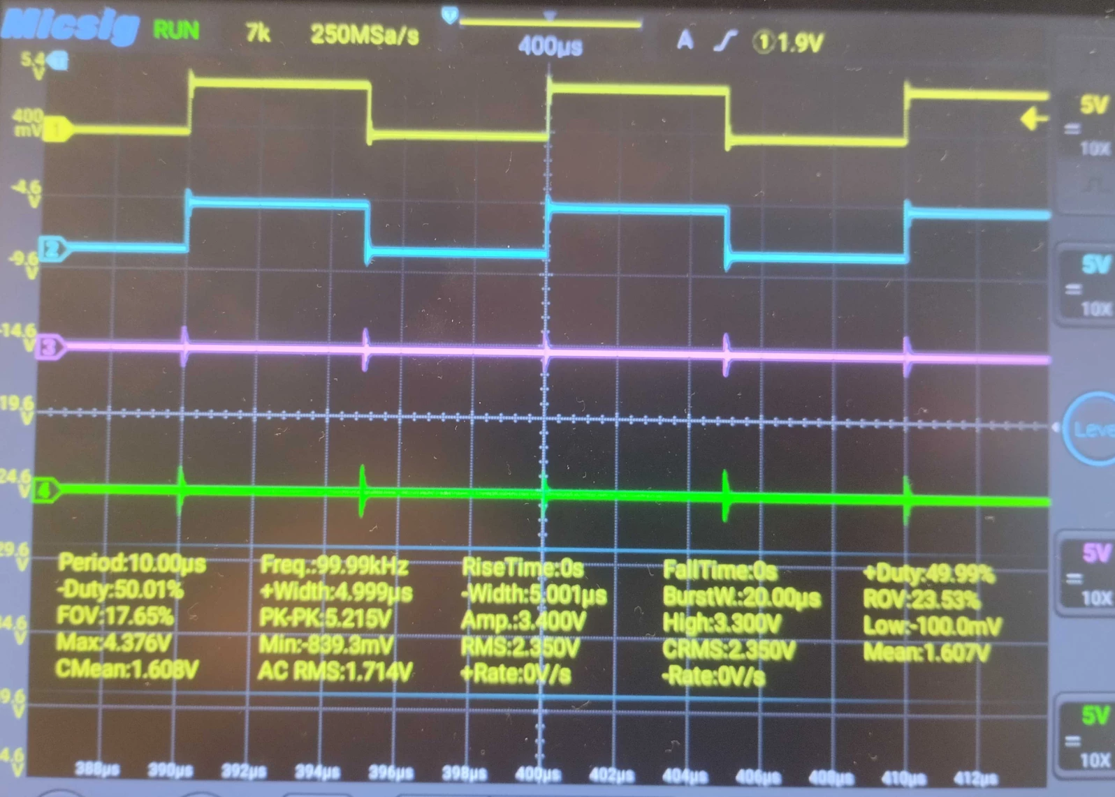

Im not able to change the duty cycle of the PWM , it remains 50% for any Compare register value
My cubeMx setup is

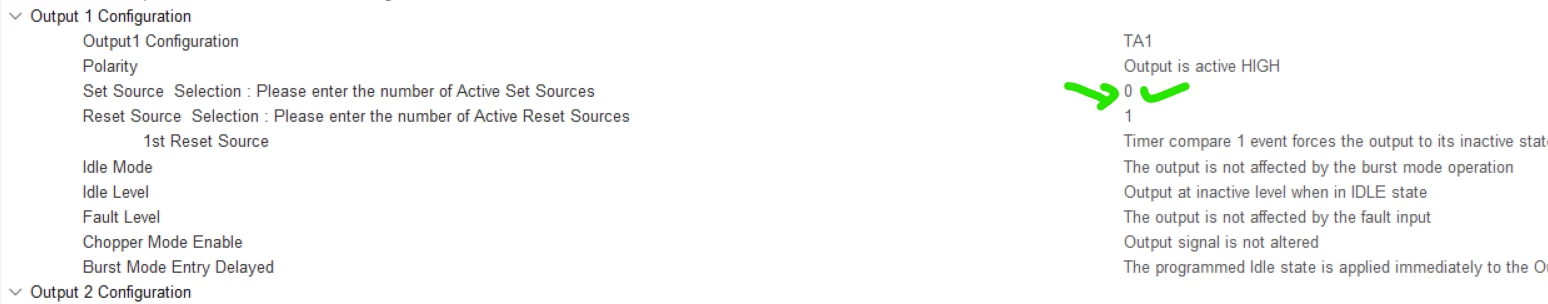

Turns out im using centered mode instead of upcounting, so i shouldnt use any Active Set sources
