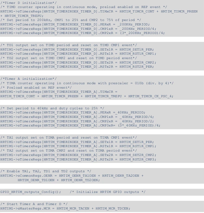

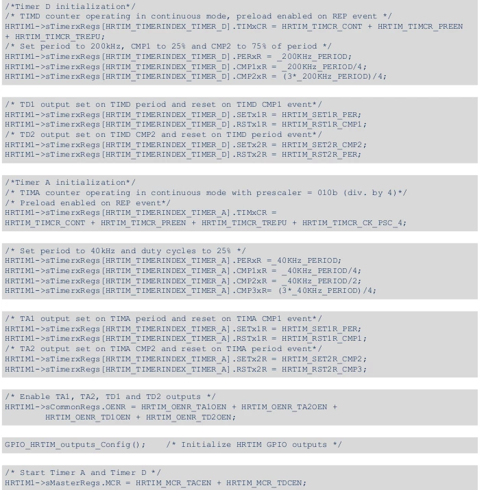

which registers should I use to set to set the flag in the HRTIM_TIMxISR register
O1STAT: Output 1 Status
Output 1 was active
 I think this is a normal question, because I see a discrepancy between the documentation and the behavior of the microcontroller. we need the help of a specialist.
3 replies
AScha.3
June 17, 2023
interrupts are set, when they happen, as in all other cpu also. so HRTIM_TIMxISR is read only.
you can CLEAR it, by setting bits in ->
where is the "discrepancy" in the documentation exactly ? show...
June 27, 2023
you misunderstood me. I am trying to make PA9-PA11 into an active state. to check this state, I use the o HRTIM_TIMxISR register. I was asking what actions I should perform in order for PA11 or PA9 to become active and I could see in confirmation of this
Output 1 was active
all actions taken together from your documentation do not lead to this. I'm not getting the result I should be getting. this means that the behavior of the microcontroller does not correspond to what is described in the documentation
