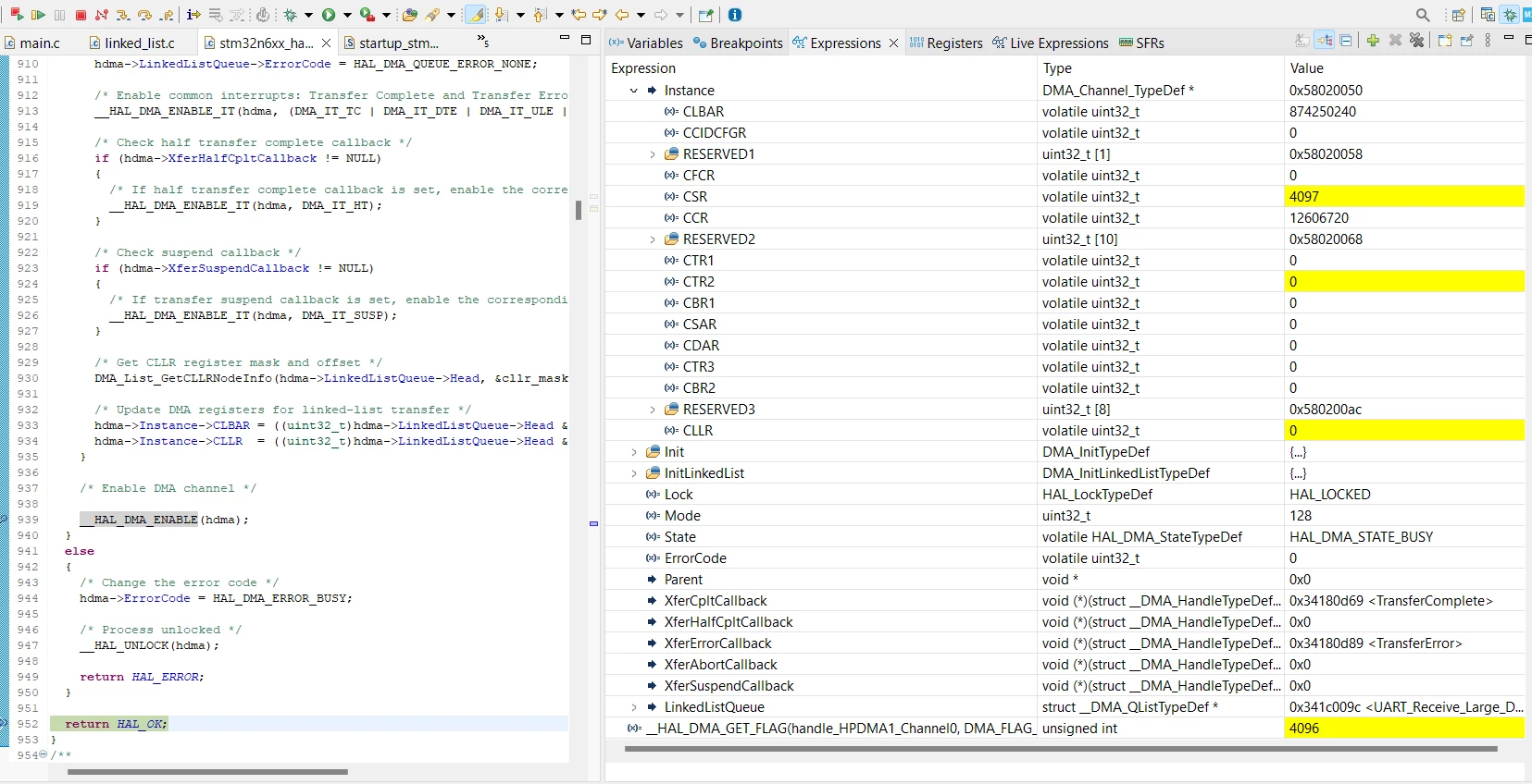

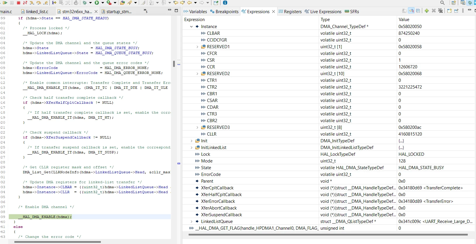

This is a photo of my debugging:
Inside HAL_DMAEx_List_Start_IT(DMA_HandleTypeDef *const hdma),
everything is working similar to Linked mode examples, right side is the registers
After the line: __HAL_DMA_ENABLE(hdma);It seems that the User setting error is arosed and then, all the registers are set to default.
I checked the User manual for many times, and did a lot of debugging, but never figure out whats going on.
Could you please help me figure out whats wrong with this? Thank you.
