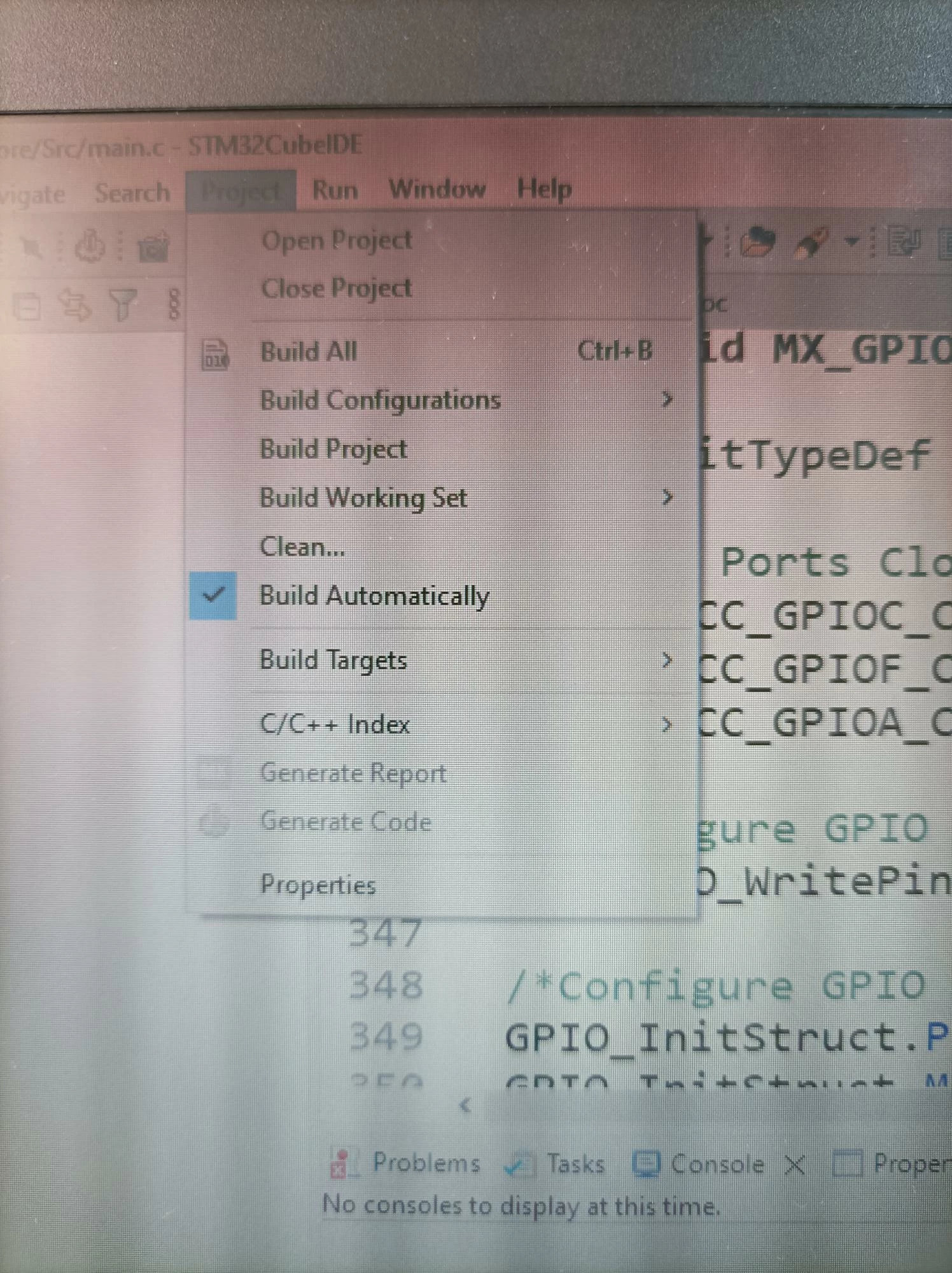

RShre.2
RShre.2Author
March 10, 2023
RShre.2
RShre.2Author
March 10, 2023
if you meant this, i couldn't find that option "Project Manager"
I assume it's not for G0 series.
