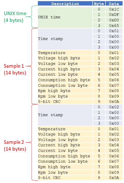

I am writing data to an SD card for a data logger application, but I have very little experience with writing to SD cards so I want to ensure I am writing the data efficiently.
My understanding is that data is written as a sector of 512 bytes.  So even if I write a single byte, it will need to write all 512 bytes in a sector to do so ?
I am using the FatFs driver with an SPI interface running on the NUCLEO-L433RC-P dev board.
At the moment I create a binary file and start the file with the UNIX time, followed by samples (each 14 bytes in length) until the data log is completed.
Each sample consists of a 4-byte tick time and 10-bytes of serial data received via the UART (at a 100ms rate):
  • Tick time from HAL_GetTick()  (32 bits)
  • Temperature (8 bits)
  • Voltage high byte (8 bits)
  • Voltage low byte (8 bits)
  • Current high byte (8 bits)
  • Current low byte (8 bits)
  • Consumption high byte (8 bits)
  • Consumption low byte (8 bits)
  • Speed high byte (8 bits)
  • Speed low byte (8 bits)
  • CRC (8 bits)
The diagram below shows the structure of the binary file, with just 4 samples for simplicity.  The number of samples for a real data log would obviously be much higher than could fill the entire SD card.
I currently write to the SD card (using f_write) each time the serial data is received (~100ms), but I believe this is inefficient because it writes a sector of 512 bytes a time and it takes a certain amount of time to write the data.  I also think this technique might cause additional wear on the SD card ?
So how should I write this data efficiently ?
Should I wait until I have enough data to fit into a single sector before performing the write ?  If so, I could only fit 36 samples in a sector as this would be 508 bytes...
  • 36 samples would be 508 bytes i.e. 4 bytes (UNIX time) + 14 bytes (data packet) * 36 = 508 bytes
But this would leave 4 spare bytes in each sector, in which case if these bytes are unused it would be inefficient in terms of memory space.  Or are the unused spare bytes somehow used when the next write occurs ?
Is the sector size for all SD cards always 512 bytes, or does the sector size depend on how the SD card is formatted ?
I notice that when I format the SD card, there is an allocation unit size.  Is this anything to do with the sector size ?
Eventually I want to use larger SD cards so will need to use the exFAT format.
My code is attached for reference

I am sending UART data (using Realterm) which will be written as a binary file to the SD card.
The file structure is as follows:
  • Initial four bytes is the UNIX time:  For debugging purposes this is a fixed value of 1708187420 (0x65D0DF1C)
  • Next 14 bytes is a "sample" which contains…
    • Four bytes for the time stamp: For debugging purposes this starts at 1 and increments by 1
    • 10 bytes of telemetry data:  For debugging purposes the values are 0x01 0x02 0x03 0x04 0x05 0x06 0x07 0x08 0x09 0x0A.
I send 585 'samples' using Realterm which is 8190 bytes for each send (i.e. 585 x 14).
Note: In the real application, the 10 bytes of UART data is transmitted at a 100ms rate.  But for debugging purposes I use Realterm to send all 8190 bytes transmitted in one go.
The UART interrupt is configured to receive 10 bytes, during this interrupt the time 'stamp' is incremented and a data received flag is set...

I start seeing incorrect data values in the file after sending more than 3 x 585 'samples' using Realterm.  For the moment I've only looked at the time 'stamp' values, which should start at 1 and increment by 1.
  • For the 1st 585 samples sent by Realterm, the time 'stamp' starts at 1 and ends at 585 (correct).
  • For the 2nd 585 samples sent by Realterm, the time 'stamp' starts at 586 and ends at 1170 (correct).
  • For the 3rd 585 samples sent by Realterm, the time 'stamp' starts at 1171 and ends at 1755 (correct).
  • For the 4th 585 samples sent by Realterm, the initial time 'stamp' starts at 1756 (correct) but the next time 'stamp' is 1844 (incorrect - it should be 1757).  The 'stamp' continues to increment but the values are wrong.

Thanks tjaekel
It sounds like my approach was correct in the first place, but I'm having a few issues.
I understand how f_sync and f_close are required before removing the SD card or powering down etc.
For now I am using the push button switch (as an external interrupt) to start and stop the data log.  This indicates when f_open needs to create a new file and f_close needs to close the file.
However, with my current implementation I am seeing incorrect data values in the file and loosing the last part of data because I'm not sure how to force the data to be written when I press the button to stop the data log.
Below are details about my implementation and the issues it has...
