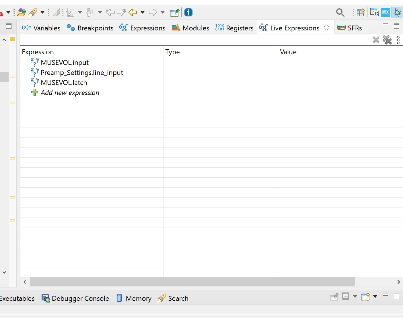

How to watch variable values in the code during runtime in STM32Cube IDE debugger like seeing the values of SFRs for STM32F4 Discovery board?ie) How to use Variable views?

Best answer by MM..1
You can live only global static variables, for local you need break your code on place where exists...

You can use 3 variants, Variable view shows local variables in breakpoint area automaticaly,
Watch 1 and 2 shows your selected variables, and Live variables shows selected on run state too.

Please tell me where to find and how to use the Watch 1 & 2, Live variables. I browsed through the IDE and I could not find that.

Watch 1 2 i miss from other system but in IDE switched to debug perspective you see all
