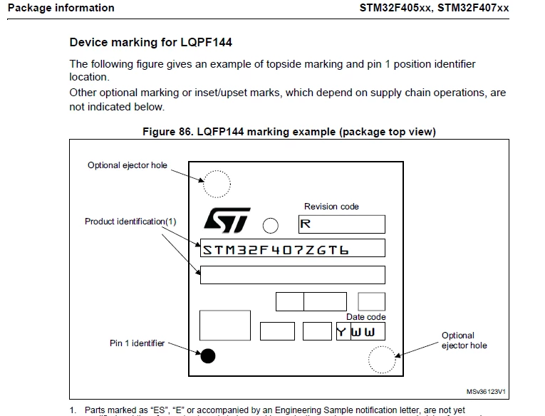

how to verify the fake STM32 MCUs?
    Imen.DBest answer
    Jan 11, 2022 1:55 PM UTC
    Hello @SYang.5​ and welcome to the Community :)
    What exactly do you have in the STM32Cubeprogrammer when you connect to the devices?
    You can check the data (UID, flash size,...) with the datasheet of your product.
    I advise you to check this post How to Spot Fake STM32 MCU.
