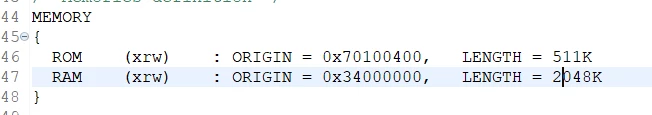

After further study I found that I was creating FSBL project which has maximum size capped at 512KB. After that I think I found a right way to develop application. But still I think I can only play with 2048 KB.
Build "Template_FSBL_XIP" from "STM32Cube\Repository\STM32Cube_FW_N6_V1.0.0\Projects\STM32N6570-DK\Templates"
I took one dummy array for testing. If I increase the RAM size in "STM32N657XX_XIP.ld" to more than 2048 code does not boot up.
Attaching Template_FSBL_XIP example. Can you please modify the project to utilize maximum RAM?

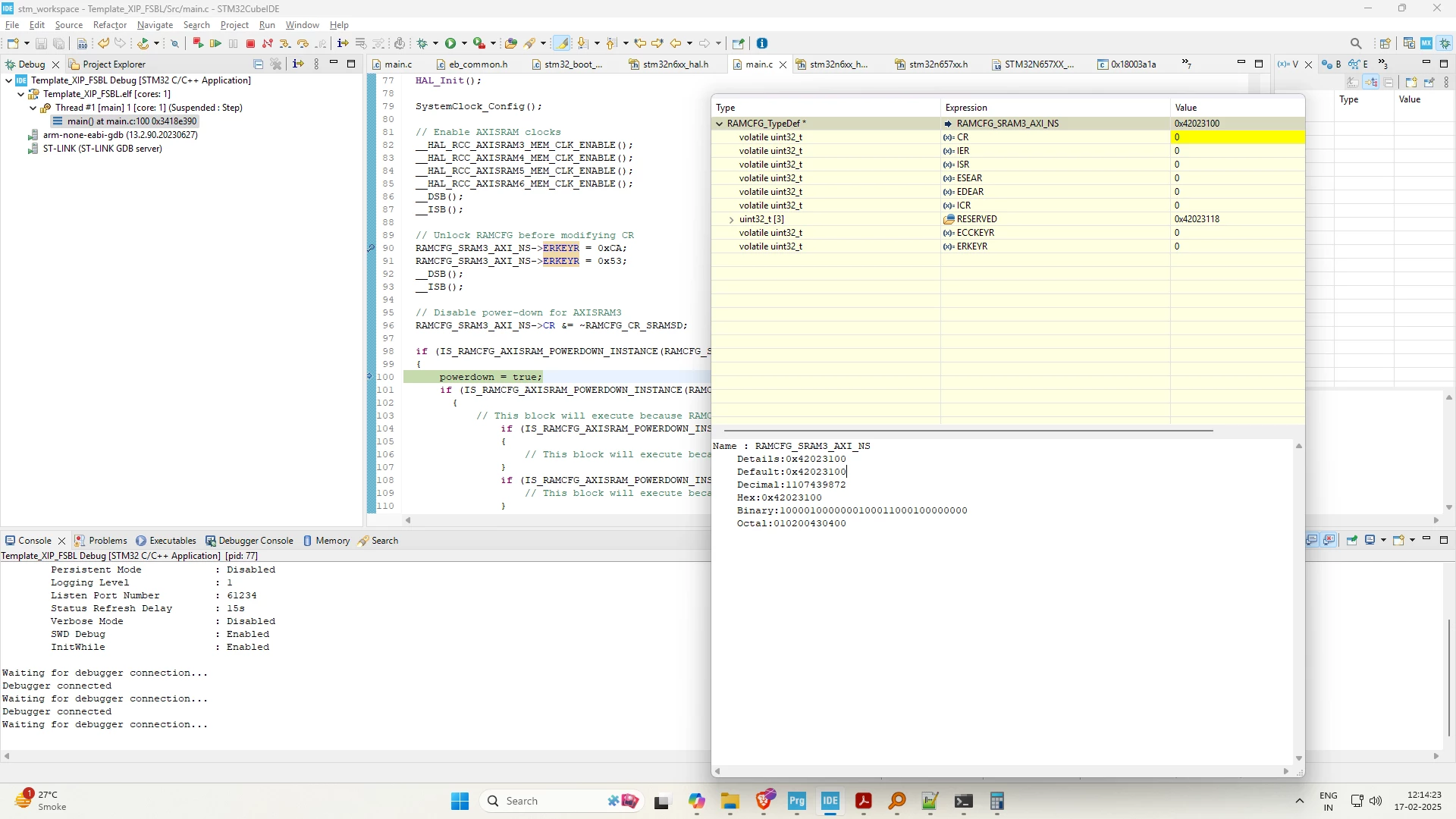

We attempted to enable AXISRAM3/4/5/6 using the __HAL_RCC_AXISRAMx_MEM_CLK_ENABLE() HAL API, but we were unable to run the application. In application we are using 3072K uin8_t buffer, and we verified that it does not entered the application.

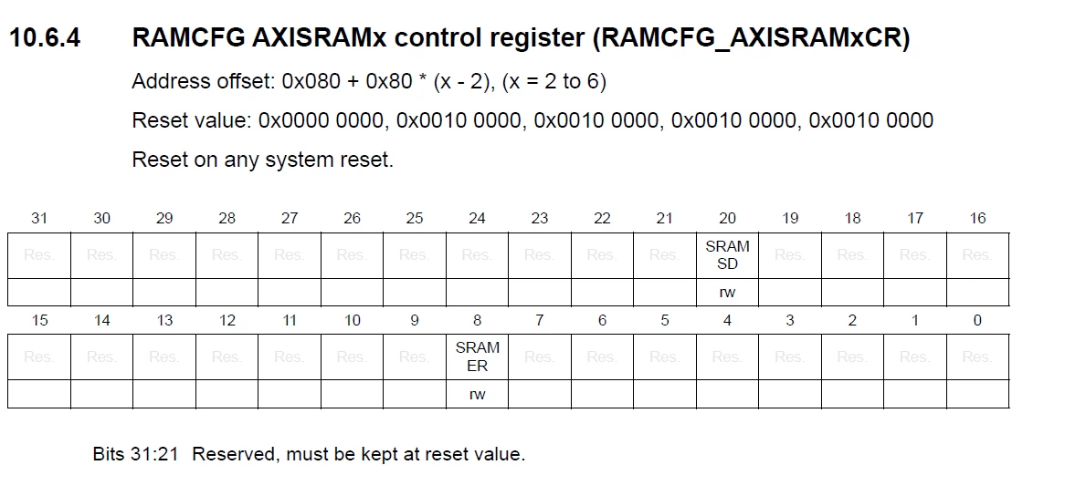

Upon reviewing the datasheet, we found that Bit 20 (SRAMSD: Shutdown AXISRAMx) must be set to zero to ensure the memory remains powered. However, despite this configuration, we still observed a power-down variable value of 1.
Below is a snapshot FSBL code for refrence.
Please guide us to any reference or application note achieve full STM32N6 RAM use.

 1- In your snapshot, it seems you're executing your code in secure mode, try to access the RAMCFG register with the secure address alias instead of the non-secure one!

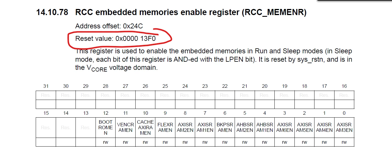

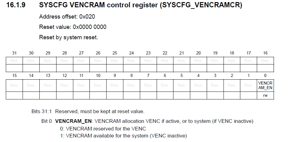

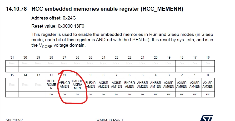

2- Actually, if you add all AXISRAMx, you get 3.75MB! But in order to have the 4.2MB of memory, the NPU Cache (CACHEAXI) and the VENCRAM is used as system SRAM. Indeed, they are used by the NPU, and the VENC but when NPU and VENC are not used, these SRAM can be accessible by the CPU as normal AXISRAM.
So you need also enable these SRAM clocks
By default, the CACHEAXI is in SRAM mode when the CACHEAXI is not activated.
But for the VENCRAM, you need to make sure that:
- the VENC is disable
- in the SYSCFG_VENCRAM register, the VENCRAM is available for the system.
3 - For all of these RAM, always don't forget to make sure that they are not power down in the RAMCFG register.

In the template code, there is no non-secure application. However, since we are accessing the RAMCFG register from a non-secure application, we added the CPU_IN_SECURE_STATE  macro to access the RAMCFG register using the secure address. Despite this change, we are still unable to jump into the application.
