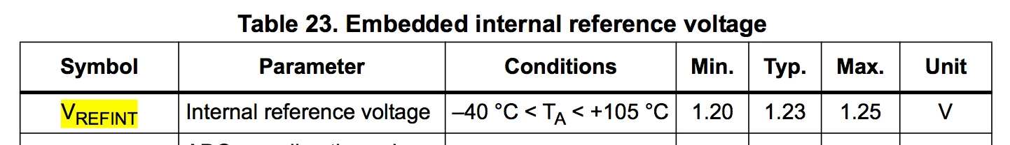

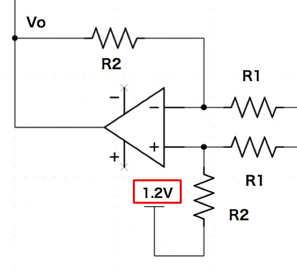

I want 1.2 V in operational amplifier circuit.
so, I want to use VREFINT as 1.2V.
But I don't know how to use VREFINT.
I don't know how to output VREFINT with Cube MX.
I am using STM32F334Nucleo.

    Hello Inue!!
    Vrefint is an internal only reference voltage  in your case.
    Other MCUs have the VREF as external pin.
    But you can find
    http://eu.mouser.com/Semiconductors/Power-Management-ICs/Voltage-References/_/N-10vu2?P=1z0wd7k
    specialised voltage references for your need.
    But I don't know how to use VREFINT.'
    VREFINT can be readed  form ADC1, ADC2 as a normal channel .  Can be used also from internal comparators as negative input!!
    Other use of VREFINT is to convert  readed ADC values , to real voltages.
