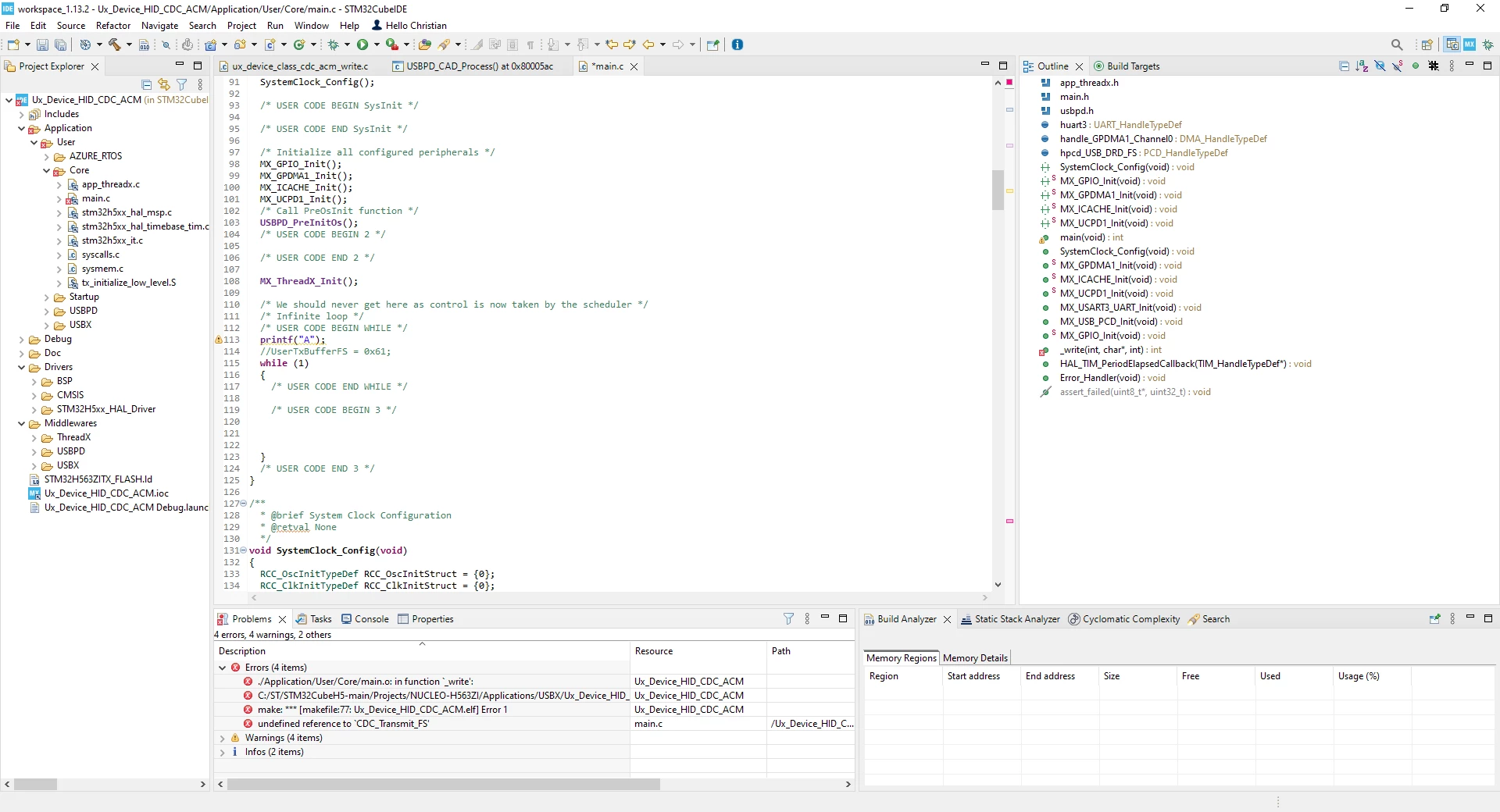

I insert you code in example in section /* USER CODE BEGIN 4 */
And call printf before while(1) with printf("A");
By building project I got 4 errors:
I hope you can read it.
CDC_Transmit_FS is undefined.

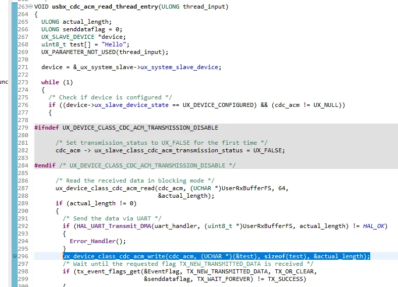

I want to send and receive customized data from my programm and from PC via virtual com port.
Thanks to @AScha.3, I found the function to send Data (ux_device_class_cdc_acm_write()).
But my fault was to call it in main.c
If I call it in ux_device_cdc_acm.c and it workin fine. Here my quick test:
I am happy to get this to work.
But is it possible to call the function in main.c or how can share data from main.c to ux_device_cdc_acm.c?
Maybe with global variables?

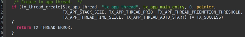

Hi @Christian_Janz  , you have a lot to understand now - using a RTOS , no more "just" a program.
1. no more "main"  = the program ! now many "main" possible, all running (virtual) at same time.
2. read the comment in main.c , and believe it :
now your program is in processing tasks or threads !
so if you dont need this (maybe same me: had to use this Azure just because STM leaves us no choice anymore : want USB , Fat-file system ? then use Azure! )

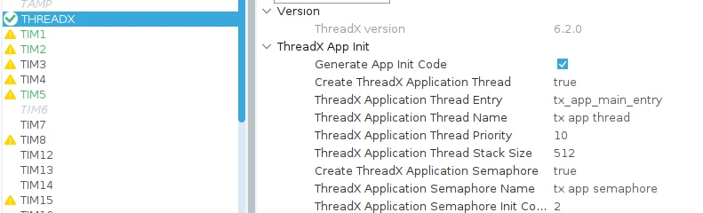

you can use the first and only thread, that is generated by Cube if you let it do it :
then in core -> app_threadx.c :
i just rename this first thread to  >> tx_app_main_entry << , to see my "main" now by a similar name. :)
so write here, what you in old times wrote in "main" , here my H563 program begins:
void tx_app_main_entry(ULONG thread_input)
 /* USER CODE BEGIN tx_app_main_entry */
	printf("app_main start \n");
	/*##-2- Register the file system object to the FatFs module ##############*/
 	fresult = f_mount(&SDfs, (TCHAR const*)SDPath, 1);			// SD card mount
 if(fresult)
 	printf(" mount error ! \n");
- ( but i am using fatfs here , not filex )
