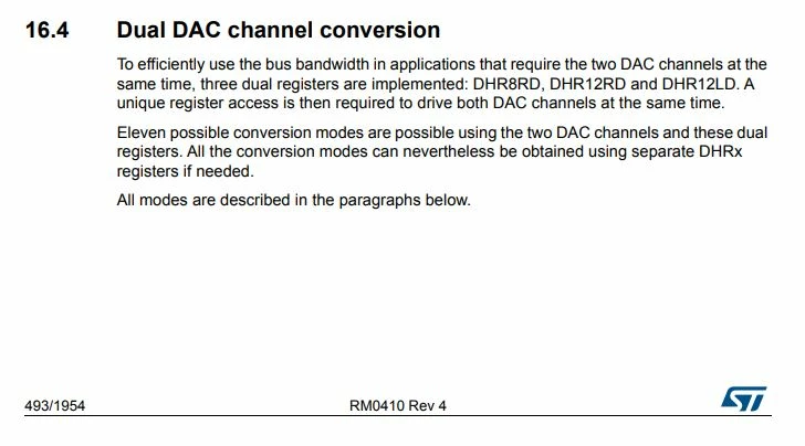

Hello @LDesa.1​ ,
In dual DAC channel mode, conversions could be done simultaneously.
To efficiently use the bus bandwidth in applications that require the two DAC channels at the same time, three dual registers are implemented: DHR8RD, DHR12RD and DHR12LD.
A unique register access is then required to drive both DAC channels at the same time.
For more details, you can refer to the "Dual DAC channel conversion" section in the RM0410.
0693W000008wlM7QAI.jpgChannel data transfer is performed by DMA peripheral in serial. If two requests have the same software priority level, the channel with the lowest number will get priority versus the channel with the highest number.
For example, channel 2 gets priority over channel 4.
You can refer to the "Digital-to-analog converter (DAC)" and "Direct memory access controller (DMA)" chapters in reference manual RM0410.
