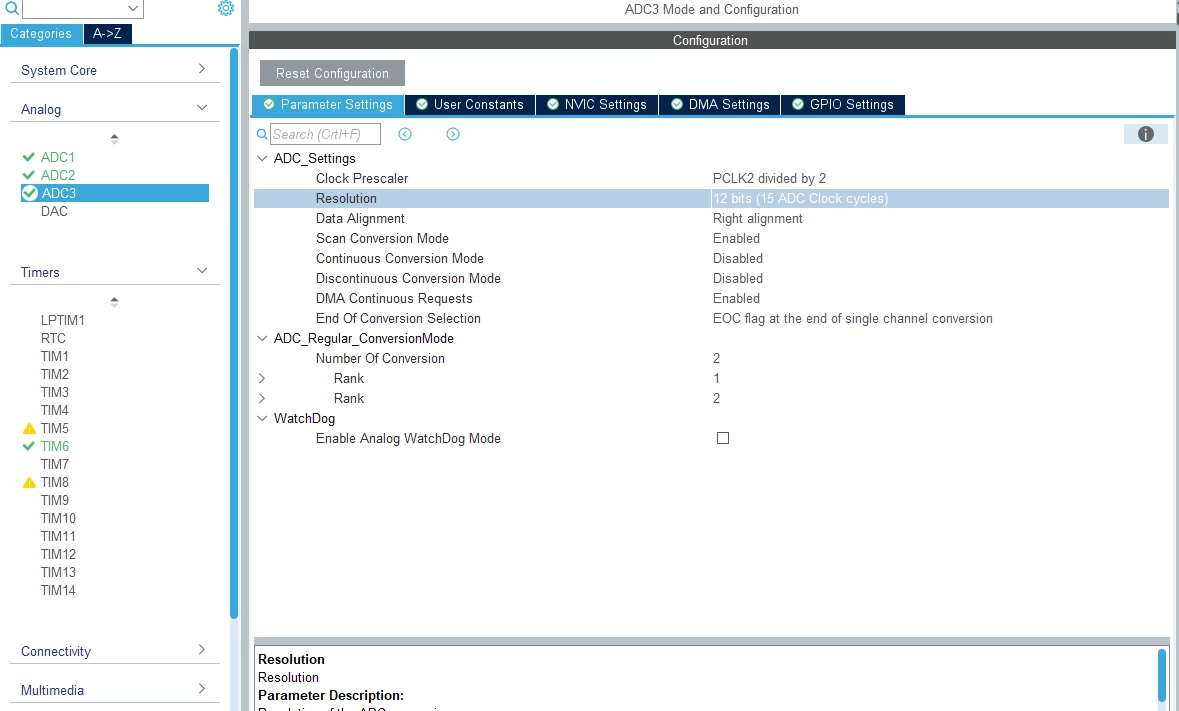

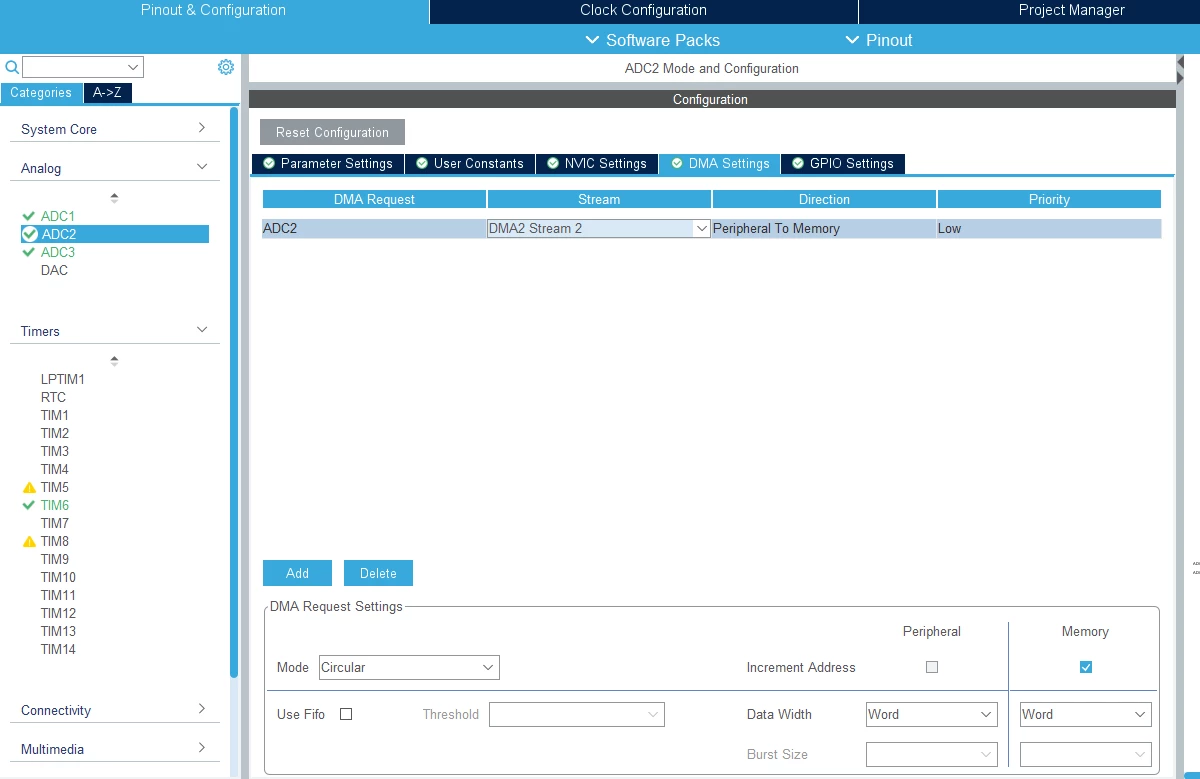

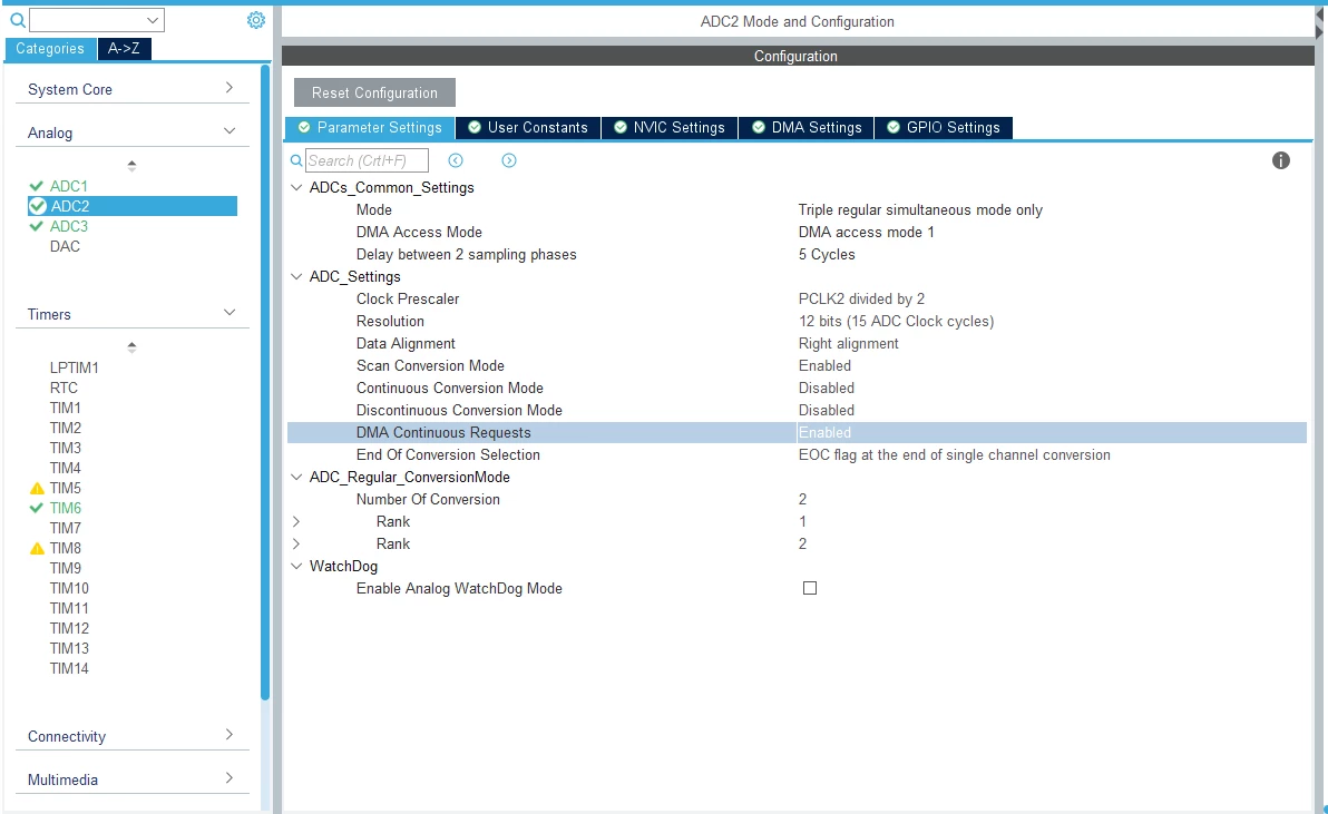

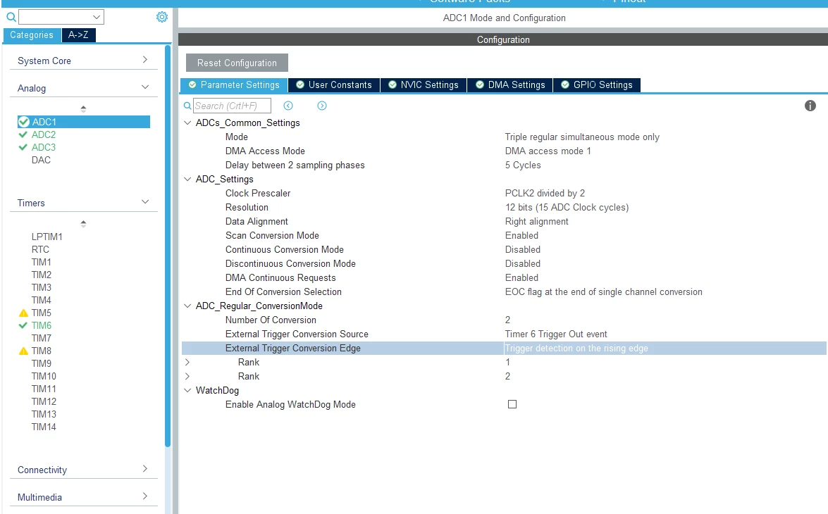

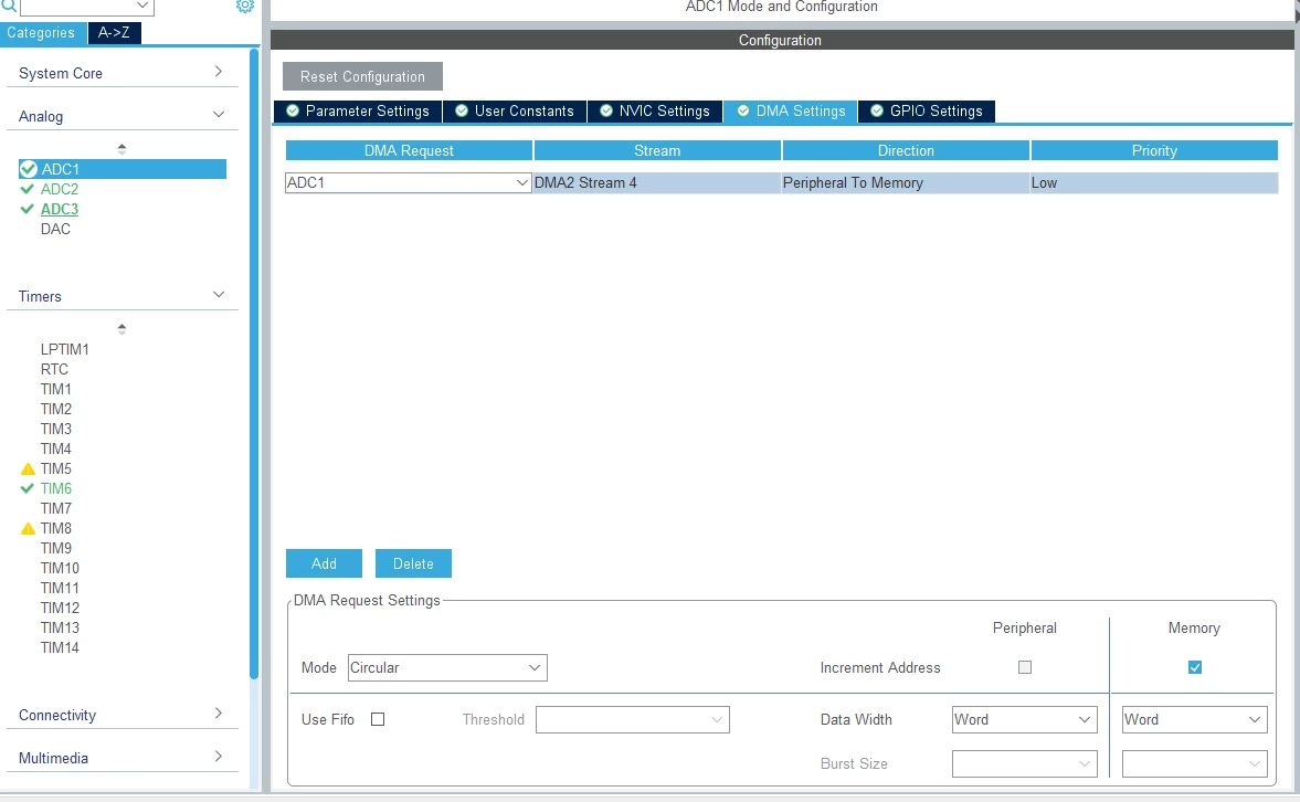

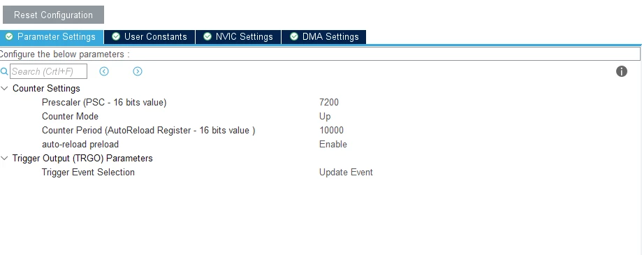

This is what I want to do: Use ADC1, ADC2 and ADC3 each with multiple channels. I want to trigger them with a timer.
Definition of the buffers:
volatile uint32_t gValueArrayADC1[NUMBER_OF_CHANNELS]={11,12};
volatile uint32_t gValueArrayADC2[NUMBER_OF_CHANNELS]={21,22};
volatile uint32_t gValueArrayADC3[NUMBER_OF_CHANNELS]={31,32};
static uint32_t * pADCArray[NUMBER_OF_ADCS]= {&gValueArrayADC1, &gValueArrayADC2, &gValueArrayADC3};Start of Timer an ADC:
HAL_ADC_Start_DMA(&hadc2, pADCArray[INDEX_ADC_2], 2);
HAL_ADC_Start_DMA(&hadc3, pADCArray[INDEX_ADC_3], 2);
HAL_ADCEx_MultiModeStart_DMA(&hadc1, pADCArray[INDEX_ADC_1], 2);
HAL_TIM_Base_Start(&htim6);Everything else is just generated by CubeMx. I will attach my config there at the end of the post.
My problem: it's only going into the DMAX_Streamx_IRQHandler of 2 ADCs. I get values, but they do not seem valid to me.
