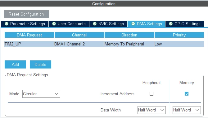

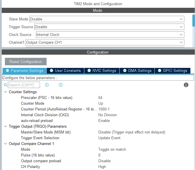

I use the following initialization of the TIM2 peripheral and the code below to start the DMA. Pins PC0 to PC3 are configured as outputs.
On the oscilloscope I get the TIM2_CH1 Output Compare signal at 500 Hz.
But the DMA does not affect the GPIOC->ODR state. Why?

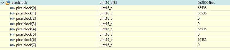

 uint16_t pixelclock[8] = {0xffff, 0xffff, 0x0000, 0x0000, 0xffff, 0x0000, 0xffff, 0x0000};
 HAL_DMA_Start(&hdma_tim2_up, (uint32_t)pixelclock, (uint32_t)&(GPIOC->ODR), 8);

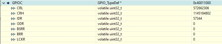

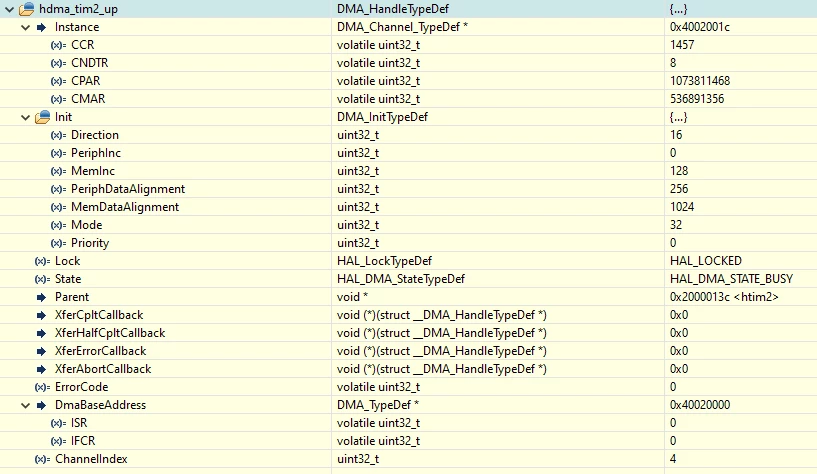

Debugger state:

HAL isn't set up to do this, but it can be done.
Ensure UDE is set in TIMx_DIER. If that's not it, show the contents of the TIM2 registers.

That was it!
Thank you so much :)
