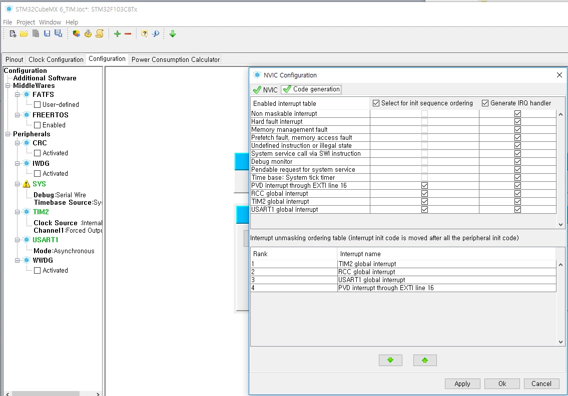

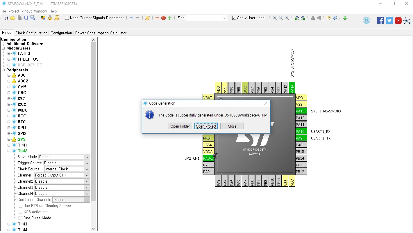

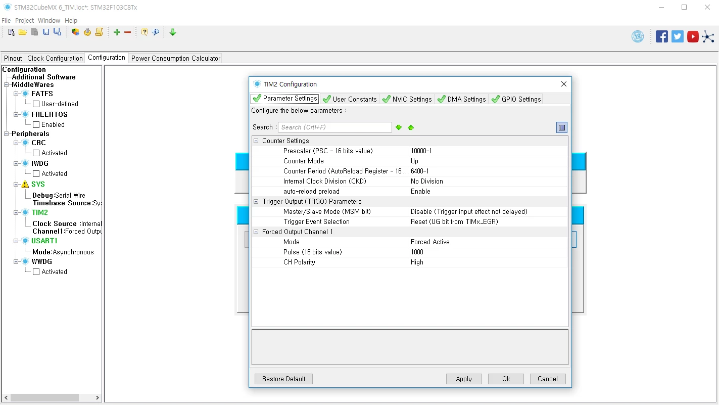

How to use "TIM2_CH1" Timer interrupt to make toggle LED at PA0 every 1sec
- October 3, 2018
- 3 replies
- 2210 views
-I verify PA0 LED is good work(test with "HAL_GPIO_Toogglepin()")
-contains cubeMX project files, Truestudio projets
-my addtional user code down below
-cubeMX select option is also captured
==============usercode==============
/* USER CODE BEGIN 2 */
HAL_TIM_Base_Start_IT(&htim2);
/* USER CODE END 2 */
/* USER CODE BEGIN 3 */
HAL_Delay(1000);
/* USER CODE END 3 */
/* USER CODE BEGIN 4 */
void HAL_TIM_IC_CaptureCallback(TIM_HandleTypeDef *htim)
HAL_GPIO_TogglePin(GPIOA,GPIO_PIN_0);
HAL_GPIO_TogglePin(GPIOA,GPIO_PIN_1);
HAL_GPIO_TogglePin(GPIOA,GPIO_PIN_2);
/* USER CODE END 4 */
