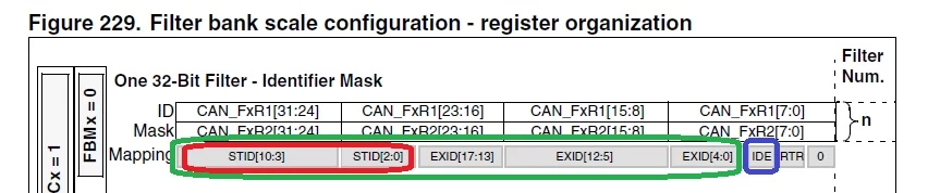

How to use the STM32F205 Canbus ID filter? it seems like it does not works as rule:

I tried to configure CAN ID filter to only allow ID = xxEAECxx to go through CAN2
static void CAN_Filter(void)
CAN_FilterConfTypeDef sFilterConfig;
sFilterConfig.FilterNumber = 14; //0-13: CAN1, 14-27:CAN2
 sFilterConfig.FilterMode = CAN_FILTERMODE_IDMASK;
 sFilterConfig.FilterScale = CAN_FILTERSCALE_32BIT;
sFilterConfig.FilterIdHigh = 0x00EA;
 sFilterConfig.FilterIdLow = 0xEC00;
 sFilterConfig.FilterMaskIdHigh = 0x00FF;
sFilterConfig.FilterMaskIdLow = 0xFF00;
 sFilterConfig.FilterFIFOAssignment = 0;
 sFilterConfig.FilterActivation = ENABLE;
 sFilterConfig.BankNumber = 0;
 if(HAL_CAN_ConfigFilter(&hcan2, &sFilterConfig) != HAL_OK)
  /* Filter configuration Error */
  Error_Handler();

That is not possible due to the unknown Canbus ID condition, Because my device's source Address=0xEC, so I only need to take care of any message contains source address 0xEC which is Extended ID format: xxxxECxx (xx means any hex value).

Pretty sure that's not the right bit position for the Source Address, nor PDU Specific/Format, in the J1939 sense. I'd also filter on the IDE designation.

Sorry, that's my mistake, I need filter PDU and destination Address (not source Address), because my device only care the message from Master contains with PDU and destination address of my device, for example: any message on the Canbus line with destination address not equal my device (0xEC) will be filtered out. my device does not communicate with other slave device, only communicated with Master controller.

Thanks very much. I tried your code, it seems does not work, looks like it filter out ExtID = 0x0EAEC00 also.

I tried get rid of "|8" from extid & mask, it seems works now. still do not know why, anyway thank for your great help !!!
uint32 extid = 0x0EAEC00; // 00=Source ID EXTID[7..0], EC=PDU Specifc EXTID[15..8], EA=PDU Format EXID[23..16]
uint32 mask = 0x0FFFF00; // Ignore EXTID[7..0]/EXID[28..24], Pass EXTID[23..8]
extid = (extid << 3) ; // EXT
mask = (mask << 3) ; // IDE=1
sFilterConfig.FilterIdHigh = (extid >> 16) & 0xFFFF;
sFilterConfig.FilterIdLow = (extid >> 0) & 0xFFFF;
sFilterConfig.FilterMaskIdHigh = (mask >> 16) & 0xFFFF;
sFilterConfig.FilterMaskIdLow = (mask >> 0) & 0xFFFF;
