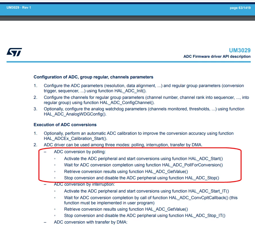

Andrew Neil
July 30, 2024
@Gaston wrote:
In this application I don't want to use DMA or Interrupts
So "Polling", then:

AScha.3
July 30, 2024
just - how i would do it (kiss - Keep it Short and Simple :) )
setup with Cube the ADCx (adc1 if you want) regular conversion , set ch0 and sample time (7.5) , one conversion only.
(short "sequence" ) - gen. code , look at the program:
HAL_ADC_Start(&hadc1, ...)  will convert this channel, ch0 , thats what you want.
But now you want ch4 : so just look, how Cube made the adc_init :
 /** Configure Regular Channel
 sConfig.Channel = ADC_CHANNEL_0;
 sConfig.Rank = ADC_REGULAR_RANK_1;
 sConfig.SingleDiff = ADC_SINGLE_ENDED;
 sConfig.SamplingTime = ADC_SAMPLETIME_7CYCLES_5;
 sConfig.OffsetNumber = ADC_OFFSET_NONE;
 sConfig.Offset = 0;
 if (HAL_ADC_ConfigChannel(&hadc1, &sConfig) != HAL_OK)
 Error_Handler();
For ch4 : so just look, how Cube made the adc_init, copy it, and change it to ch4 .
 ADC_ChannelConfTypeDef sConfig = {0};
 sConfig.Channel = ADC_CHANNEL_4;
 sConfig.Offset = 0;
 Error_Handler();
call/run this then...ch4 is now the"sequence" .
HAL_ADC_Start(&hadc1, ...)  will convert this channel, ch4 , thats what you want now.
And so on...
