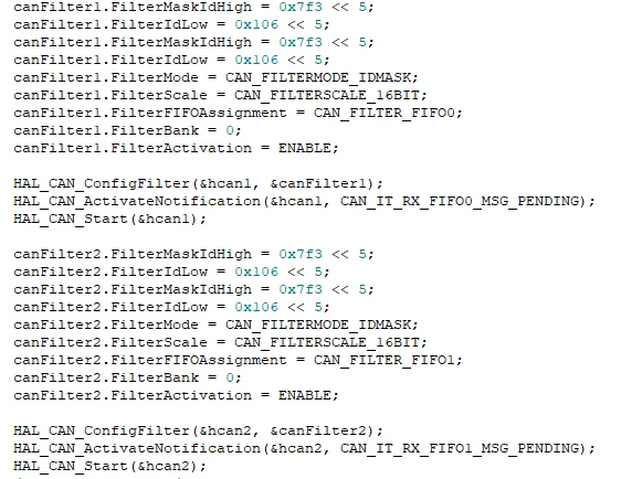

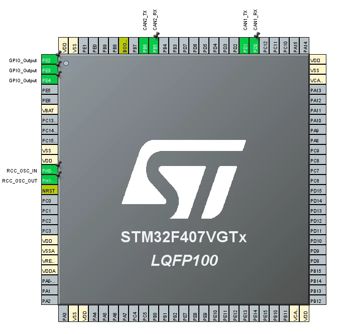

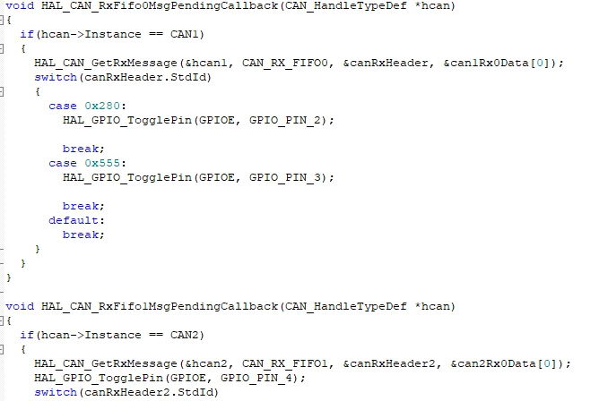

Hello.
I'm currently researching can communication with stm32f407vg
currently, i want to use can1 and can2 at the same time, but only one of them works.​
canfilter is used, and the test is currently in progress through timer interupt.​
maybe the can filter part is wrong, but i couldn't find the answer, so I want to ask for help.
thanks you for your help

KHyun.1
KHyun.1Author
May 20, 2022
0693W00000NqL0SQAV.pngI will share the circuit diagram
Tesla DeLorean
Guru
May 20, 2022
The filter banks need to be split, there are 28 slots, the lower 14 typically to CAN1 and the upper 14 to CAN2, but you can select the mid/split point.

KHyun.1
KHyun.1Author
May 20, 2022
It is determined that the filterbank part is the problem.
There are filterbanks in can1 and can2 respectively.
Only the can that gives 0 to the filterbank value works normally.
I don't understand why..​

Tesla DeLorean
Guru
May 20, 2022
Masking/Compare doesn't strike me as getting ANY hits.
