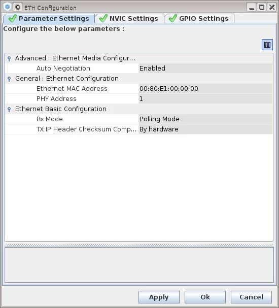

    l239955_stm1
    April 15, 2015
    Posted on April 15, 2015 at 08:59
    I have no experience with stm32f4 and ETH but tool STM32CubeMX generate initialization code for all peripherals that you want to.
    There is window in CubeMX with ETH setting
