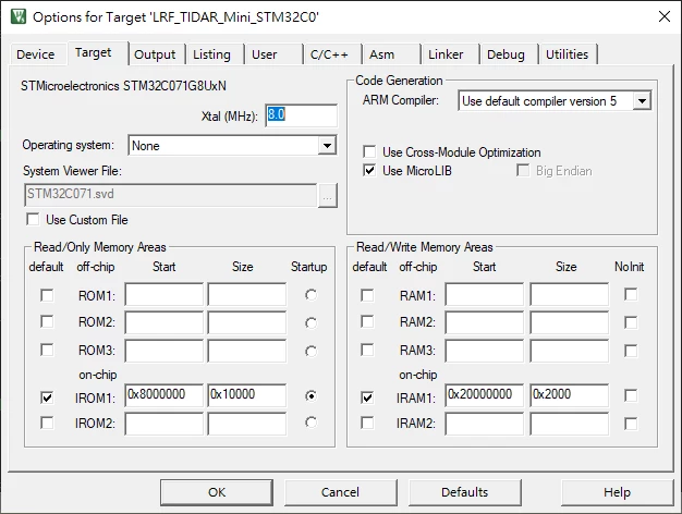

I bought few STM32C071G8U6N from Mouser few month ago.
As I know, the SRAM size in spec is 24K, but I will get error message as below when ZI-data over 8KB
"Error: L6406E: No space in execution regions with .ANY selector matching xxx.o(.bss)."
Program Size: Code=33736 RO-data=360 RW-data=132 ZI-data=6724
And the data in iirDataQueue will change into 8192 or around 65535 unexpected.. Following is my code(work fine on other platform), (iirData is no error).
memmove((uint16_t*)&dspMem.iirDataQueue[0], uint16_t*)&dspMem.iirDataQueue[1],
 (ADC_DATA_QUEUE_LEN - 1) * sizeof(dspMem.iirDataQueue[0]));
dspMem.iirDataQueue[ADC_DATA_QUEUE_LEN - 1] = dspMem.iirData;
We have also been using other series of products for a long time, such as STM32L4, but none of them is as frustrating as STM32C071. Could you please provide me with some direction to debug? Thanks.

Jul 24, 2025 6:59 PM UTC
Seems more as Keil question not STM. Show your sct file or memory config window in project... Spec is irelevant

+1 Check the CPU Target in the project configuration pane (Device & Target)
You can also say the SRAM is bigger, until you get closure with the Linker, and then look at the .MAP to understand who/where/what is consuming it.

Jul 25, 2025 12:46 AM UTC
Thank you, this is my screenshot. The config is generated by CubeMx.

Jul 25, 2025 4:18 AM UTC
Then simply change 0x2000 (8k) to 0x6000 (24k)

Jul 25, 2025 9:22 PM UTC
STM32C0 is a new family, maybe Keil does not have specs for some C0 chips yet. Just correct the values manually. Install updates if available.

Keil loads via a PACK, downloads as a ZIP internally and is unpacked off of c:\KEIL\ARM\PACK
Pretty sure it's correct in the pack(s), could be importing from project settings/instance generated by Cube

Finally,
I found my hierarchical structure definition in .h file can't be handled correctly.
After I flatten the structure definition, no memory error and crash anymore.
