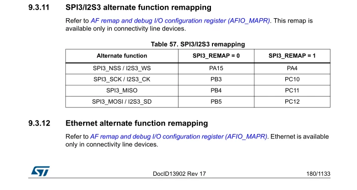

    GPIO_PinRemapConfig(GPIO_Remap_SPI3, ENABLE);
    I don't use 'F1, but looking into RM0008 it appears that SPI3_SCK is at PB3 when SPI3 is *not* remapped.
    Kim Sang Hyouk
    September 8, 2018
    Thank you ~ ^.^  waclawek.jan
    I was  use like this. but work same (no SCK)
     GPIO_PinRemapConfig(GPIO_Remap_SWJ_JTAGDisable, ENABLE);
    // GPIO_PinRemapConfig(GPIO_Remap_SPI3, ENABLE);
    I was use like this. but also  work same (no SCK)
    // GPIO_PinRemapConfig(GPIO_Remap_SWJ_JTAGDisable, ENABLE);
    When I use SPI1 with M95512(EEPROM) than ... It's work...
    But..... change SPI3..... no work...
    Please check it.
    Kim Sang Hyouk
    September 8, 2018
    ​Now Can Work~....
    I change position. end of GPIO Init
