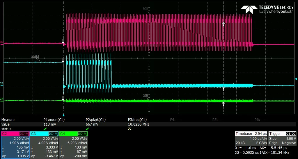

We are trying to implement the SPI interface on a STM32G070 MCU using DMA and no interrupts. MOSI MISO and SCLK all work fine, but the NSS signal does not behave the way we want it to. What we need is a precise change from 1 to 0 signaling the start of the transmission and right after the transmission is finished we need the immediate change from 0 to 1. What do we need to do to get this behavior?
SPI1 registers:
CR1: 0x0105
CR2: 0x1704
SPI and DMA init:

We did some more debugging and found the following:
Using hardware NSS with DMA and NSSP mode enabled, the NSS is handled by the peripheral as expected(See image), just that the NSS is deasserted between the datawords. This is not what we wanted but it's usable, without controlling NSS in software ;).

AScha.3
September 8, 2022
SPI (Motorola/master/hardware out/..) should work;
what is >> LL_SPI_DisableNSSPulseMgt << ?
and is out enabled?
NSS output enable (SSM=0,SSOE = 1): MCU is set as master. The NSS pin is managed .

AScha.3
September 8, 2022
did you look at chip errata?
and >>some STM32 dont support proper NSS << , yes, i had such a problem with STM32F103: had to make NSS in software , because the chip makes no useful NSS modes (must read in manual the details).
waclawek.jan
September 8, 2022
You need to handle NSS in software.

Thanks for your answers. I have now implemented NSS in Software using DMA transaction complete interrupt.

waclawek.jan
September 13, 2022
> The peripheral obviously knows when to stop the SCLK. Based on that it could wait x peripheral clock cycles before NSS is deasserted.
> It works when DMA is disabled!
There is no hardware in the 'G0 (and other STM32, except 'H7) SPI, which would do what you describe.
Software can disable SPI after end of frame - and that's what Cube/HAL does - by setting SPIx_CR1.SPE, and that sets NSS to high-Z. If you have a pullup on that pin, internal or external, it will pull NSS up, with delay depending on the loading (parasitic capacitance) on that line.
The NSS behaviour is described in the Slave select (NSS) pin management subchapter of SPI chapter in RM:
NSS output enable (SSM=0,SSOE = 1): this configuration is only used when the
MCU is set as master. The NSS pin is managed by the hardware. The NSS signal
is driven low as soon as the SPI is enabled in master mode (SPE=1), and is kept
low until the SPI is disabled (SPE =0). A pulse can be generated between
continuous communications if NSS pulse mode is activated (NSSP=1).
I understand your sentiment, and I can imagine way better peripherals in STM32 and not just SPI (which btw. I would pull out not by overcomplicating the existing modules but by rethinking them and adding more and better directed inter-module connections). However, it is as it is, and we have to cope with it.
