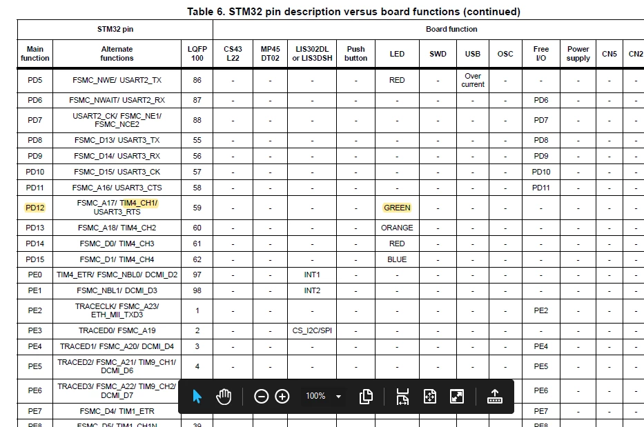

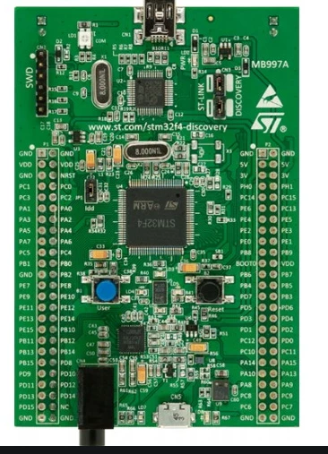

0690X00000AqONDQA3.pngHi,
I am using STM32F4 discovery board. I want to use output compare mode for toggling LED.
So I decided to use Timer4 Channel 1. For discovery board the LED green is connected PD12 pin is connected to LED4: Green .
As per the datasheet, Timer 4 Channel 1 can be used as alternate function for LED green (PD12). So, for the alternate function configuration two registers are there.
AFR[0] (alternate function low register) and AFR[1] (alternate function high register).
How to configure this? What is the exact register value to be placed in this register?
As per my understanding for example to configure USART2 connected to (PA2) as AF7 (alternate function 7) .
The AF7 is the ID of the alternate function mode that you want to set at your PA2.
In fact, you know that the pin enabled for USART2_TX is the PA2 that means Port A - PIN 2
If you see the register GPIOx_AFRL it has 32 bit for 8 pins from 0 ---> 7. You need to assign the PIN2 the alternate function 7 (AF7).
Each pin has a bit field of 4 bits, so to write the AF7 to pin 2 you must write:
0x700. This is the value to be loaded into GPIOA->AFR[0]= 0x0700;
because 0x 7(pin2)0(pin1)0(pin0).
Now How to configure for Timer 4 Channel 1. My query is
to configure PD12 as AF2 I have to load bits as
 0010 0000 0000 0000 0000 0000 0000 0000 0000 0000 0000 0000 0000 - This is for Pin 12 (PD12) as (AF2 hence 0010).
But, the register size has exceeded 32 bits. How to solve this? and what is the correct way to configure the alternate function for Timer 4 channel 1 for PD12 and AF2.
GPIOD->AFR[0]|= ? ;
Here I am attaching related pin descriptions.

> //Set the Direction or Mode register i.e. Input or Output , Here PD12 corresponds to 01
> GPIOD->MODER|=0x01000000; //0b 0000 0001 0000 0000 0000 0000 0000 0000
No, you want to set to Alternate Function mode, that's 0b01 for the given field, ie.
GPIOD->MODER|=0x02000000;
For AFR, the field for pin 12 is in AFR[1]. AF for TIM4 is 2:
GPIOD->AFR[1] |= (2 << ( (12 - 8) * 4)); // AFR[1] contains fields for pins 8..15 hence the offset 8; there are 4 bits per field hence the *4

Oct 15, 2019 6:35 PM UTC
2 stands for AF2, which is the column in which you'll find TIM4_CH1 for PD12 in the Alternate function mapping table in 'F407 datasheet.
12 is for PD12; -8 is because AFR[1] (called AFRH in the RM) stores values starting from Px8, and not starting from Px0.
4 is the number of bits per one Px in AFR[x].

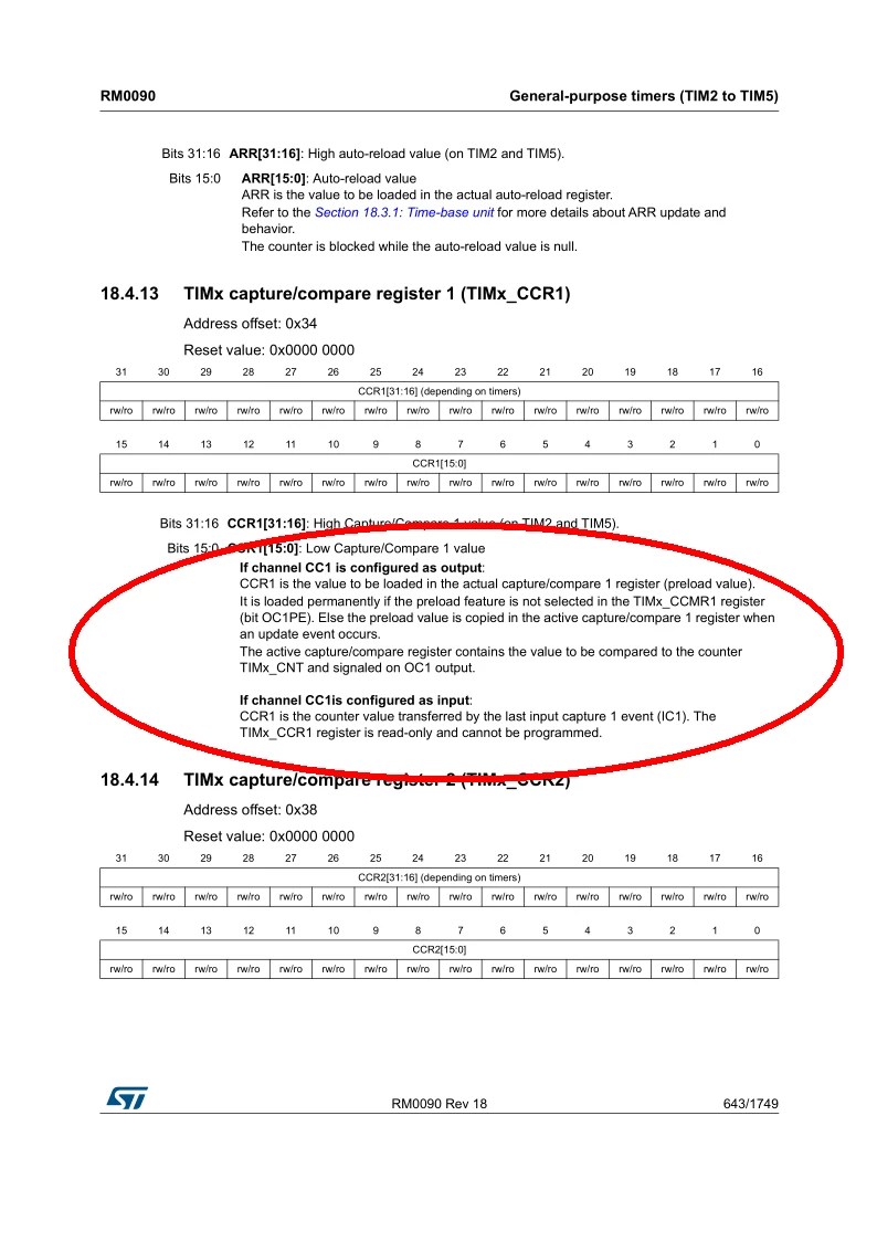

Hi, waclawek,
What is the use of  CCRx Register for the timerx . How to use it and when to use it?
TIM4->CCR1=0; How does this effect?
Can you give an example for this register ?
