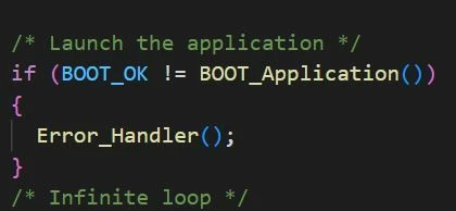

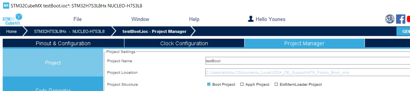

  1. If I use STM32CubeMx to create project.I will get two subproject boot and appli in Stm32CubeIde.Can I just program BOOT project ?
  2. Follow first question . Can I  comment out "if (BOOT_OK !=BOOT_Application())" If I just program BOOT project ,

  1. yes you can only generate the boot project: In the STM32CubeMx --> project manager --> keep the Boot project only.
The boot project will be loaded into the internal flash of 64 K. In general the internal flash is dedicated to boot the application that is loacted into external memories. This is similar to other STM32 platforms where the code is executed from internal flash, but your binary size is limitted to 64 k.
2) Yes you can comment it or replace with while(1) if you plan to use the internal flash only. You may also to delete the extra code related to XSPI config or unused peripherals in your boot project.

1~2 question is done.I get a boot project and without ext flash.
