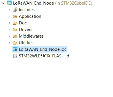

How to use MX to avoid destroy of code

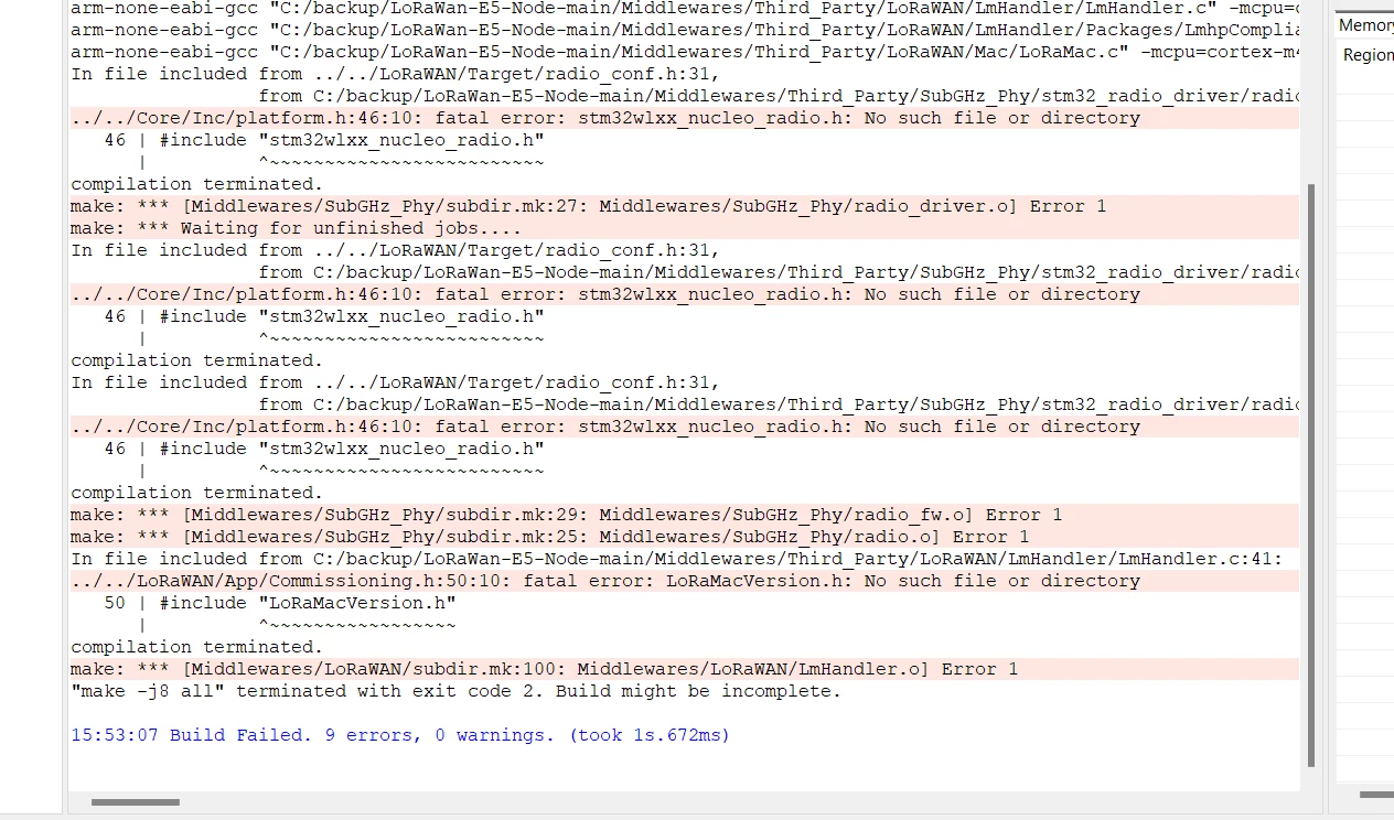

I downloaded Seeed-Studio LoRaWan-E5-Node, and all works fine till I use the MX component to set up microcontroller configuration (for example, set up LoraWAN or I2C). When I use the MX component and decide to generate code after changes to LoraWAN or I2C components, I always get many build errors. How to avoid such a situation?
I work with STM32CubeIDE Version: 1.14.0. Stm32 Cube MX version 6.10.0.

Only put code within USER CODE BEGIN and USER CODE END sections.

No, it destroys its code, not mine. I downloaded the code from Seeds Studio Git Hub.
I imported the project to the Stm32CubeIDE:
Next, I imported it into Stm32CudeIDE. I built it without any problems or any changes.

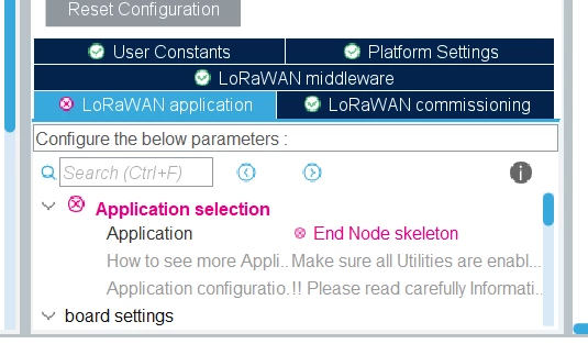

Next, I opened the MX component and made some changes to the microcontroller configuration. I double-clicked on the LoRaWAN_End_Node.ico, and made changes to the LORAWAN settings.

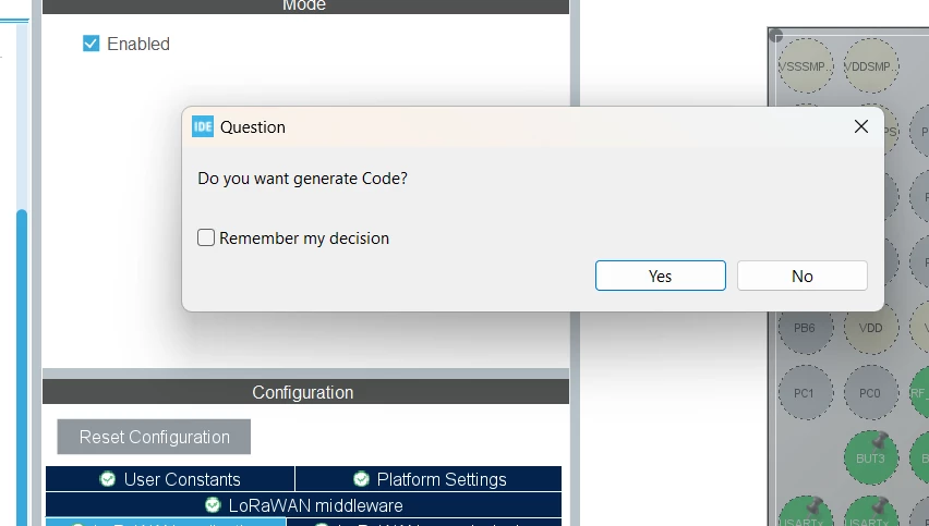

Upon closing the MX component, it asked me to generate code. I answered yes.
I tried to build the project, and I got several unexpected build errors.
I didn't do any manual changes to the code.
What is responsible for that situation?

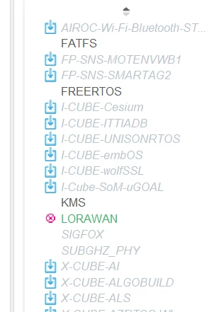

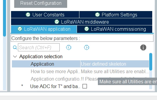

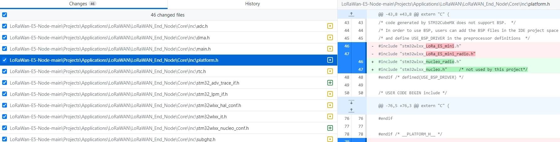

After saving code from MX I see:
Dec 12, 2023 4:09 PM UTC
Not real sure, probably just isn't set up for that functionality right now.

markpowAuthorBest answer
Senior
Dec 16, 2023 8:20 PM UTC
I found a solution. Download the latest "https://github.com/STMicroelectronics/STM32CubeWL" and use the LoraWAN end node application. All work great now.
