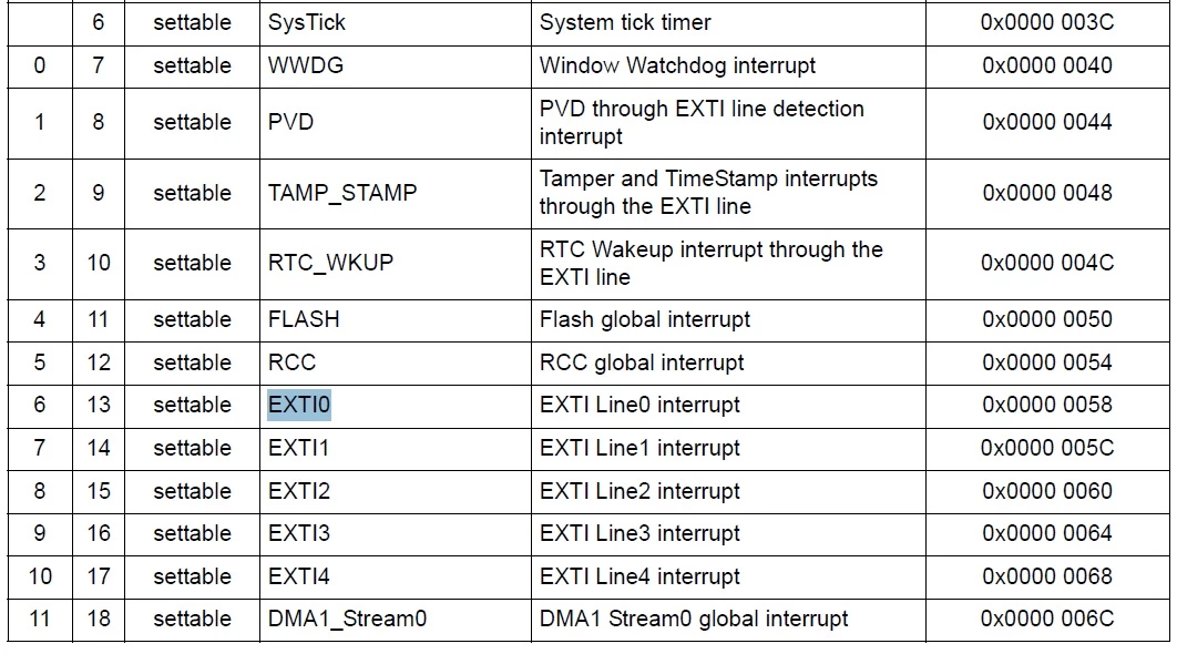

In Cortex m3/m4, Interrupt Set Enable Registers is used to enable/disable the interrupts. How would we know which bit corresponds to which interrupt?

The NVIC interrupts are implementation specific (ie ST, ATMEL, NXP, etc), so look at the Reference Manual for the part you are using.
Review Vector Table, there is a linear application of bits and registers within the NVIC
So EXTI0 is interrupt #6

So this means if I want to enable hardfault and memManage Fault, which is interrupt no. 3 and 4 according to
http://infocenter.arm.com/help/index.jsp?topic=/com.arm.doc.dui0553a/BABIFJFG.html
, ,I can simply do this,
♯ define NVIC_ISER (*((volatile unsigned long*) 0xE000E100))
NVIC_ISER = 0x00000018, // Interrupt set enable register
Right?

No, they are SYSTEM EXCEPTIONS, not INTERRUPTS (IRQs)
The IRQs are in the NVIC, the System Exceptions are not. In the table above IRQ ♯ 0 is WWDG, IRQ ♯ 3 is RTC_WKUP
http://infocenter.arm.com/help/topic/com.arm.doc.dui0553a/Cihhjgdh.html
Use SCB->SHSCR |= (1 << 16); to enable the Memory Manager
Would suggest ORing new bits on to registers rather than assuming initial/current content
