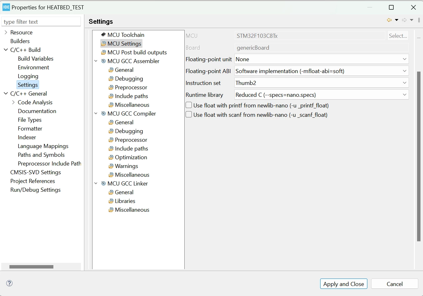

    AScha.3
    February 23, 2024
    you can set it in IDE : menu -> project -> properties ...
    set software ... -  to use floating lib here.

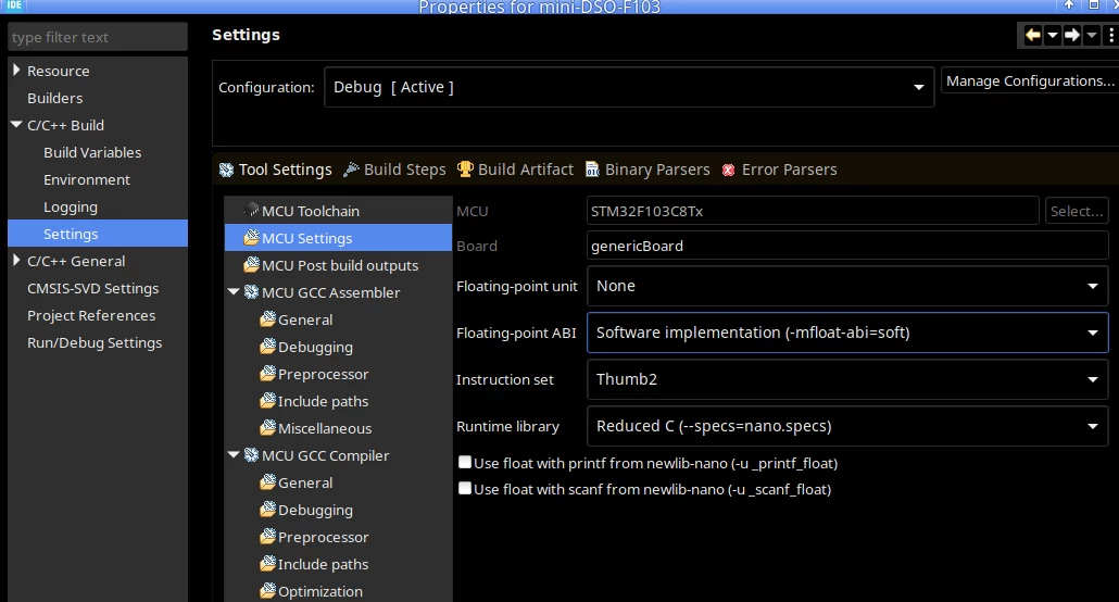

    May 31, 2024
    Sorry for late response. I stuck into another problems not related to this.

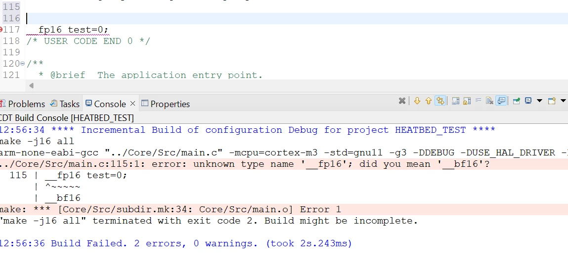

    But still I cannot able to resolve this problem of using float16. I have same setting as you suggested. I have attached a screenshoot of the window.
     I tried to declare the variable like __fp16. but it does not work. I get the following error:
    Did I missing something any library , compilar setting others?
    I need this setting for enabling custom deep learning model on stm32 MCUs to save memory for weights. Any help from side will apreciated and will be very helpful.
    Thank you
