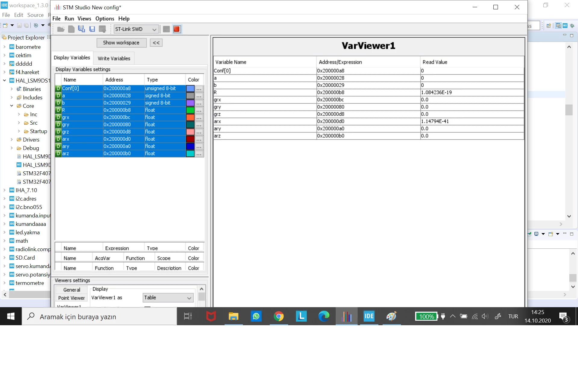

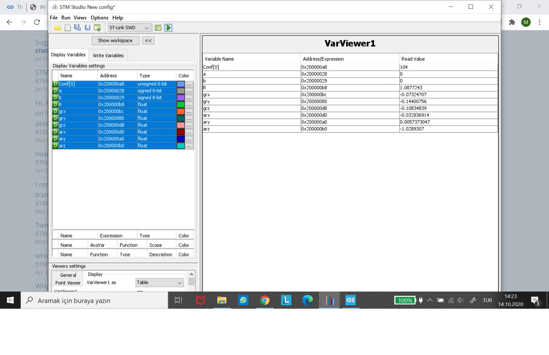

Hi everyone! I am using STM32F4 and IMU to read gyro and accelerometer, and than calculate IMU's euler angles. I can get data from IMU it is OK but when I try to add something from math.h program stops working but it also don't gives error or warninng -I can't even read acceleration and gyro data in STM Studio-. I need to use sqrtf() and acosf() functions. I think I am using math.h library in wrong way. Here is my codes math.h related parts:
#include <math.h>
 while (1)
  /* USER CODE END WHILE */
  /* USER CODE BEGIN 3 */
G_Read(0x18, 6);
 // (msb<<8) | lsb
 gx= (Gyro[1]<<8)| Gyro[0];
 gy= (Gyro[3]<<8)| Gyro[2];
 gz= (Gyro[5]<<8)| Gyro[4];
 A_Read(0x28, 6);
 ax=(Accel[1]<<8)| Accel[0];
 ay=(Accel[3]<<8)| Accel[2];
 az=(Accel[5]<<8)| Accel[4];
 HAL_Delay(30);
 grx= gx*(245.0/32768.0);
 gry= gy*(245.0/32768.0);
 grz= gz*(245.0/32768.0);
 arx=ax*(2.0/32768.0);
 ary=ay*(2.0/32768.0);
 arz=az*(2.0/32768.0);
 grx=grx-1.12;
 gry=gry-0.63;
 grz=grz+1.23;
 HAL_Delay(30);
 R=arx*arx+ary*ary+arz*arz;
//if I make bottom part comment program works as it will but if I don't it don't :(
R=sqrtf(R);
 HAL_Delay(30);
 aanx= acosf(arx/R);
 aany= acosf(ary/R);
 aanz= acosf(arz/R);
 HAL_Delay(30);
Here is the results with math.h and without math.h:

MDoğr.1Best answer
Oct 15, 2020 9:05 AM UTC
I changed pins pb7 pb6 to pb9 pb8 and it started to work welll
