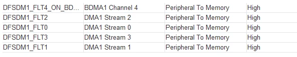

I am trying to read signals from digital MEMS microphones via DFSDM peripheral and transfer it to memory with DMA on STM32H7A3. I found out that 4 channels are handled by DMA and remaining 4 with BDMA. Now I can't figure out how to get this BDMA to work.
Below I placed screenshots of Cube configuration and initialization of DFSDM with DMA. I suspect that the problem can be with memory configuration in linker script, since DMA and BDMA has not access to the same memory sections. Do someone have idea if my assumptions are correct and can suggest what should I do to get it to work?

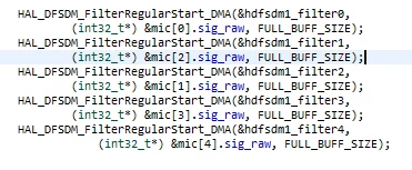

Now I'm wondering if transfer via BDMA requires some different kind of handling. Because now even though I configured it in Circular Mode, BDMA1_IRQHandler fires only once.
Now I'm starting all channels with the same HAL function (filter 0,1,2,3 uses DMA and filter 4 uses BDMA).
HAL_DFSDM_FilterRegularStart_DMA(&hdfsdm1_filter0,
			(int32_t*) &mic[0].sig_raw, FULL_BUFF_SIZE);
HAL_DFSDM_FilterRegularStart_DMA(&hdfsdm1_filter1,
			(int32_t*) &mic[1].sig_raw, FULL_BUFF_SIZE);
HAL_DFSDM_FilterRegularStart_DMA(&hdfsdm1_filter2,
			(int32_t*) &mic[2].sig_raw, FULL_BUFF_SIZE);
HAL_DFSDM_FilterRegularStart_DMA(&hdfsdm1_filter3,
			(int32_t*) &mic[3].sig_raw, FULL_BUFF_SIZE);
HAL_DFSDM_FilterRegularStart_DMA(&hdfsdm1_filter4,
			(int32_t*) &mic[4].sig_raw, FULL_BUFF_SIZE);

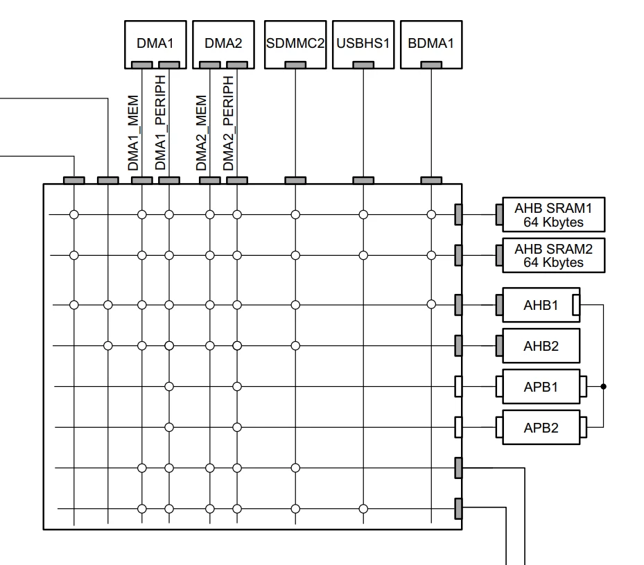

According to the reference manual, "AHB SRAM1 is accessible by all system masters except BDMA through D2 domain AHB matrix." (p135)
Therefore, I don't think that the use of AHB SRAM1 is a good choice.

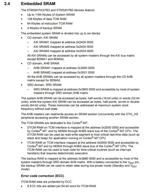

I can't find such info in the reference manual you linked for my MCU - STM32H7A3.
Here is page 135 from this manual.
From this words:
"embedded system SRAM is divided into up to six blocks:
• CD domain, AXI SRAM:
– AXI SRAM1 mapped at address 0x2400 0000
– AXI SRAM2 mapped at address 0x2404 0000
– AXI SRAM3 mapped at address 0x240A 0000
All AXI SRAMs can be accessed by all system masters through the AXI bus matrix except BDMA1 and BDMA2.
• CD domain, AHB SRAM:
– AHB SRAM1 mapped at address 0x3000 0000
– AHB SRAM2 mapped at address 0x3001 0000
All the AHB SRAMs can be accessed by all system masters through the CD AHB matrix except for BDMA2."
I deduced that I should put data in AHB SRAM, as I am using BDMA1.
Statement you just mentioned "AHB SRAM1 is accessible by all system masters except BDMA through D2 domain AHB matrix." I could find in the reference manual for MCU - STM32H750VBT6.
