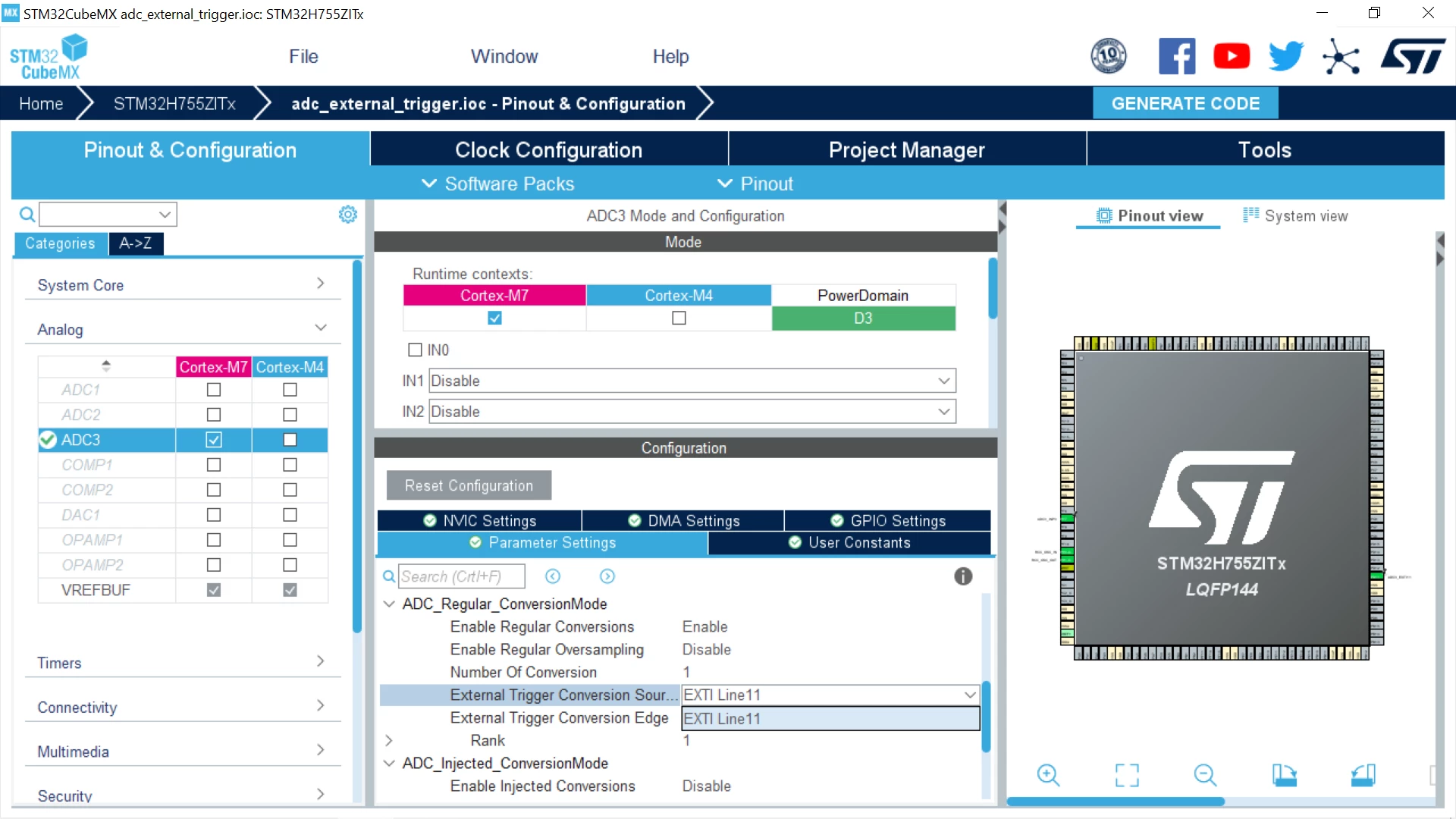

As the title says, I need to use the ADC's external trigger designator pin to trigger the transition. I have done the necessary steps on Cubemx but my code still cannot work.
Looking forward to hearing from the forum.
Thanks,
HAILV

 hadc3.Instance = ADC3;
 hadc3.Init.ClockPrescaler = ADC_CLOCK_ASYNC_DIV6;
 hadc3.Init.Resolution = ADC_RESOLUTION_14B;
 hadc3.Init.ScanConvMode = ADC_SCAN_DISABLE;
 hadc3.Init.EOCSelection = ADC_EOC_SINGLE_CONV;
 hadc3.Init.LowPowerAutoWait = DISABLE;
 hadc3.Init.ContinuousConvMode = DISABLE;
 hadc3.Init.NbrOfConversion = 1;
 hadc3.Init.DiscontinuousConvMode = DISABLE;
 hadc3.Init.ExternalTrigConv = ADC_EXTERNALTRIG_EXT_IT11;
 hadc3.Init.ExternalTrigConvEdge = ADC_EXTERNALTRIGCONVEDGE_RISING;
 hadc3.Init.ConversionDataManagement = ADC_CONVERSIONDATA_DR;
 hadc3.Init.Overrun = ADC_OVR_DATA_OVERWRITTEN;
 hadc3.Init.LeftBitShift = ADC_LEFTBITSHIFT_NONE;
 hadc3.Init.OversamplingMode = DISABLE;
 if (HAL_ADC_Init(&hadc3) != HAL_OK)
 Error_Handler();

1 reply
Foued_KH
April 26, 2023
Hello @Ru?i​ ,
First we need to enable continuous conversion mode otherwise after single conversion, ADC will stop and we have to restart it.
Also make sure you enable the interrupt in the NVIC tab.
 I think you have the same issue reported in this thread.
Foued
