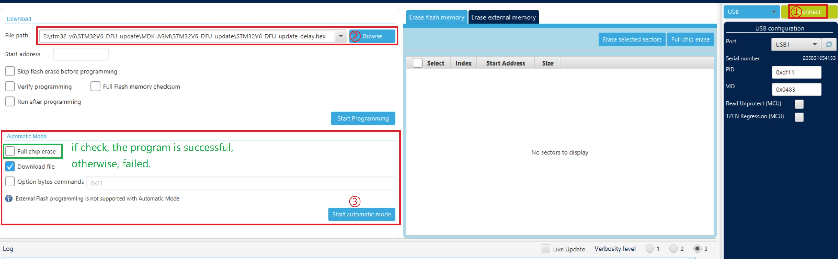

I am verifying the USB DFU bootloader in STM32F429BI.
I can normally enter the bootloader and connect my MCU using stm32CubeProg.
I can succeed in the program flash when I check the "Full Chip erase" option, otherwise, it will fail sometimes(see the LOG in the attachment)!
But if "Full Chip erase", it needs a bit long time. Can I erase the sector when needed only?
One more, each time I flash the program, I must reset the MCU by hand, can I set the MCU to auto-reset after download?
Thanks for your help.

I have generated "hex1" and "hex2" for testing. (The difference at line 39-40)
When I check the "Full Chip erase", both "hex1" to "hex2" and "hex2" to "hex1" are OK;
But when I don't check the "Full Chip erase", only "hex2" to "hex1" is successful, and "hex1" to "hex2" failed. (This means "delay to DELAY" failed, "DELAY to delay" successed)

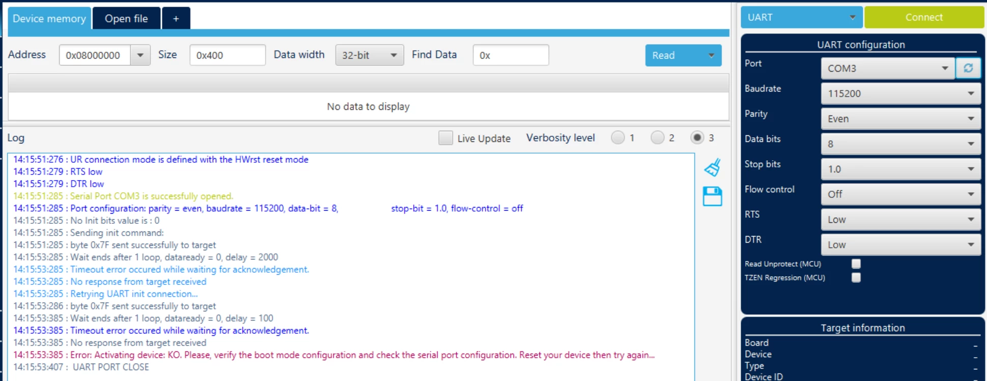

I am trying to connect the bootloader by UART in stm32cubeProg, but it failed... The steps are as follows:
    1. pull boot0 high;
    2. click the connect button in stm32cubeProg;
    3. reset the MCU, then some error message in the attachment;
I can enter the UART bootloader by serial assistant as following steps:
    1. open the serial assistant and keep sending 0x7F;
    2. pull boot0 high;
    3. reset the MCU;
    4. the serial assistant can receive 0x79 0x1F 0x1F....
