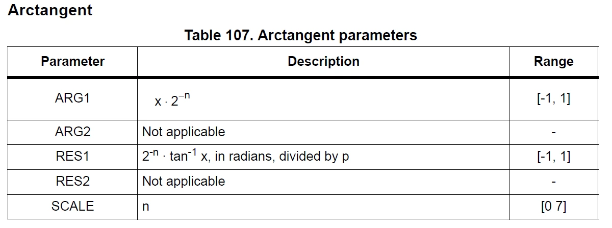

How to understand the sacle factor of stm32g4 cordic algorithm? For example,i use the cordic algorithm to calculate Arctangent,but i don't understand why ARG1 is x*2^-n, RES1 is 2^-n *tan^-1 x .I think the correct result is tan^-1(x*2^-n),
