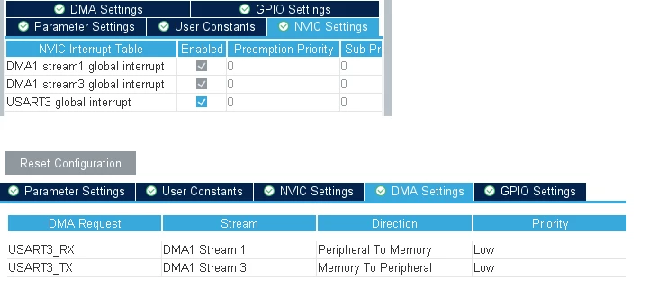

Enabled DMA in CubeMX settings to transfer data via UART.
But I don't see any difference at all between non-DMA functions and DMA functions.
I don't think it's important, but I use this code:
Transferring characters from the COM port to the STM32 and returning these characters back to the COM port.
uint8_t arr[10]={0};
void HAL_UARTEx_RxEventCallback(UART_HandleTypeDef *huart, uint16_t Size)
if(huart->RxState==HAL_UART_STATE_READY)
HAL_UART_Transmit_DMA(&huart3, arr, Size);
HAL_UARTEx_ReceiveToIdle_DMA(&huart3, arr, 5);
int main()
The code works. But how to understand that data is transmitted via DMA?
Yes, there is DMA in the function names.
I need proof, if I may say so, that the data is transferred via DMA.
