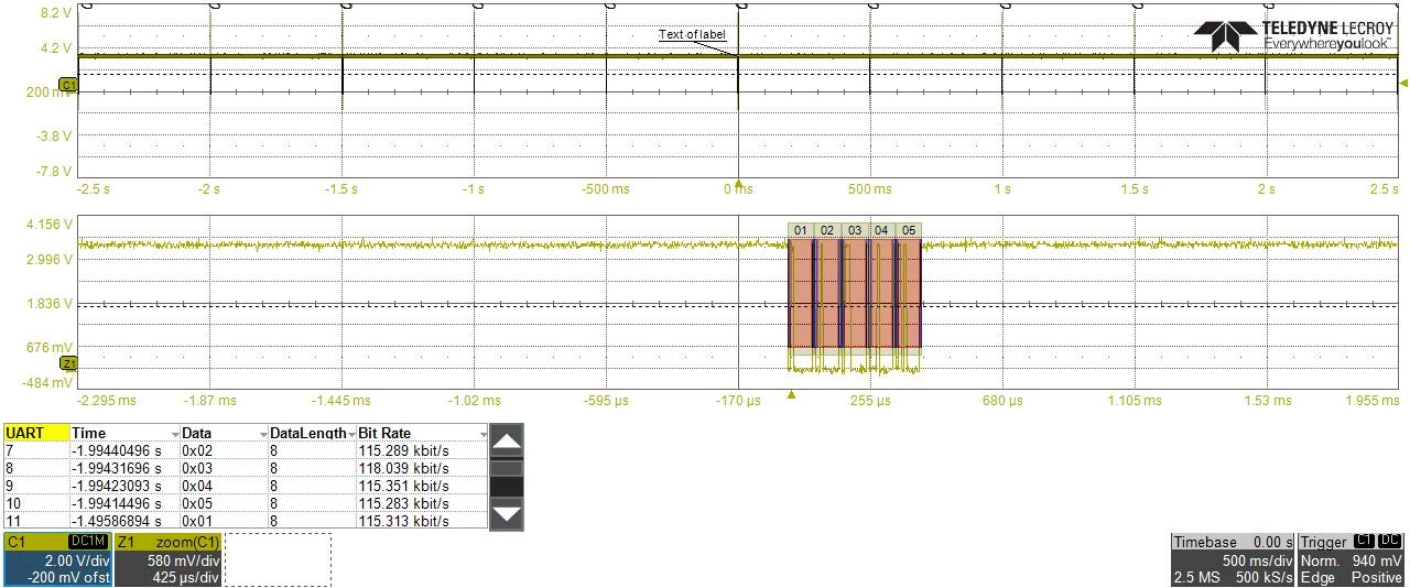

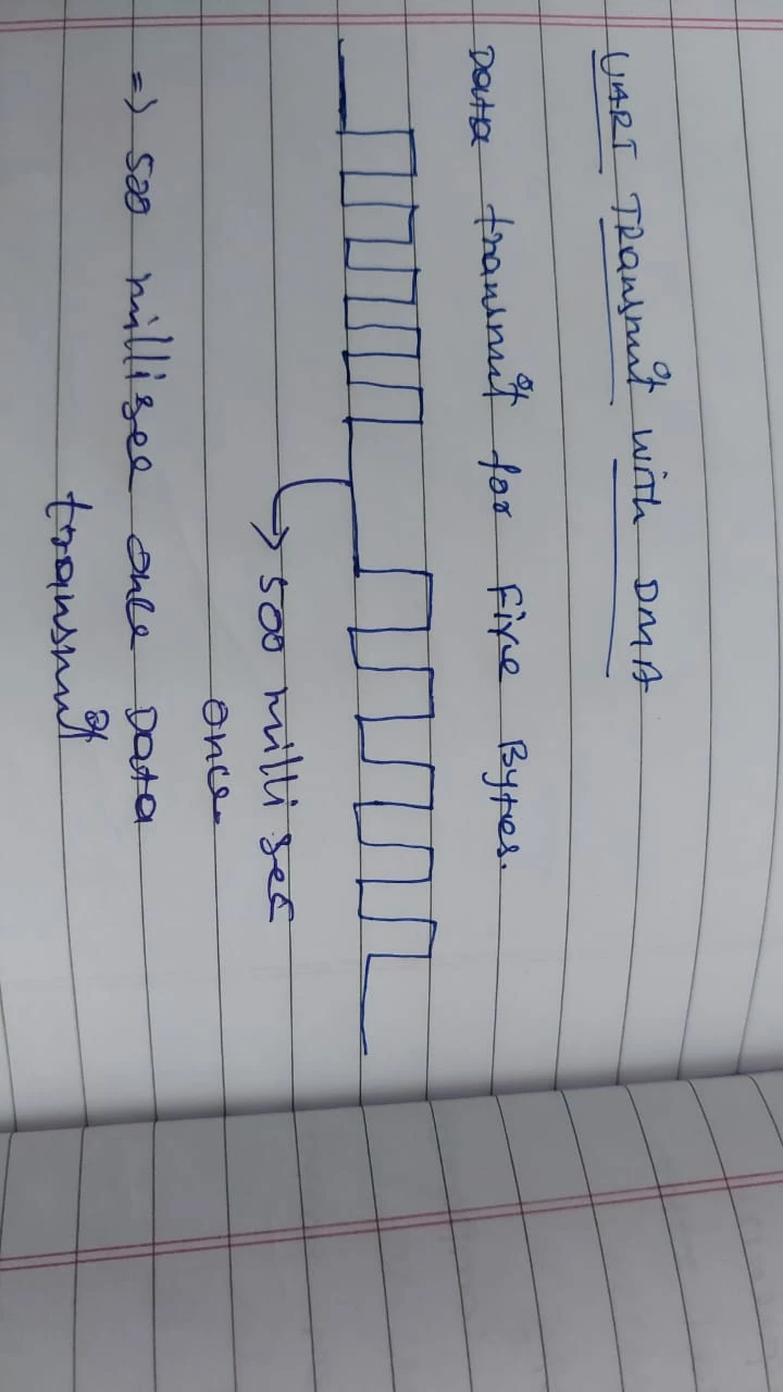

I already try for send five byte data in UART DMA. I am using the controller in STM32G030K6T6. Data transmition is working properly but output is did not taken properly. The problem was am transmit data five bytes for UART_DMA but DMA transmit only two bytes data. HAL_UART_Transmit_DMA call in timer interrupt handler to check the output for just now. The output is came but this is not proper output. this method for just call in to the interrupt handler output is continuously came for five bytes data. I need a output for 500 millisec once Five Bytes data transmit.  I attach the output for picture and code. please tell what can I do for next step.

yes, I want to send 5 bytes wit UART and DMA, then wait a delay 500 ms. if you know guide me.

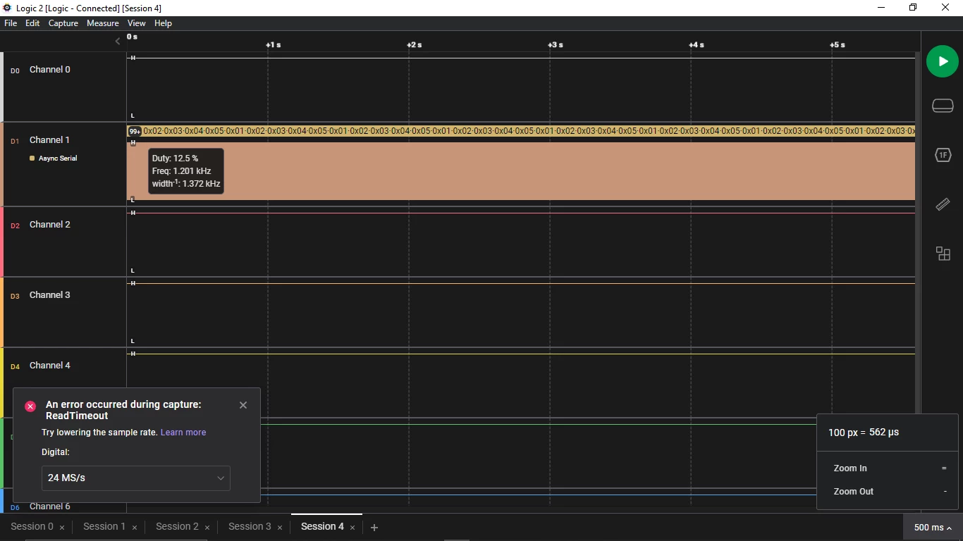

mrsmile
mrsmileAuthor
June 6, 2023
How can I generate (HAL_GetTick() - prevTick ) > 500 this delay. out is continuously send the data.

RomainR.
June 6, 2023
This delay is generated by cpu CM0 Systick Timer and it is normally enabled when you generate a STM32CubeMX project.
The Systick is configured by HAL_Init() below to generate an interrupt every ms.
Do you use STM32CubeMX, STM32G0 HAL library?
In other case, share your full code.

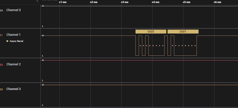

mrsmile
mrsmileAuthor
June 6, 2023
ok I will share. how initialize prevtick variable and condition can not enter the uart call back function. flag is not enable.

Here back a working solution. I tested it on STM32G030 and I get array buffer bytes every 500ms.
In your initial USART_ChecK, the Systick interrupt never happens. I don't know why?
Let try it and let me know ?
Best regards,
Romain,
RomainR.
June 6, 2023
I join as an attachment a capture using oscilloscope.
C1: Is the USART2 DMA transfer each 500ms (small vertical yellow line each 500ms) corresponding to HAL_UART_Transmit_DMA()
And
Z1: Is zoom window of one vertical yellow line, it shows the bytes array transmitted.
