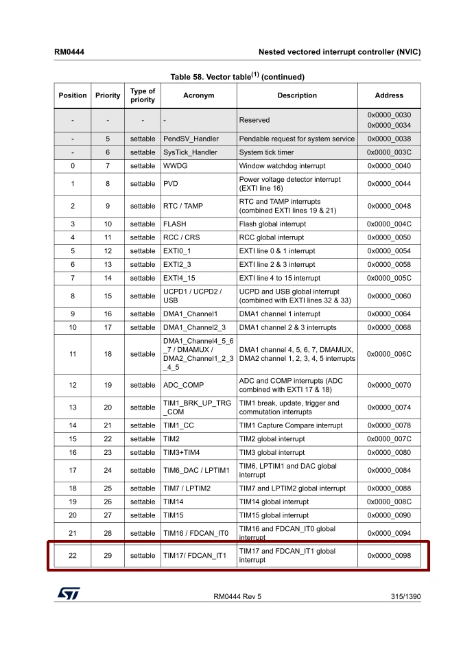

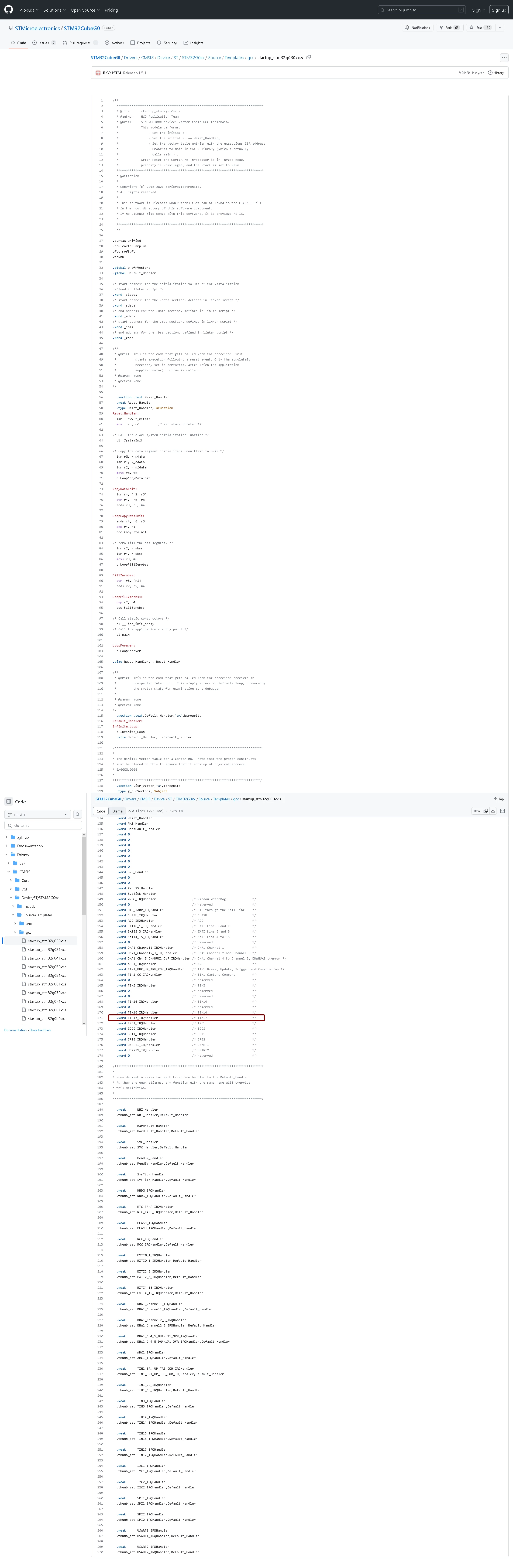

> I am looking for the interrupt function related to the duty setting registry
Where do you look for it?
It's screenshot of the startup code, clicking on it it will bring you to the highlighted line, which is the item in vector table - you are supposed to write an ISR with that name.
