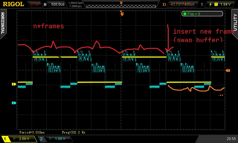

Things are more or less synchronised but now there is a wait period which is not wanted and also there still seems to be a little glitching.
So my new question is:
Is there an equivalent callback for the start of DAC like HAL_DAC_CH1_COMPLETE_CB_ID?
A sort of HAL_DAC_CH1_BEGIN_CB_ID
My intention is to swap a DMA buffer at the exact time a DMA Cyclical buffer ends writing it's sequence to the DAC. I want a seamless transition from writing the last DAC value out to the writing a new sequence (buffer) to the DAC... The buffer needs to be swapped at unpredictable times and has varying lengths.
In other words I want to commit the swap once the DAC has written the last value of n cycles and immediately after that.
viz the function - swap_buffer:

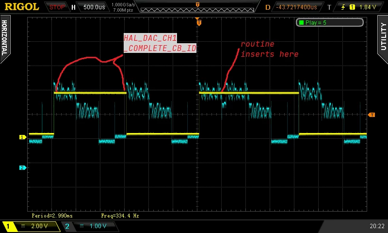

The stream consistently repeats until the swap_buffer function executes. This glitches the DAC pulse.
When observing the DAC output under an oscilloscope. the function seems to cut off a pending DMA cycle
 Current result...
Intended result:
Another Edit: (to remove the delay I placed the swap routine into the callback.. This presents other problems. Chiefly the main routine could request 2 swaps whilst the DMA is being

Thanks for the advice. Unfortunately the buffer size is variable and to complicate matters further the buffer cycles. If I were to introduce half the buffer into the last cycle I would still need to stop and start the DAC/DMA to change the buffer length...:(
I do admit though that the glitching is now probably purely down to this resetting of the DAC/DMA. It's pretty quick and barely noticeable for my needs (it a visual application and persistence of vision and our eyes slow refresh rates make it almost ideal so far...). I think the biggest problem is the delay waiting for the last cycle to end so that the buffer can be swapped...
I think I've improved it a tad by putting the swap routine into the Callback and setting a swap flag in the main routine that notifies the Callback to swap the buffer...

December 7, 2022
You can't change the length of the DMA buffer without disabling and re-enabling the DMA. Doing so will have the possibility of missing values as you cannot respond instantly to the DMA completion event. You can get close, maybe a few us, but not instant.
One way of driving the DAC with varying inputs is to generate them on the fly in a circular buffer or with interrupts, although this will not be computationally feasible at the highest DAC update rates.
December 7, 2022
Thanks TDK, That's exactly as I'm observing. I have am also using the onchip OPamp as output - what I have done to mitigate the delay affecting the output gltich is to disable the opamp also and set the output to digital set low and to zero before returning to analog and opamp output. This removes some of the glitching...
