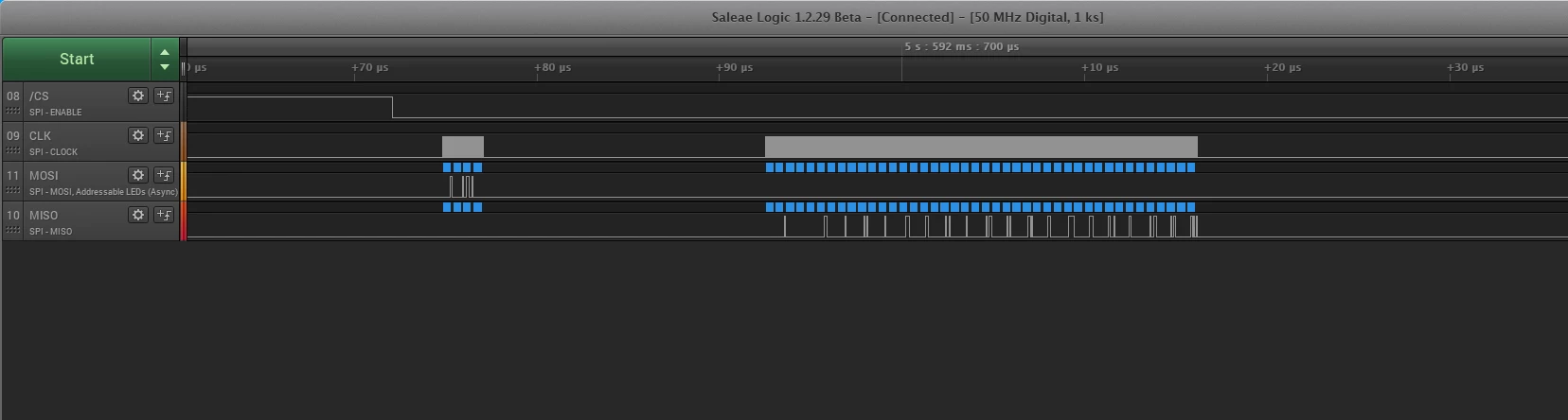

Sometimes, everything goes a little wrong - the process stops reading while in the middle of HAL_SPI_Receive_IT transaction, for example I know that the job was 96x 16-bit words and hspi->Instance->RxXferSize == 96, hspi->Instance->RxXferCount == 72, 42 bytes have been read (or 21x 16-bit words) or I change the prescaler and I get clock stretching on the transmit read command on the address.
I'm pretty certain that the __disable_irq() and __enable_irq() calls are the culprits that surround the five operations in my job adding function and I would like to know suggestions for a better way to do this. The global interrupt handling was added as I was fairly confident that a completion interrupt was being triggered whilst the control was within this block, causing the processIndex to be reset while the jobIndex retained value. However, this method is probably overkill and is likely the cause to the SPI transaction stalling.

Ok, after much reading and debugging, which is somewhat erratic tracing interrupts through code, I think I've found the solution that I'll share for other people out there.
Using the HAL_SPI_Receive_IT() would appear far from ideal; I'm running it at 15 MHz with a 480 MHz core clock suggesting that instead of the final interrupt at the end that I'm expecting, it is in fact generating some 1,875,000 interrupts / second - every byte. I learned this after finally finding the SPI interrupt fault code (SPI_SR_OVR / SPI_IT_OVR or overrun flag set) that is similarly discussed in https://community.st.com/s/question/0D50X0000C3Aein/overrun-flag-when-using-spi-in-interrupt-mode-halspireceiveit
The solution for now would seem to use blocking mode to move things along while we explore DMA and possibly more enhanced possibilities from QSPI.
