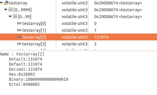

Hello, I'm using the STM32746G Discovery Board to familiarize myself with the ST environment. Now I simply wanted to store a 32Bit value in the RAM, and had several problems with the Cube BSP drivers. I tested the functions with the following code:
#define SDRAM_OFFSET ((uint32_t)0xC0100000)
for(uint32_t i=0; i<0x10010; i++){
	BSP_SDRAM_WriteData(SDRAM_OFFSET+i*4,(uint32_t *)&i,1);
	testarray[i]= 0;
if(SDRAM_OK != BSP_SDRAM_ReadData(SDRAM_OFFSET+i*4,(uint32_t *)(&testarray[i]),1)){
	testarray[i] = 111111;
In the debugger it then looks like this:
Sometimes the transfer works. Sometimes the higher bits are incorrect.
How do I use the function to make it work?

    As in many examples I found online the clocks are configured with a function void SystemClock_Config(void). To make the display work, I copied the function from an example. It caused the error in the SD-Ram write process. As I read from the comments, the SD-RAM can be operated up to a system clock of 200MHz. If I understood it correctly, mine has been set to 216MHz. Now I have the following clock configuration function:

    To make the diplay and RAM work, I changed the RCC_OscInitStruct.PLL.PLLN from 400 to 380. I guess more or less: PLLN = 400: 216MHz, so PLLN=380: 200MHz.

    Tesla DeLorean
    Guru
    Jan 15, 2019 2:02 PM UTC
    testarray is in Internal SRAM
    0x10010 is significantly larger than 10000 decimal (0..9999)
    SDRAM writes like other memory, you could just use a pointer.

    After trying for hours, it looks like I've found a solution. I found in the file: stm32746g_discovery_sdram.h the macro: SDRAM_MEMORY_WIDTH
    I changed it from FMC_SDRAM_MEM_BUS_WIDTH_16 to FMC_SDRAM_MEM_BUS_WIDTH_8.
    I have no idea what I did, but in any case the read-write check works now. Let's see what else awaits me. If someone can explain to me what I have changed there exactly, I am curious.

    Thank you for you check! Your code does not work in my case. I updated also the BSP Drivers from STM32Cube FW V1.12.0 to V1.14.0 without improvement.
    Could it be due to a different compiler? I use GNU MCU Eclipse ARM Embedded GCC (arm-none-eabi-gcc). Or the clock configuration? That's the only thing I call up before the test, and in my understanding could influence the SD-RAM.
    Or the RAM is damaged, which I can hardly imagine.

    Okay, I think I'm getting closer to the problem. Obviously the problem is with the clock configuration. I'll look into it more closely and let you know better. Thank you very much for your help Clive Two.Zero.

    Tesla DeLorean
    Guru
    Jan 16, 2019 1:00 PM UTC
    Clocks and other pin usage would be prime suspects.​
