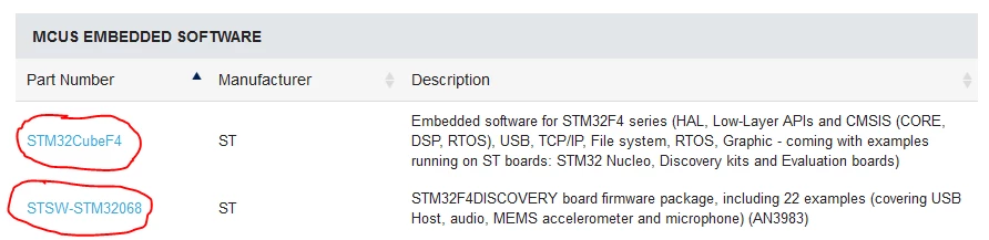

Vangelis Fortounas
August 27, 2017
Posted on August 27, 2017 at 14:57
Hello!
you can go to
https://my.st.com/content/my_st_com/en/products/evaluation-tools/product-evaluation-tools/mcu-eval-tools/stm32-mcu-eval-tools/stm32-mcu-discovery-kits/stm32f4discovery.html
page and to download the firmware package alone and as optional,  the STM32Cube to produce initialization code for IAR EWARM.0690X000006081fQAA.png
