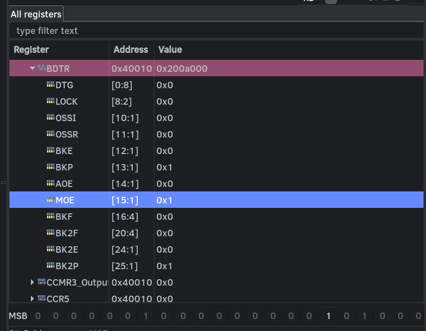

Thank you for the response! I have set the necessary values in the register TIM1->BDTR->MOI.
But still, nothing is working!
The same settings work when using the HAL library! However, I'm not able to get it to work with the registers!

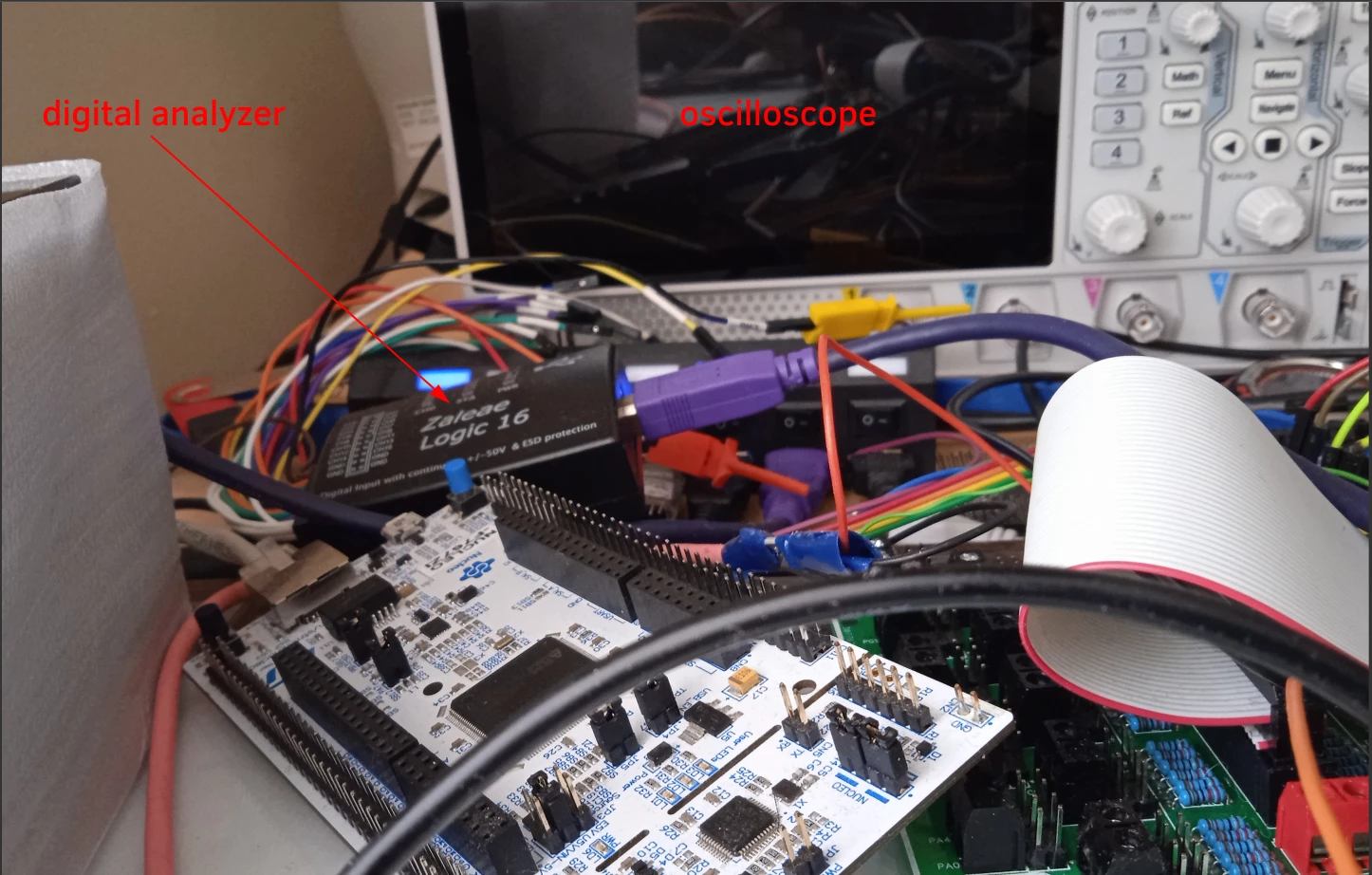

I checked it with a digital analyzer and an oscilloscope, see photo! The result is no signal with the same behavior on both devices.
I have a regular NUCLEO-F767ZI board that works perfectly if I create a project using the HAL library. However, when I try to implement a similar project using only registers, nothing works!1.png
