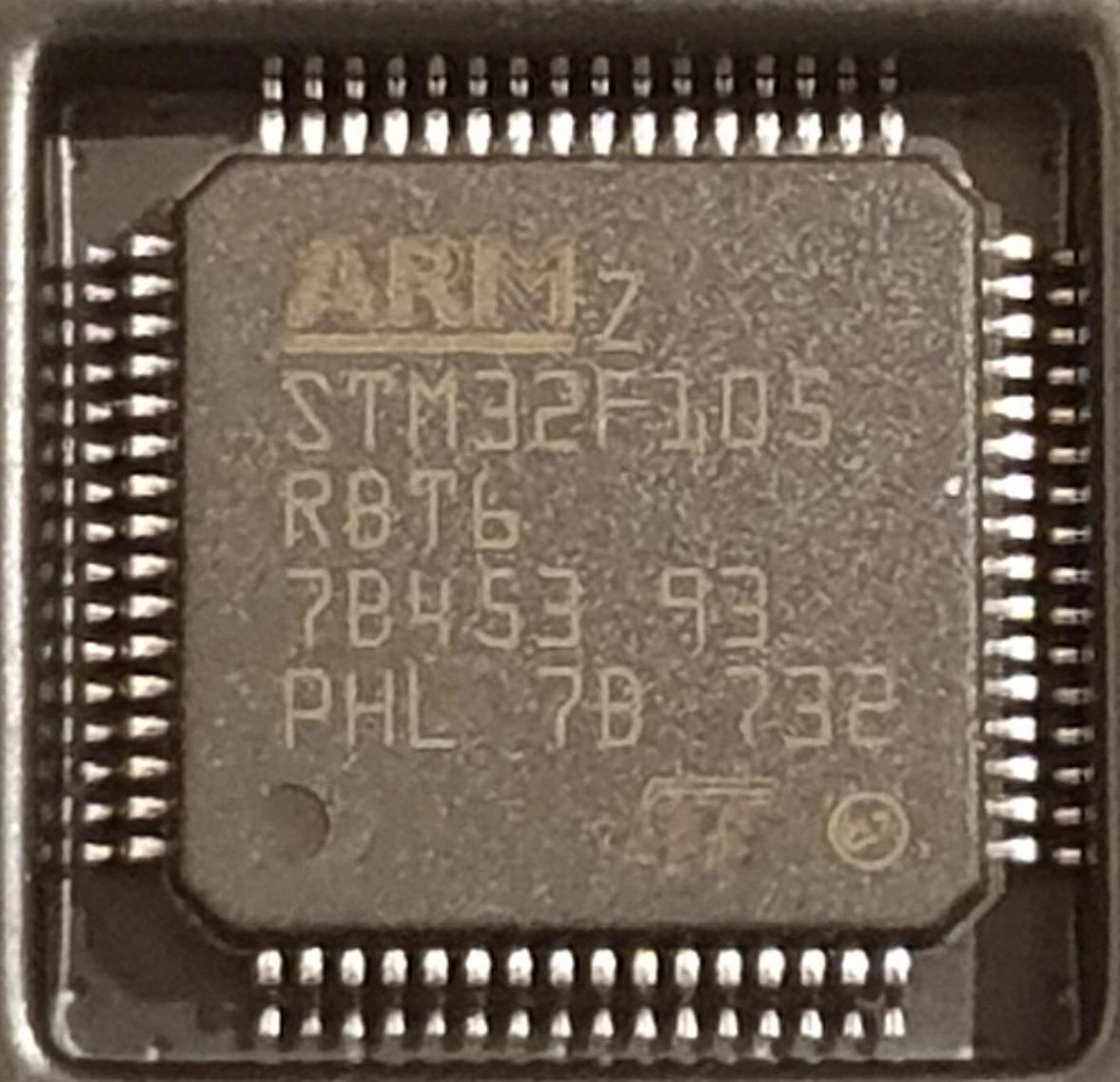

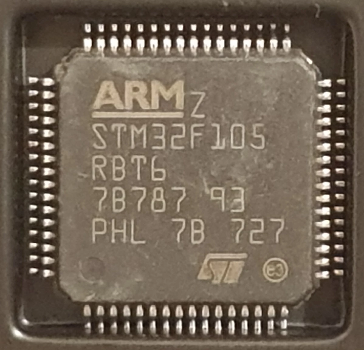

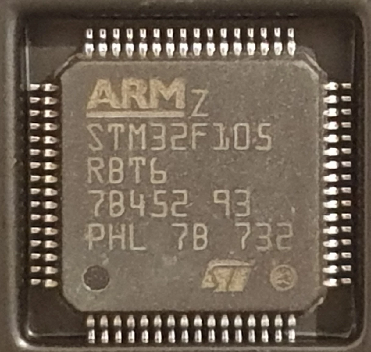

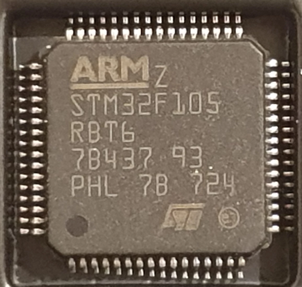

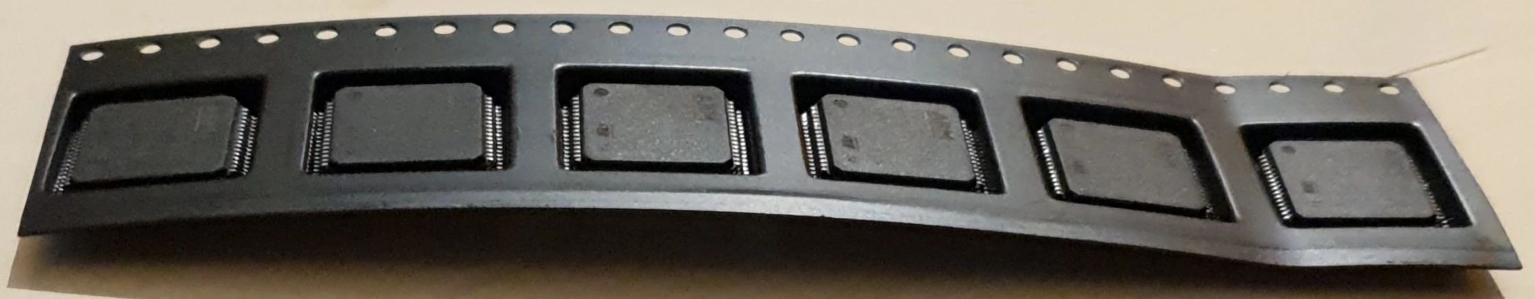

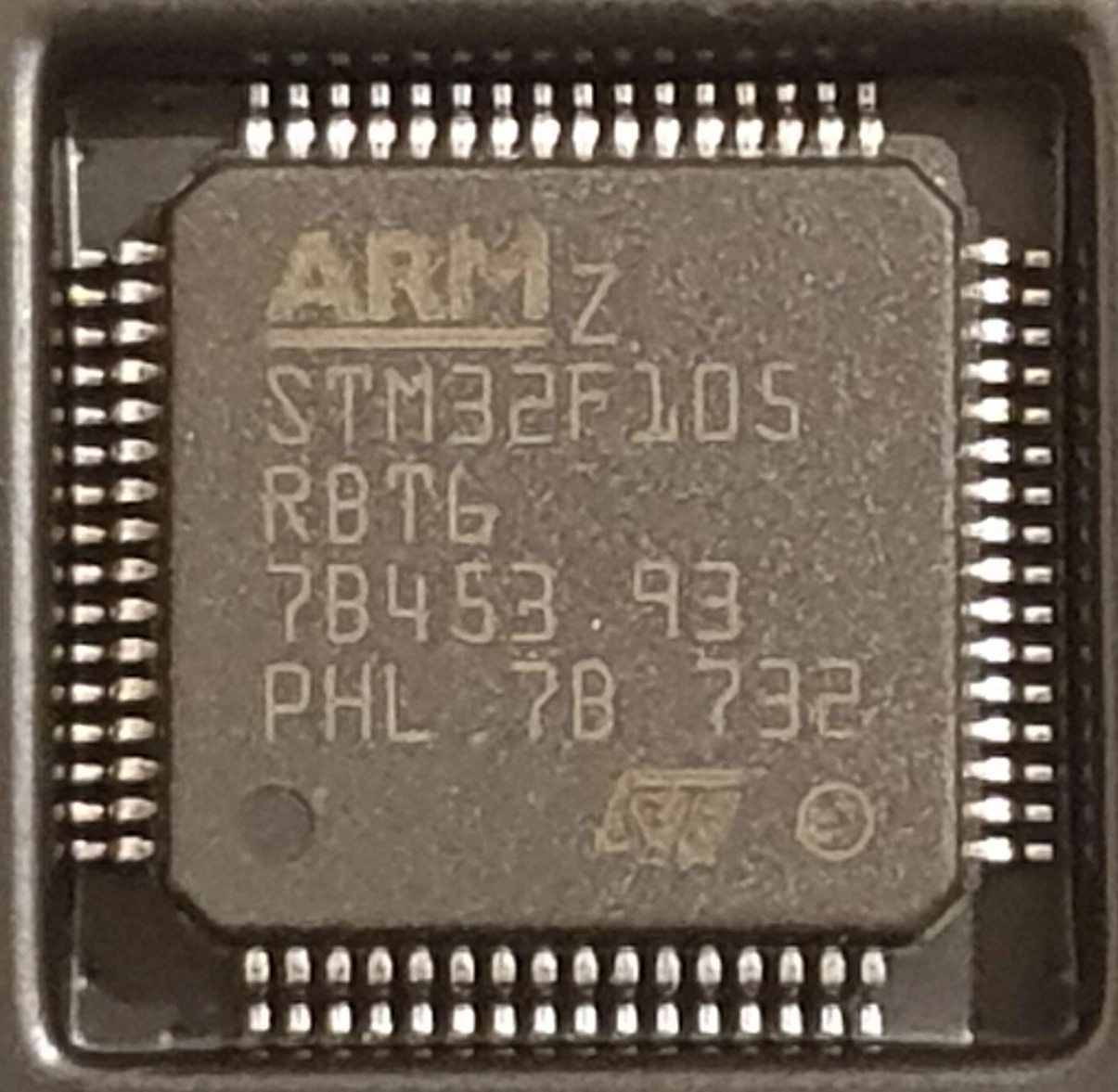

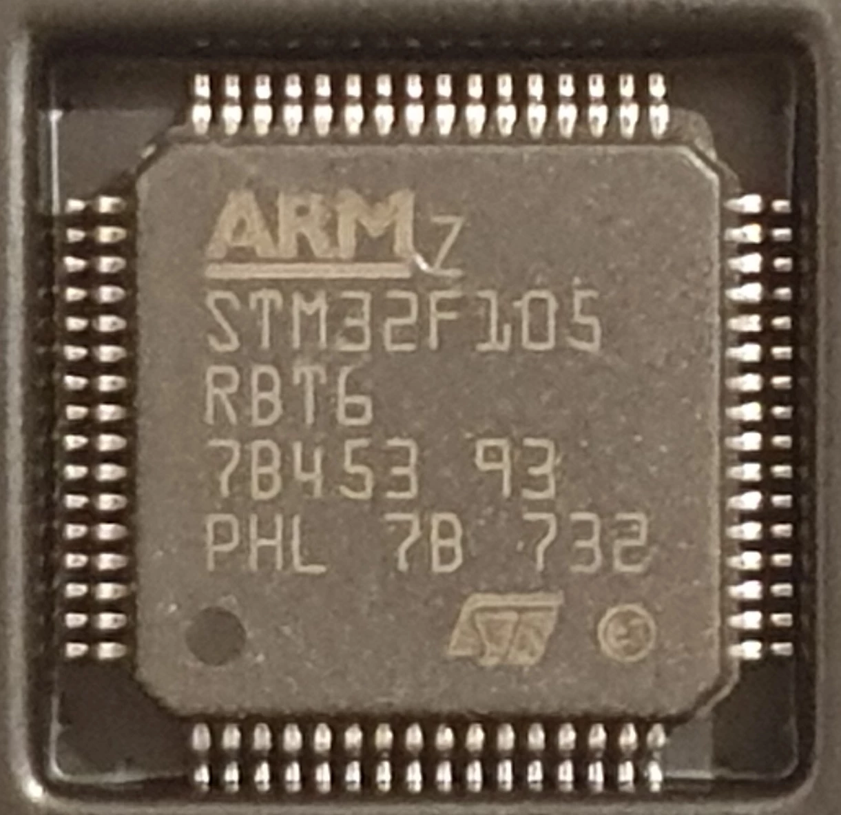

BODYPRINT
Visitor II
Feb 17, 2022 6:40 AM UTC
Hey guys,
I didn't want to create another Fake thread so I hope you don't mind me hijacking this one.
I bought these 6 x STM32F105RBT6 off of ebay..
The add said "Genuine 100%". Probably my first mistake.
Looking at the printing I'm thinking they are fake and would rather not solder them to the boards at this point.
I thought I'd get you guys with more experience to have a look and tell me if you think these are fake as well thanks.
Any help is appreciated.
Thanks :)
