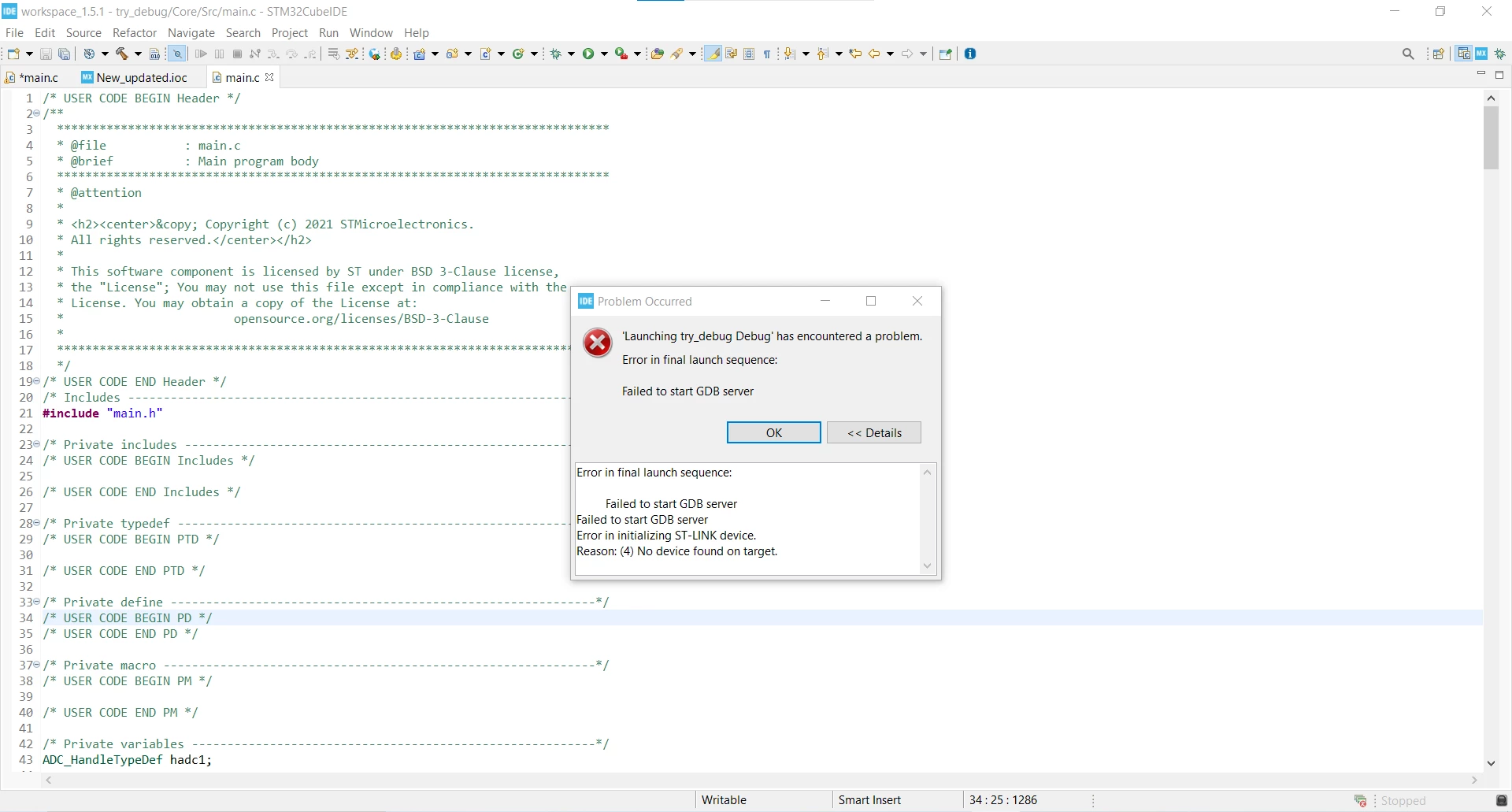

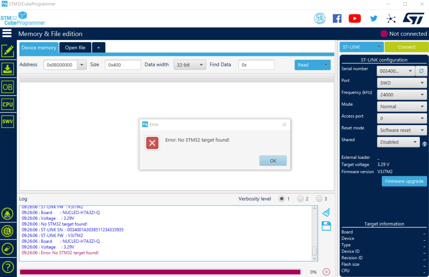

How to solve the problem with: 1. " Error: No STM32 target found!". 2. "Error in final launch sequence: Failed to start GDB server Failed to start GDB server Error in initializing ST-LINK device. Reason: (4) No device found on target."
--The first error encounters while trying to connect the board (STM32H7A3ZI-Q) with STM32Cube Programmer at normal mode.
--The second error encounters while trying to upload a code through STM32Cube IDE.

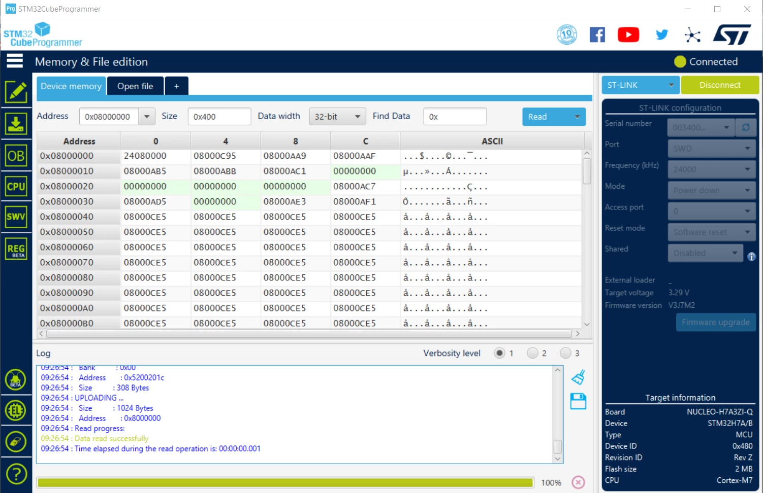

However, when I try to connect the board with STM32Cube Programmer at power down mode, it successfully connect .
Hence, being a naïve in this area, I hope everyone helps me out to find the solutions. Thank you.0693W00000D0ZRiQAN.png0693W00000D0ZRYQA3.png0693W00000D0ZRTQA3.png

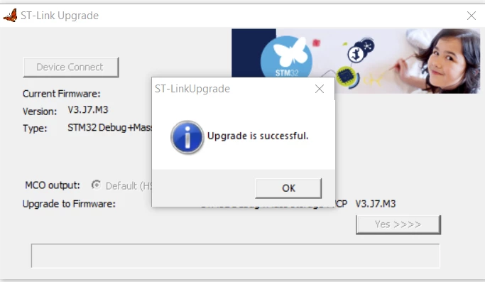

Hello @PWaiba​ and welcome to the Community,
Your STLink firmware version is an old version.
So, please try to upgrate your STLink firmware. Then keep me informed about your update.
When your issue is sloved, please close this topic by choosing Select as Best. This will help other users find that answer faster.
Imen
PWaiba
PWaibaAuthor
Jul 30, 2021 3:32 AM UTC
0693W00000D0ZRiQAN.png0693W00000D13ffQAB.pngAlthough the upgrade is successful, the error still encounters while uploading the code as cited in the picture.

PWaiba
PWaibaAuthor
Jul 30, 2021 3:58 AM UTC
I followed the link and found that the issue was with my power configuration. By following the steps there, my issue is solved. Thank you @Community member​ .
