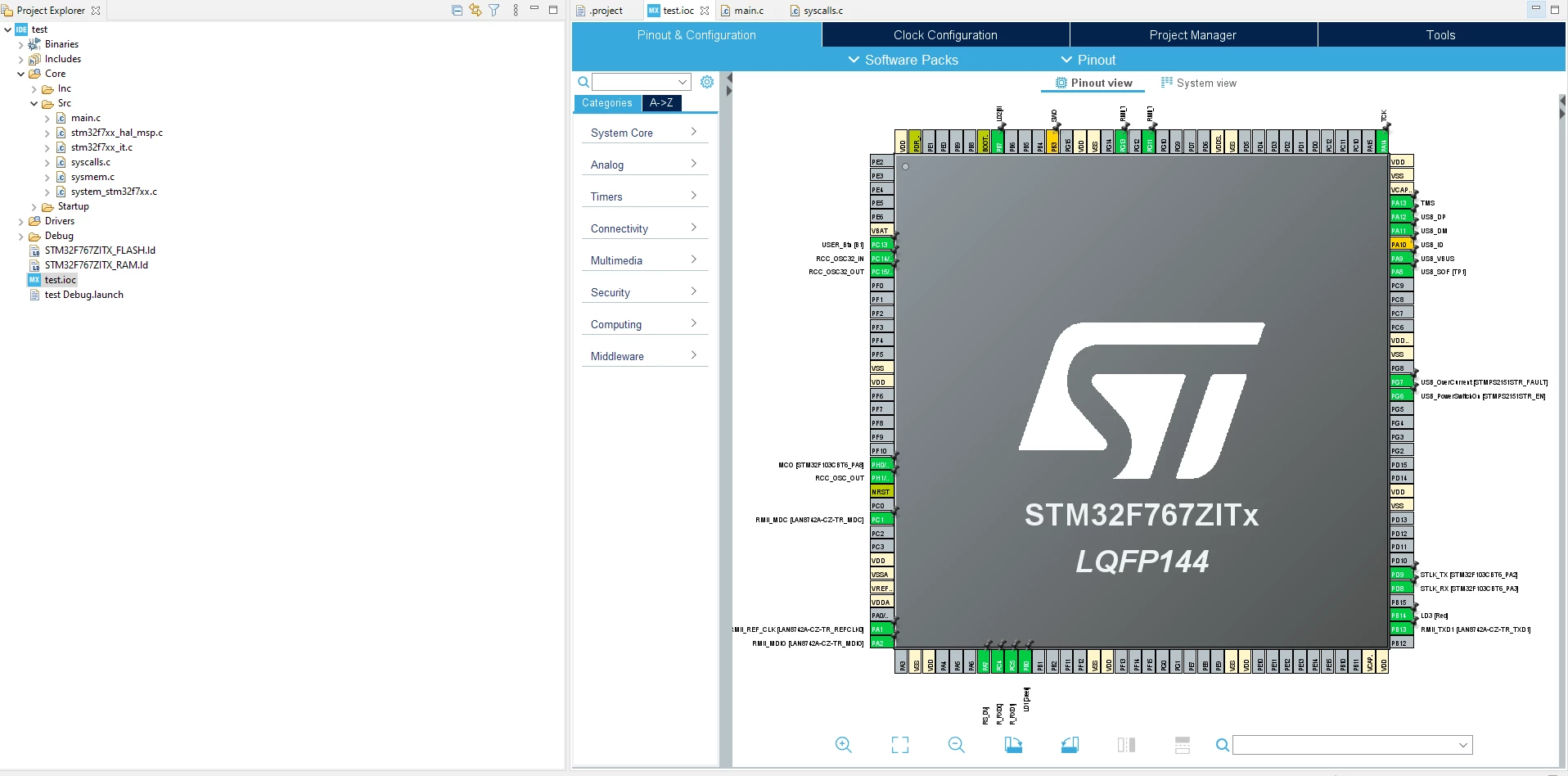

Hello. I have STM32F767ZI nucleo board. I have created a new project and used default setup for the nucleo board. It have automatically set up some peripherals for me

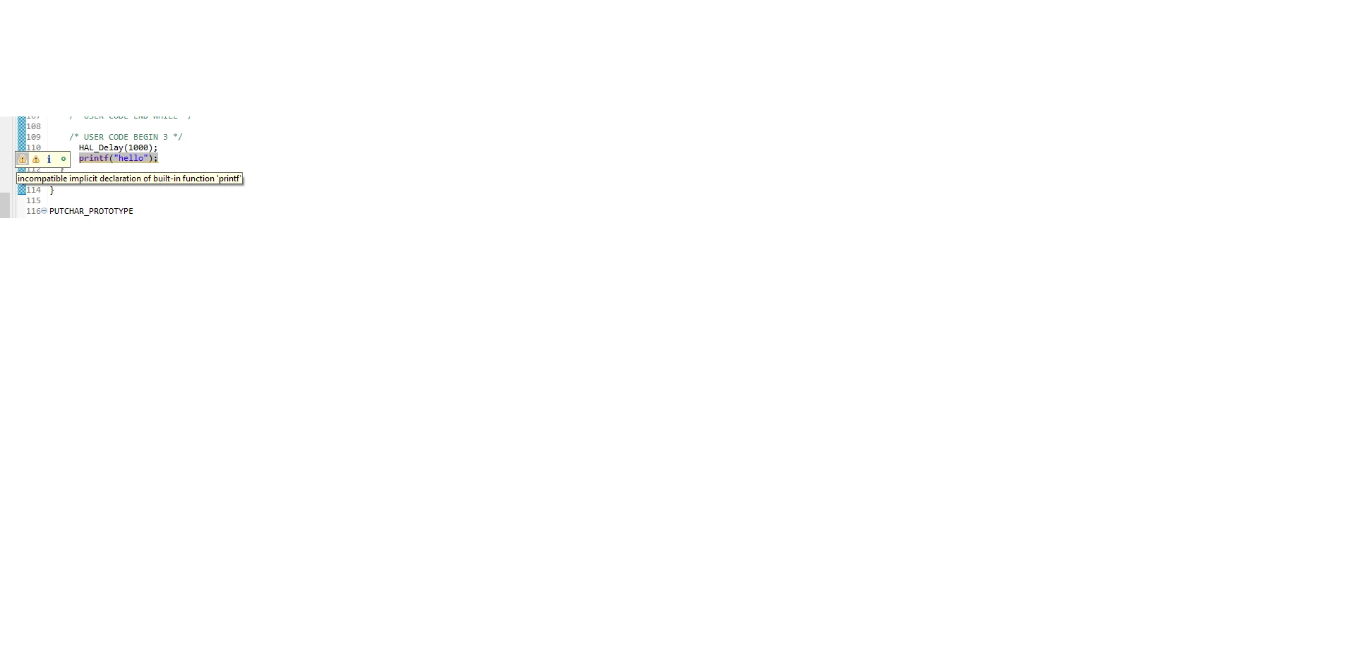

 Also, might be worth to mention that I have got a warning message under the printf:
In syscalls.c I have placed breakpoints on functions _write and _read. None of these functions are invoked after calling printf. I am not sure whethet thats the expected behaviour. Also, I have placed a breakpoints in HAL_UART_Transmit function and it never gets called either

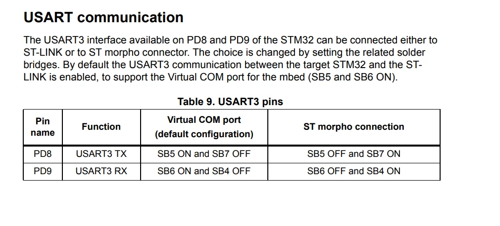

Graduate II
June 7, 2024
Including the \n\r in the printf string worked for me on a NUCLEO-H753ZI. Another tricky thing was that my Nucleo board arrived with the solder bridges configured for using LPUART1 outputting to Arduino pins D0/D1 despite the documentation indicating the default configuration is USART3 outputting to the STLink virutal com port.

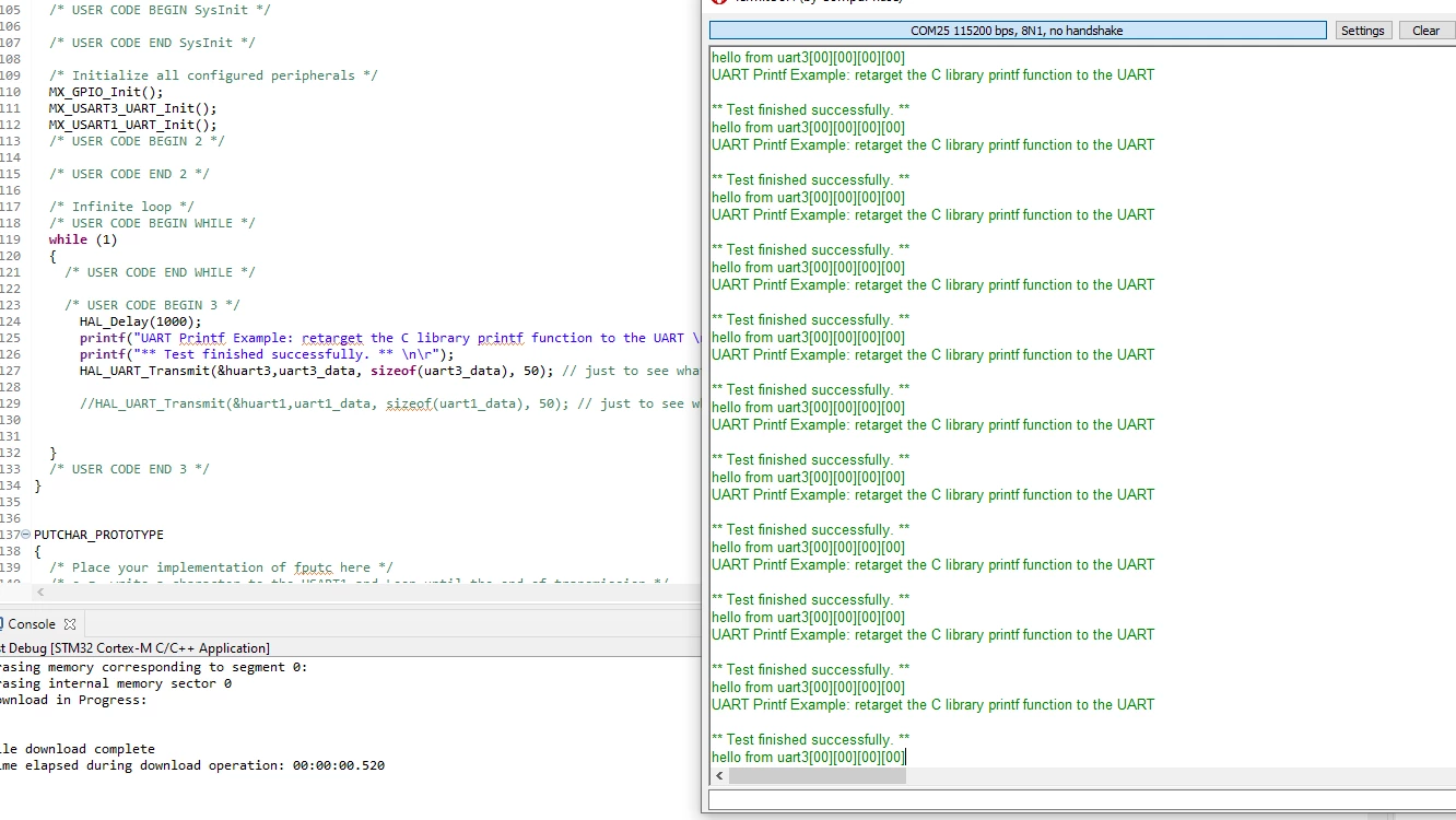

I have been examinating it further and tested UART using terminal "termite".. From the datasheet I have found out something about usart3:
0693W000006HqMbQAK.pngAnd I am able to see the usart messages on the terminal
I am not sure whether thats a good sign or not, but I am still not able to see any messages on the debugging console window on the cubeIDE.

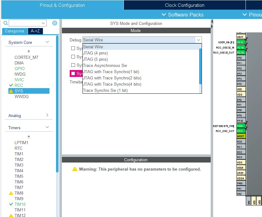

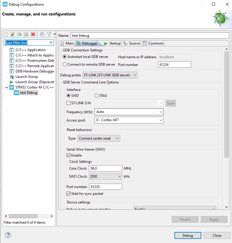

Further update on my printf research (Still not able to print to console)
I have read this discussion:
https://electronics.stackexchange.com/questions/445815/stm32-swd-printf-not-working
And I have tried what they have suggested:
  1. Enabling the tracing and setting the sysclk frequency
However, still no luck doing printf to the console.
Also, I would like to ask whether there is a difference which debugging option I chose?:

Christophe VRIGNAUD
January 20, 2022
The debug printf is one of the functionality of the Serial Wire Viewer.
An article exists on this topic: How to redirect the printf function to a UART for debug messages
https://community.st.com/s/article/how-to-redirect-the-printf-function-to-a-uart-for-debug-messages
Videos are also available covering the SWV functionalities:
STM32CubeIDE Advanced Debug Features: Part1 to Part5
https://www.youtube.com/watch?v=4wT9NhlcWP4&list=PL7tUZeMaichqrlJN4PGu3-n6DbYrvoG-s
